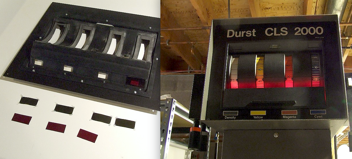

I replaced to olive (for color paper) filters over the indicator lights in my Durst with Rosco #27 RED for B&W work. Not that it is the best "RED" but it is what I had laying around and it is safe.
