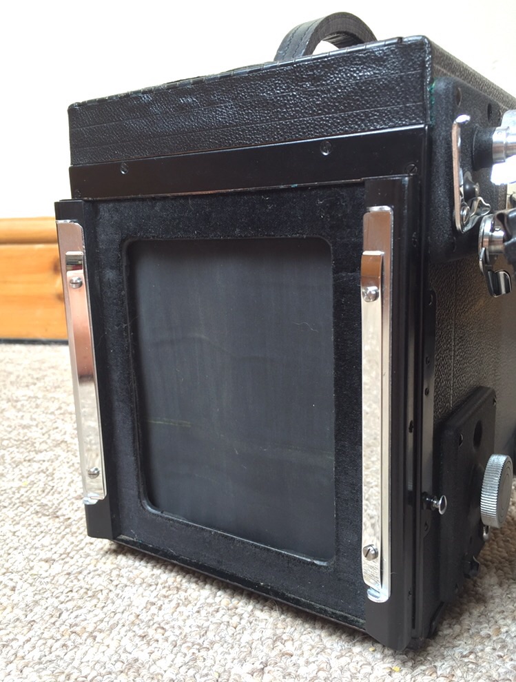

Hi all,
Quick question. I have recently acquired a few boxes of Fuji FP100C45 (4x5) from a friend of mine who no longer wanted to store it and I basically need to know what film holder will enable me to use the film with my Graflex Super D. I've attached an image just showing the rear of the camera where film holders get attached. I've not had any experience with Polaroids in large format but as I've got this rare film now I'm willing to make it work! Thank you for your help in advance!

There is no Polaroid holder that fits the Graflex back that is on your camera.
You can make an adapter that will hold a 545 or 545i Polaroid film holder and mount on your camera's back but the view ground glass will have to be adjusted to match the film position.

If you upgrade to a graflok back (a good idea regardless, in my opinion, and I did so on my super ds), the fuji PA-45 back or the polaroid 550 back will fit fine.

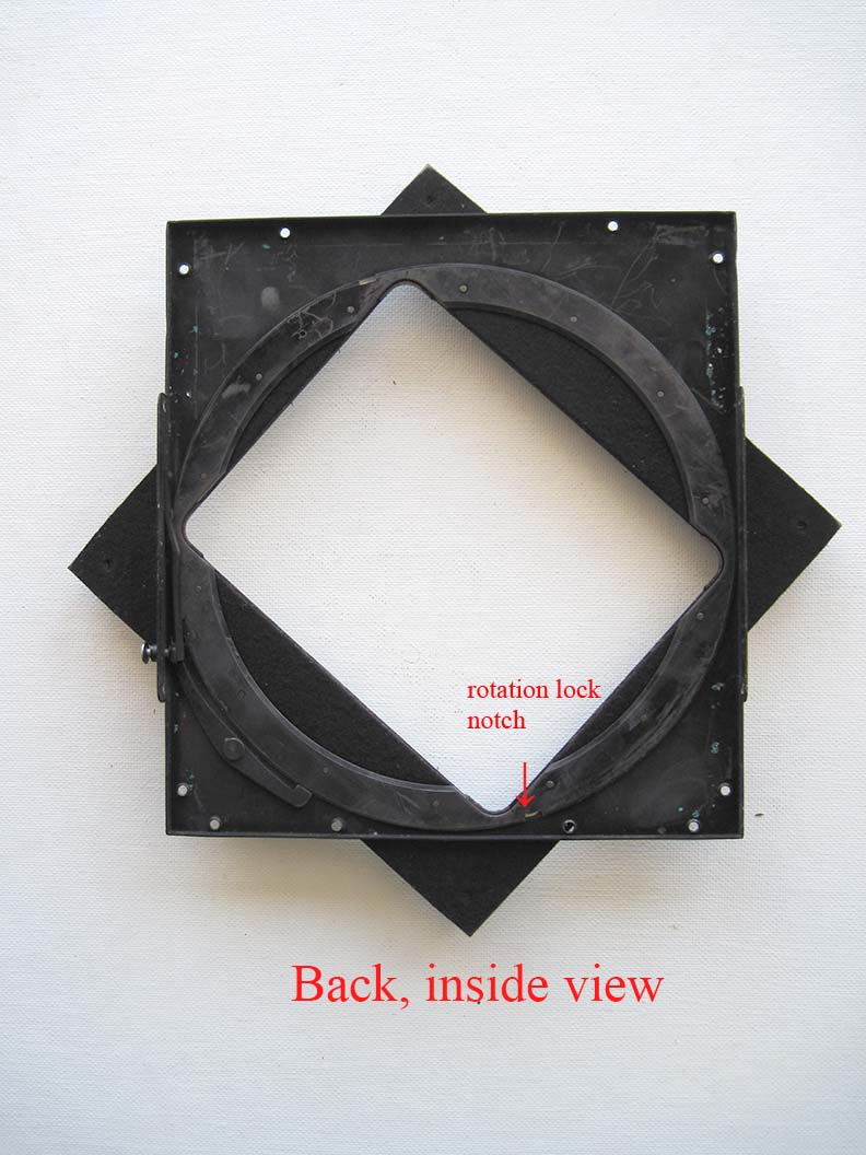

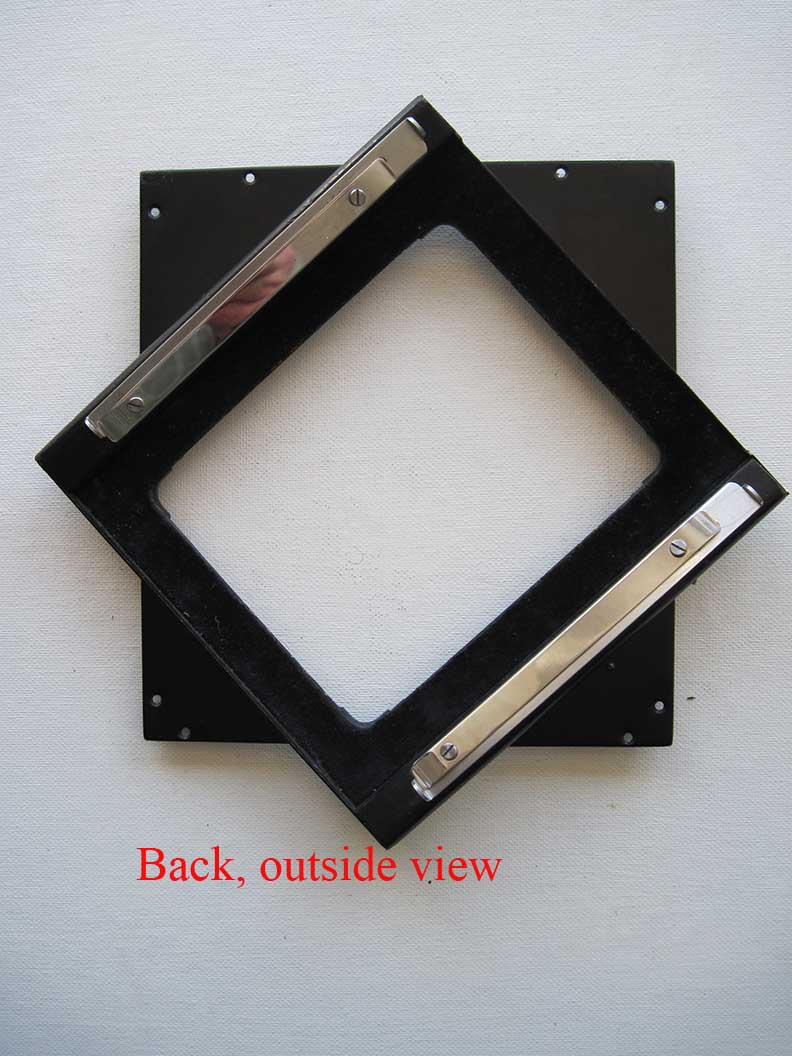

On a 4x5 SLR the back is held on by 12 screws, 4 oval head - 2 each side, and 8 flat head - 4 top and 4 bottom, of the holder side. The back must be rotated part way between Portrait and landscape to access them. Once off the camera there are two screws, oval head, top and bottom of the wood blocks the slider(s) are mounted to and 4 flat head screws accessible from the back side of the front rotating frame, the felt may hide them but there should be small holes for them. Replacement blocks that are wider can be installed so that standard film holders fit but there is still that lip that has to be dealt with.

When I converted my SuperDs to Graflok I used the magnesium back from a speed/crown graphic. I cut it down to size with a carbide-blade 12" dewalt chop saw. I then bolted/glued it into the brass rotating frame that previously formed the frame of the Graflex back. I removed the graflex blocks/sliders/felt but kept the rotating brass frame it sits in. It works great, the registration distance matches basically exactly, I didn't need to shim the ground glass at all as I recall.
