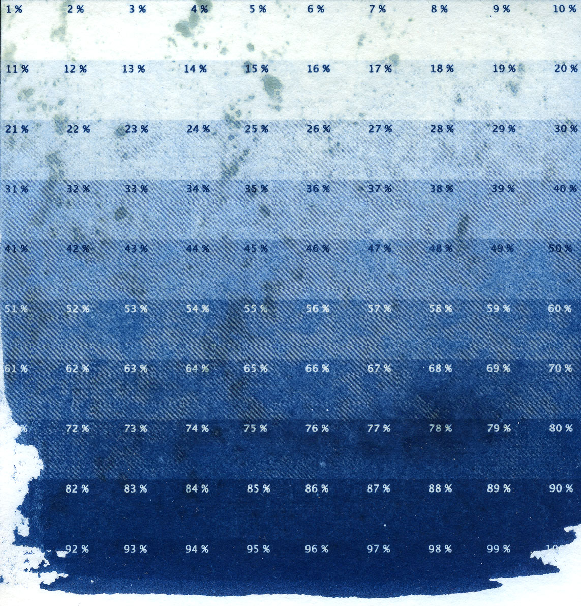

Last week I got good result with Schut Terschelling hot pressed paper and New Cyanotype.
Today I got speckles, terrible !
It makes me crazy. Is this paper is not consistent? I did all the same as last week. Each mL sensitizer 1 drop wetting agent + 1 drop citric acid. Coat with glass rod, dry 15 min in an box with soft warm wind blowing. 100 seconds UV light an develop in 1% acetic acid
I have no idea what's to do. Did Pre-soak the paper 10 minutes in 5% hydrochloric acid (dry , flatten) no great solver. Should I try pre-soak with 40 m/v % citric acid ?
Any tips. Please look at attachment for kind of speckles
I use as wetting agent Agfa Agepon. Is this OK , or should i use Tween ? (find reseller for that stuff) I've also a bottle Rollei RWA here, but not tried yet.

Did small test today. Measure pH of Agfa Agepon wetting agent. Wow it's pH 9. That's not fine.
Also check Rollei RWA wetting agent, that's better pH is 6 !
So I store old Agfa stuff for other use and use Rollei for cyanotype.
Small test with 3 small pieces of paper: improvement less pronounced speckles (but not complete gone) with Rollei RWA and fast circa three times movement of the chemicals with a rod on a paper.
Longer move the rod over the paper is no good seems.
