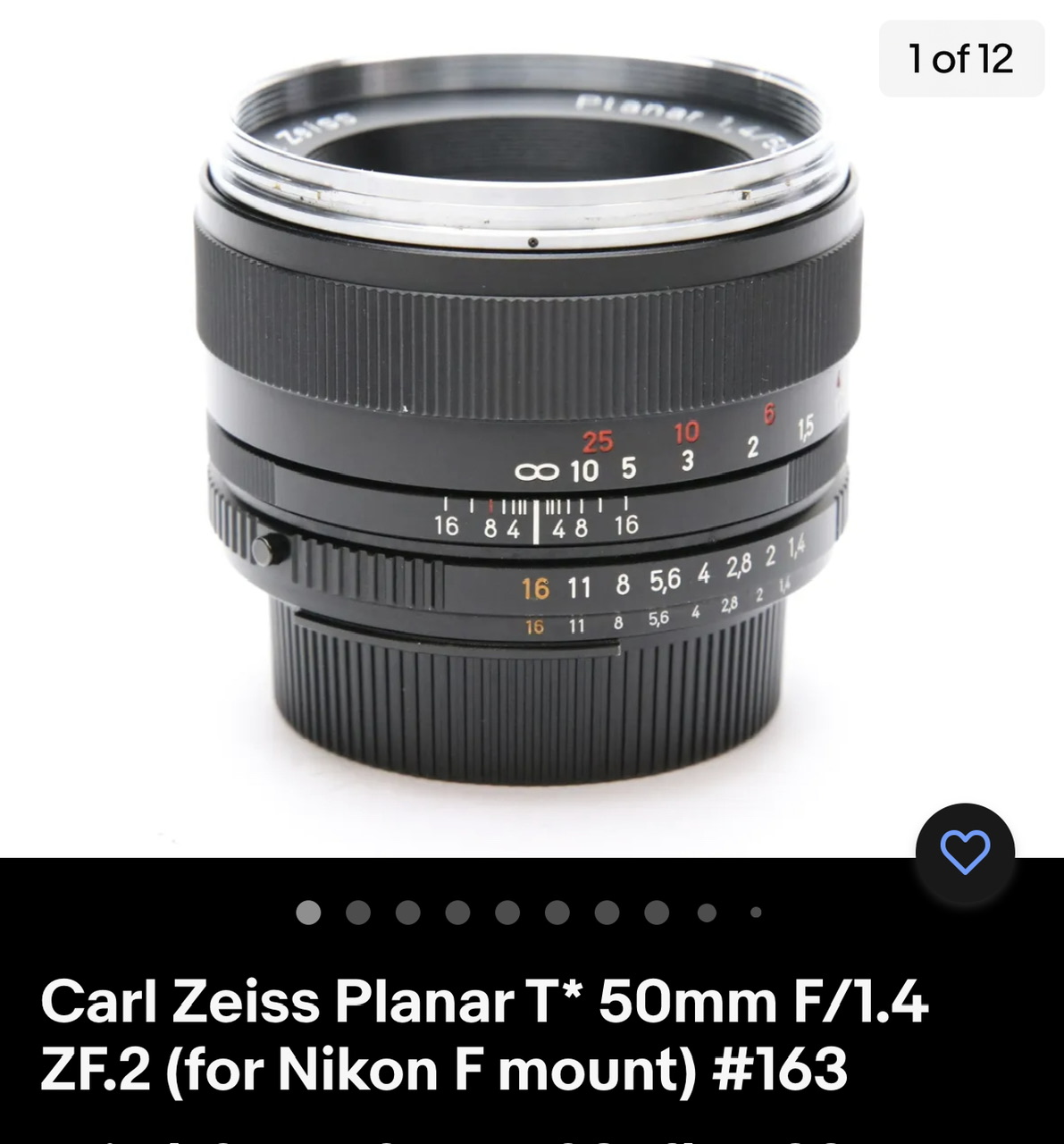

Can other Zeiss or Leica lenses be used with a Nikon F2…?
Not if you want to be able to focus at infinity. For macro work, yes.

The Nikon F mount has a film-to-flange distance of 46.5mm. In order to focus to infinity on a Nikon F camera, the adapted lens needs a film-to-flange distance that is greater than 46.5mm, plus some thickness for the adapter, so that its film-to-flange distance can be maintained. There are very few 35mm film camera lenses that meet that requirement (see https://www.graphics.cornell.edu/~westin/misc/mounts-by-register.html for a chart listing film-to-flange distances). Probably the most common lenses that will work are T2 mount lenses, many of which will have lower image quality than Nikkor lenses, but YMMV.
