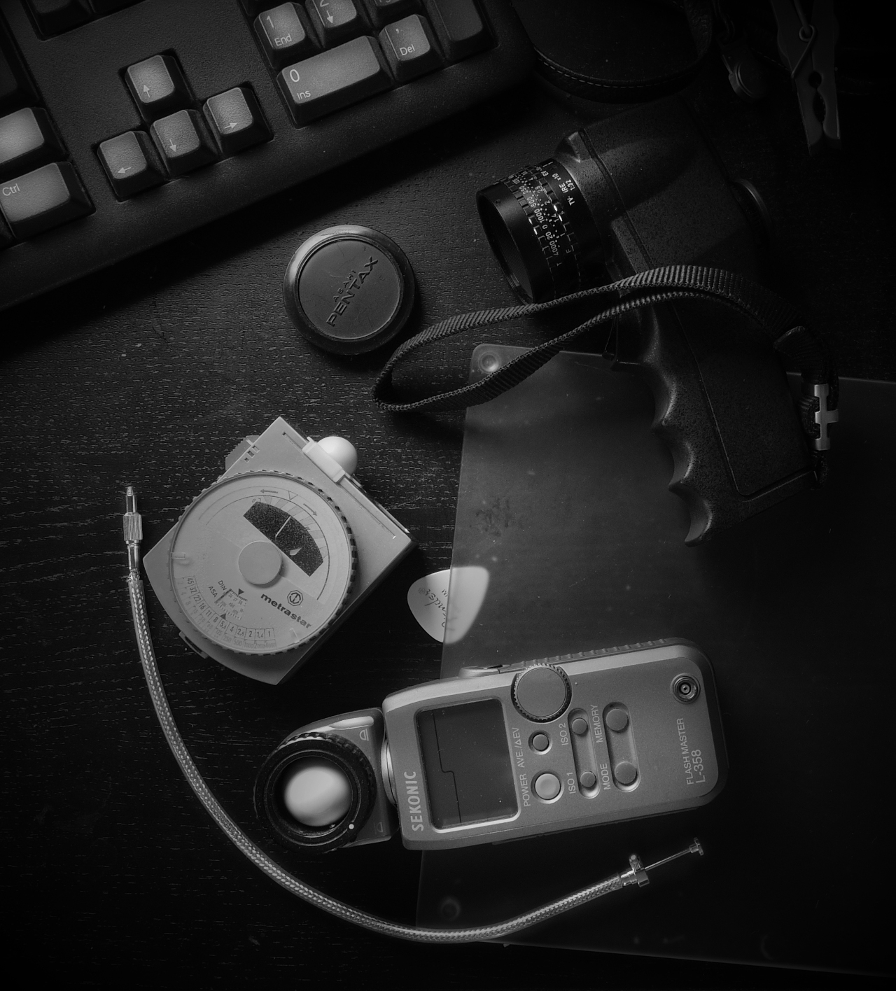

I use a Pentax 1 degree digital spot meter, a seconik l-358 and an old Metrawatt Metrastar, and sometimes the built-in meter if there is one :smile:
The spotmeter is mostly used with large format, or in somewhat difficult conditions. The old Metrastar is from 1961 and followed an old Bronica S that I was given a some years back (2009?), and I have used it since then as a primary meter until last year. I was very surprised to notice that the metrastar uses PX625 batteries but functions perfectly with regular PX625A at 1.5v!! It will remain my backup for a long time as it is very nice to use and can take readings in lower light than the seconik.
