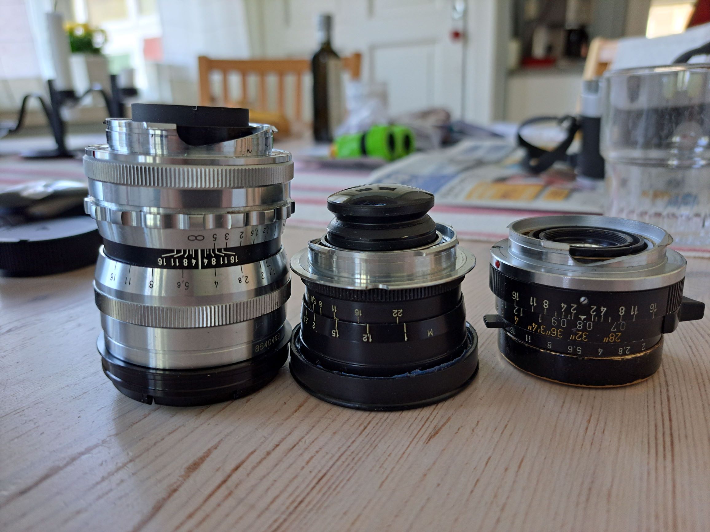

There is a lot of variation even in RF lenses due to lens design. These are all 35 mm lenses I have used on a Leica M. The Voigtländer 1.7 on the left is so long I stopped using it because it blocks part of the finder. I started with the Jupiter 12 in the middle, but now use the Summicron on the right.
