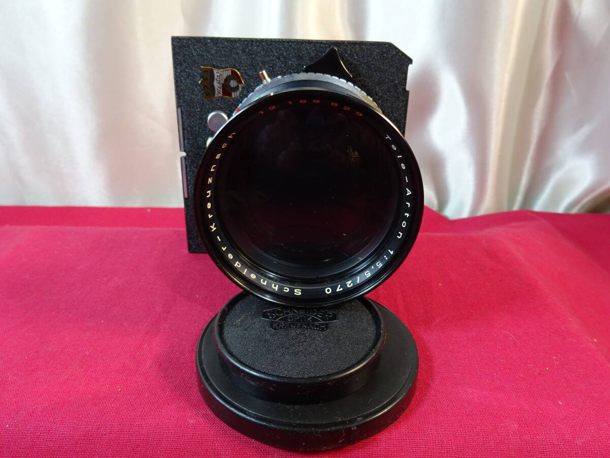

The 270mm tele arton i found is this one:

So it evidently exists! I'm not familiar with it, but if it performs anything like the 360 I have, I wouldn't recommend it. And if the design is similar to the 250 I found the specs of, the coverage will barely be sufficient for 4x5", which would make me hesitate as well.

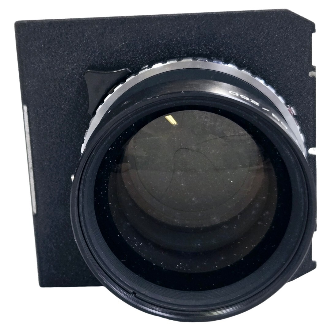

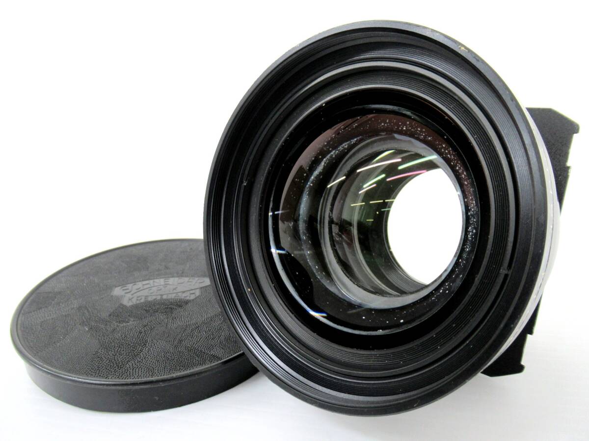

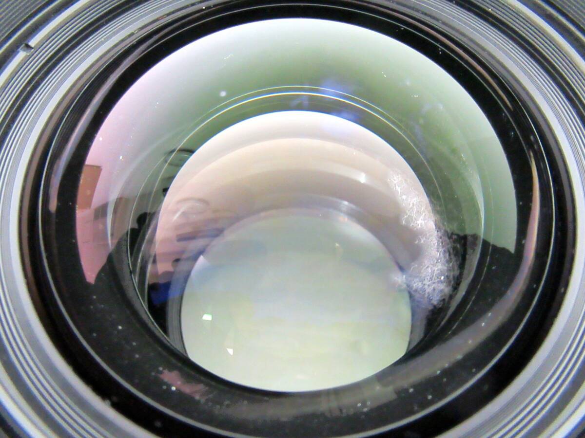

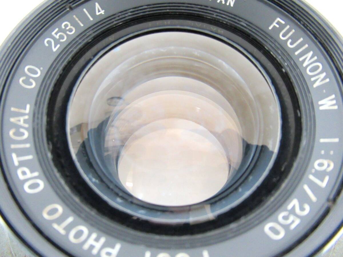

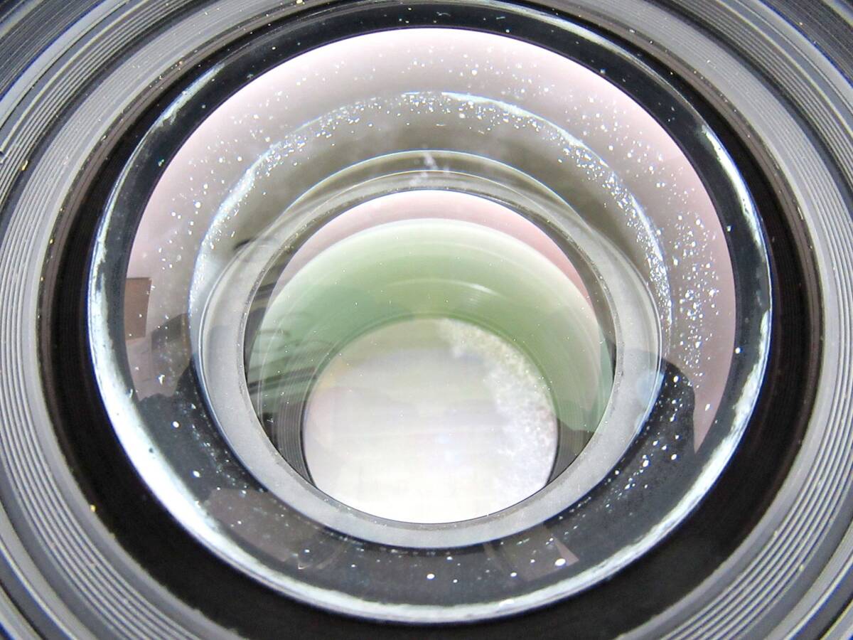

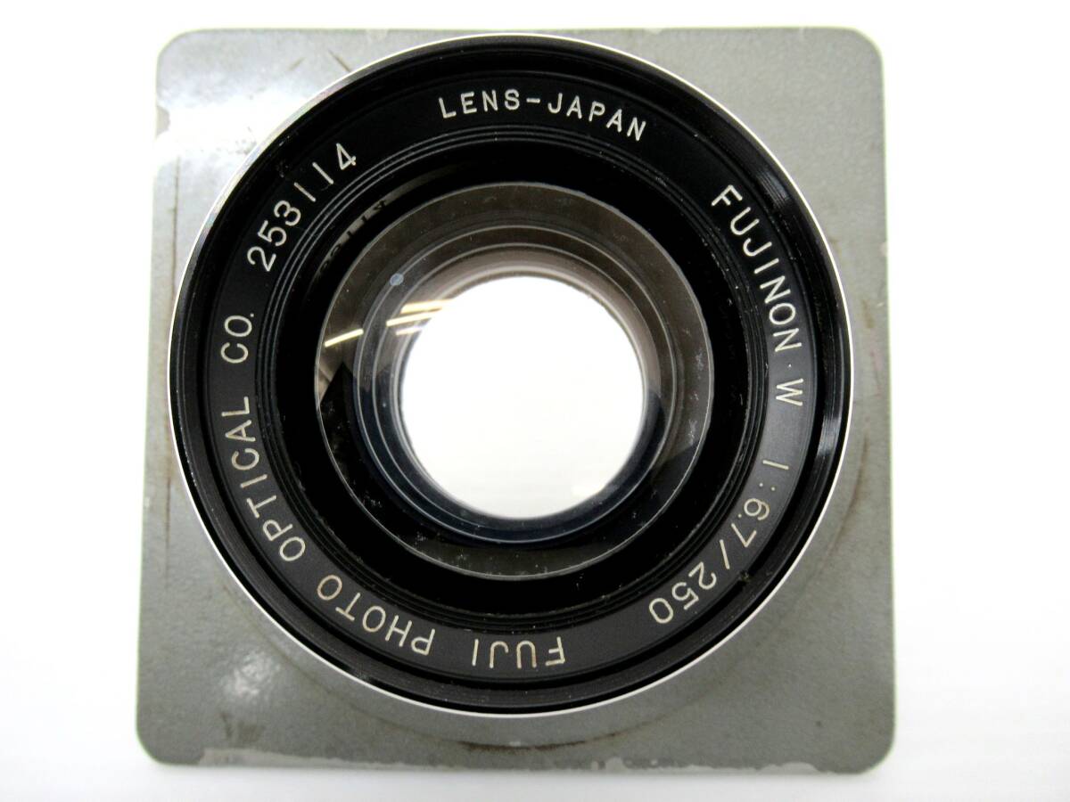

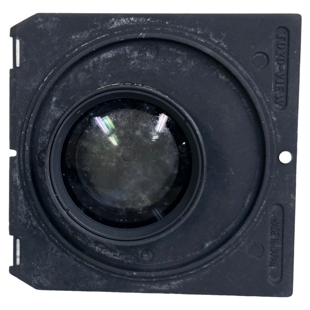

FUJINON W 1:6.7/250mm, a bit rough looking, though it looks like it is only haze and schneideritis (picture attached). AND, I have to win the auction…
And then there are 2 more lenses with fungus, one for 100$ (FUJINON W 250mm f6.3) and a Symmar-S 5.6/300mm MC that is for auction, but not many people is following the publication.

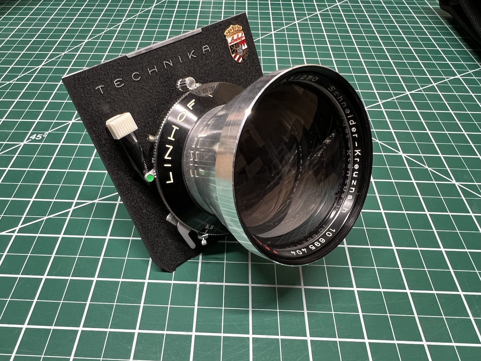

The 270mm f5.5 Tele-Arton certainly exists - I have one! Actually, I like it. For most situations I much prefer my 300mm lens, but specifically for portraiture the Tele-Arton is quite nice. The synchro-compur aperture has 10 blades and is nicely rounded. I have not tried any other copies and I don't know anyone else with one - my experience is limited to a sample size of one. I've also never tried any of the other Tele-Arton lenses. Considering that you have limited bellows draw I don't see anything wrong with trying one out if you have the opportunity. Photo attached for reference, it's FP4.
It does have drawbacks. It's big and heavy compared to a symmetrical lens design, the shutter is old and may need work, and you will not get modern optical performance. The image circle is 178mm at infinity. Since you mentioned versatility, I would not call this a versatile lens. I also wouldn't call it a specialist lens - it's a compromise lens. I don't mind the compromises, but it's not part of my regular usage either.
