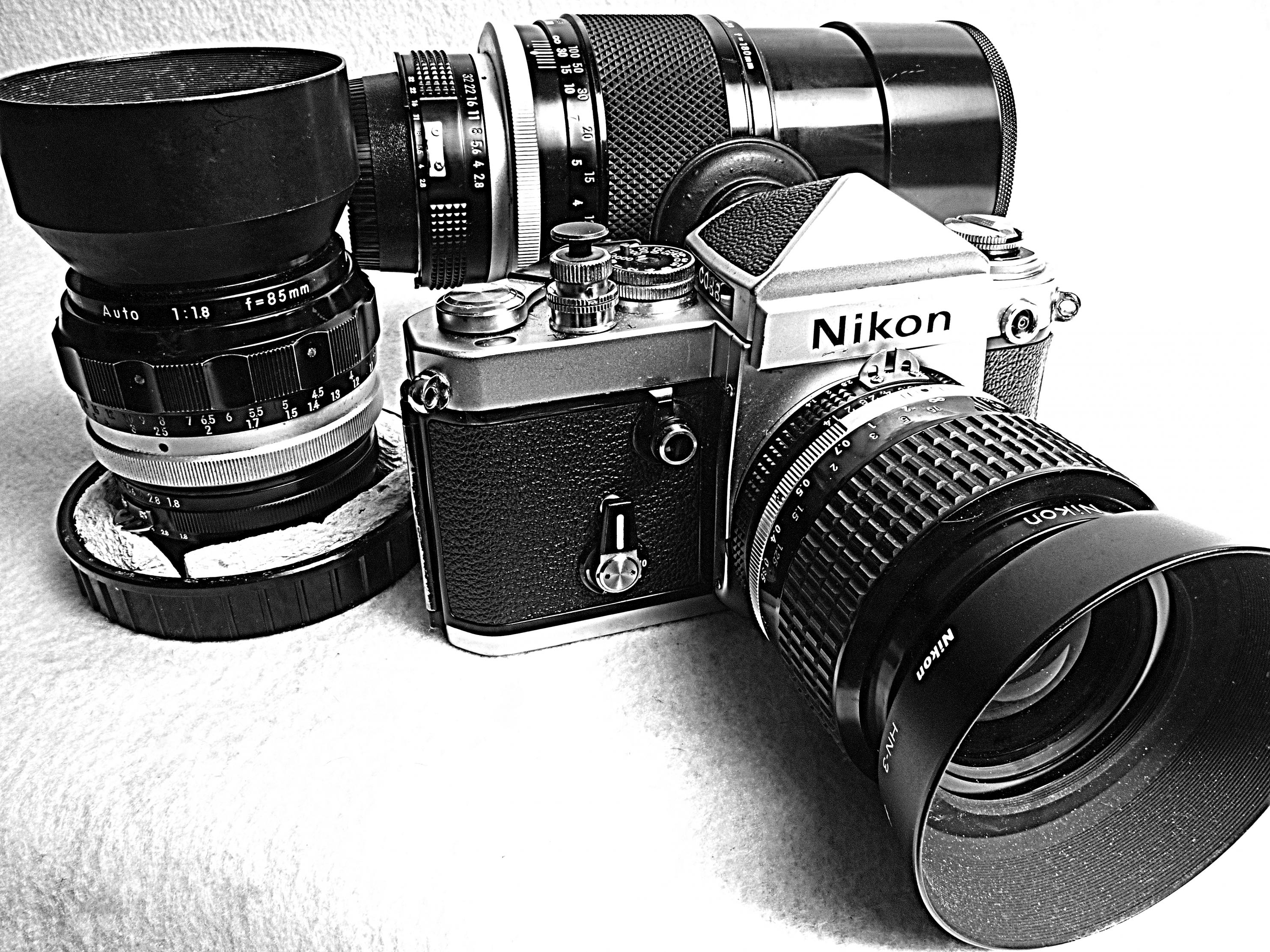

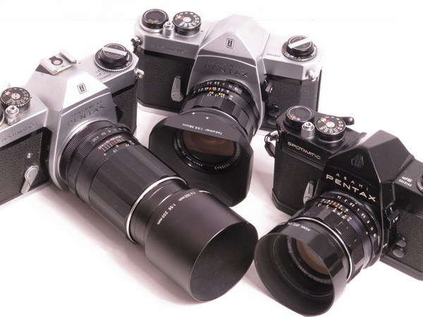

... I think I'll go 20 - 28 - 50 - 105. I might drop the 20 ...
I could easily go with the 28 – 50 – 105.
In my case, they would be the:
28mm f/2.8
50mm f/1.4
105mm f/2.5
If I knew I would be shooting macro in addition to portraits, I would take a 105mm f/2.8 macro instead of the 105mm f/2.5.
If I knew I would need something a little longer than the 105mm, I would take a 135mm f/3.5 instead.
http://www.flickr.com/photos/11336821@N00/6095358701/
