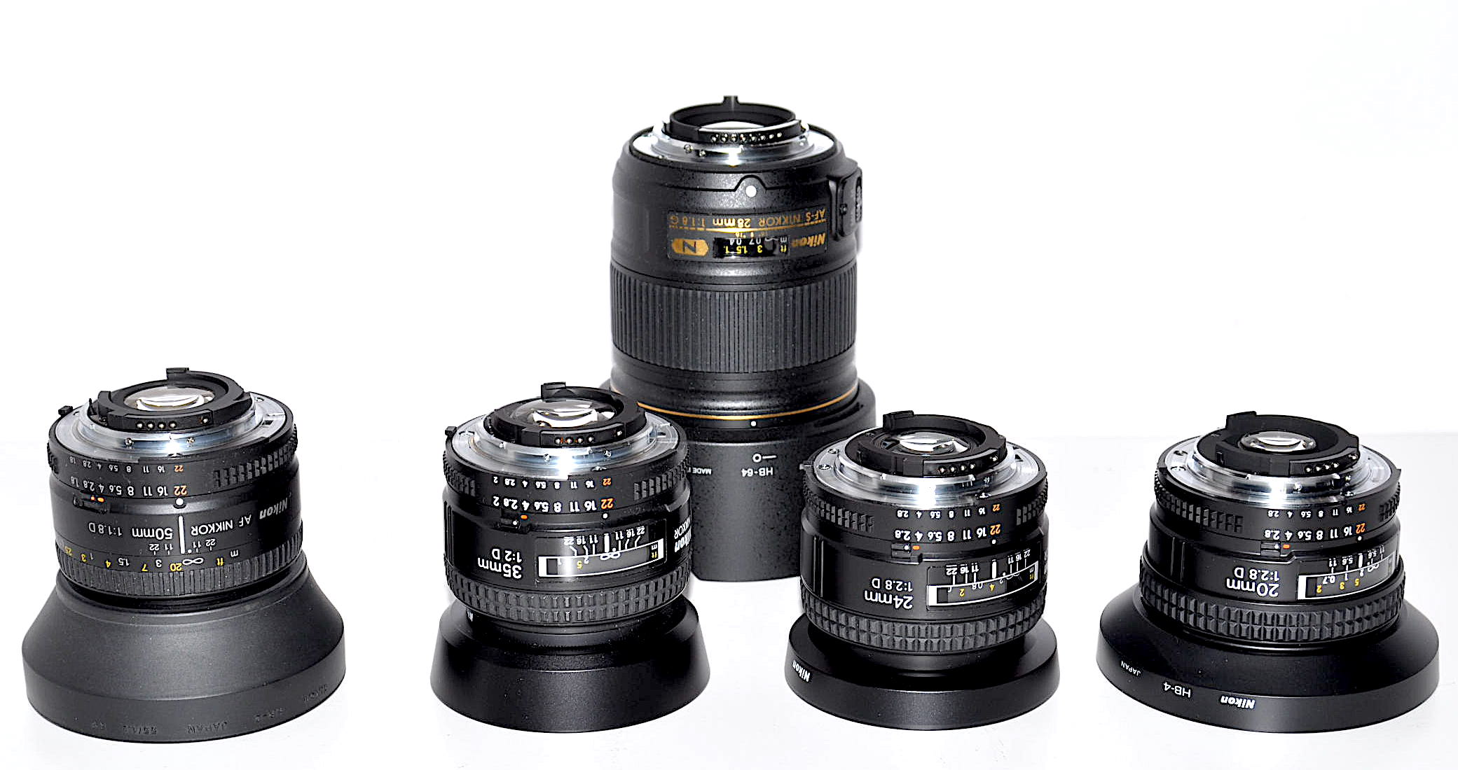

I'd recommend any or all of these compact AF-D lenses. Much smaller and lighter than the newer faster lenses lacking the aperture ring (seen in background).
