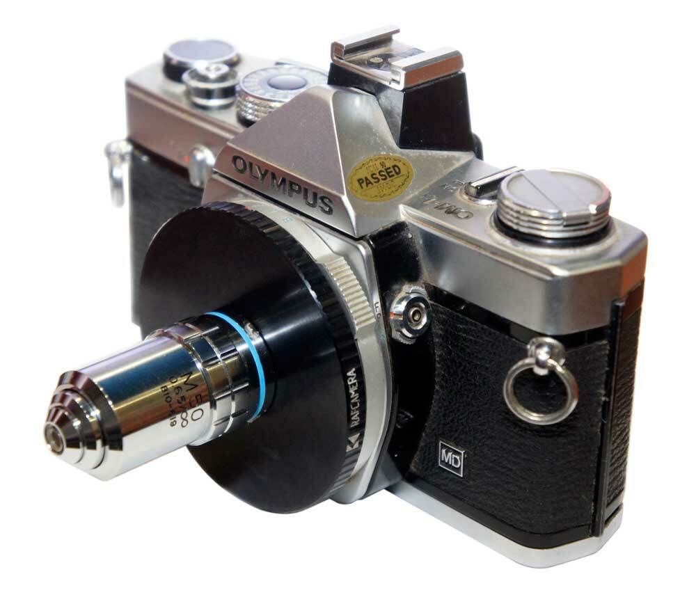

...regarding this thread, recently I got an OM system with several extras (autobellows, 3 flashes, a varimagni finder, a 50mm macro, a 2x teleconverter, some filters, etc.) and I was wondering what if you would adapt those cheap microscope lens such as Amscope 4x in a film camera. Guess it´s just a matter of printing an adapter to connect to the autobellows because you need 160mm at least of distance between the camera and the lens (if you need 4x of magnification) and obviously a ton of strobes. Certainly you can´t use the cable release here nevertheless I think this is not a big deal, is it?
Anyway this lens seems like a nice option (17 bucks) because the zuiko 20mm is a hole in your pocket nowadays. So, does anybody have tried this before?
Anyway this is lens is a nice option (17 bucks) because the zuiko 20mm is a hole in your pocket nowadays. So, does anybody have tried this before?
a quick reply to myself (I hope this would be it´s useful for somebody else) :

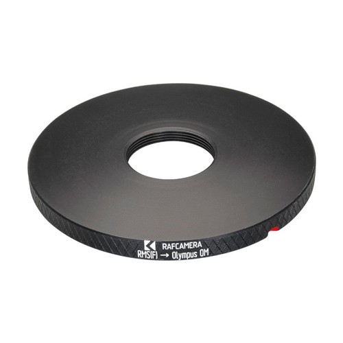

Given that the maxim magnifications just were possible with certain autobellows´s lenses (for instance, the first versions of manual zuiko 20mm/ 38mm) those are useless if you don´t get the Mount PM-MTob to convert it to the OM bayonet fitting. So in the case that I would decide to get a 300-700 bucks lens I was looking out there for this adapter and I hadn`t too much luck.
Nonetheless I figured out that someone is selling a similar item on Ebay, I mean, one side as RMS mount and the other side as OM mount, so I will try to get this.
On the other hand, the first version of those lenses were manual so the settings didn´t required the double cable release. In that way, if it works, you can get a 4x setting for less than 60 bucks.
You can get RMS to L39 adapter for about $10-20, and a L39 to ANYTHING adapter for even less. Pretty cheap. Save you $$$ for the lens.
