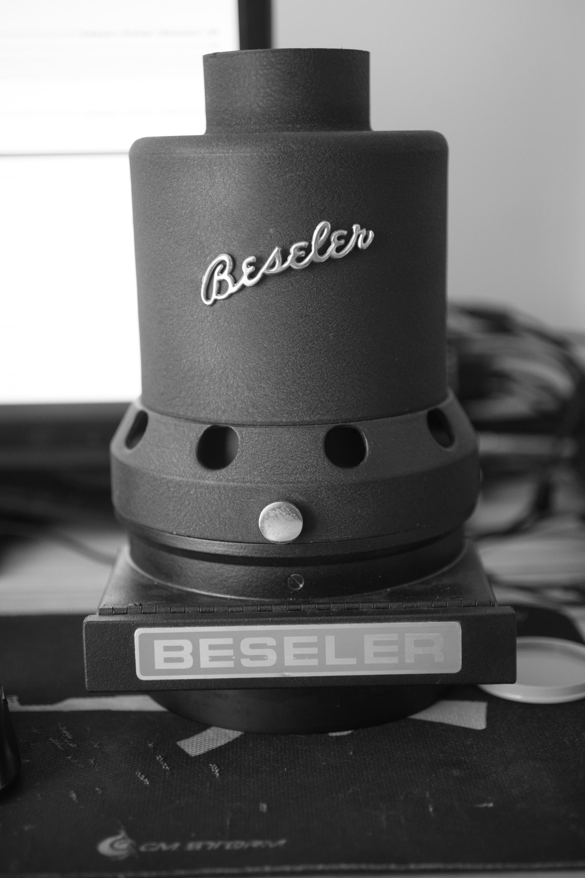

Hello APUG, In my black and white darkroom I am working with a Beseler 45M. I currently have three lenses on hand: 50mm, 75mm, 135mm. When I attempt to enlarge my 6x6 negatives to 16x20 with the 75mm lens, there is a strong vignette surrounding the image. No matter how I adjust the bellows, I cannot successfully print without a vignette across all four corners. If I use the 50mm, the vignette is worse. With the 135mm, I cannot enlarge a 6x6 to 16x20. What focal length lens do I need? Thank you - Lloyd

Lloyd, as others have mentioned, the condenser is probably the culprit here, and they can be a nightmare to deal with.
Try setting the condenser to the correct height, and using the 75mm lens and the 6x6 carrier, expose a sheet of paper to about a medium gray. You will most likely see unevenness in the print, often as much as 1/2 stop off in the corners.
If that's the case, I will try to post my super simple LED conversion technique.

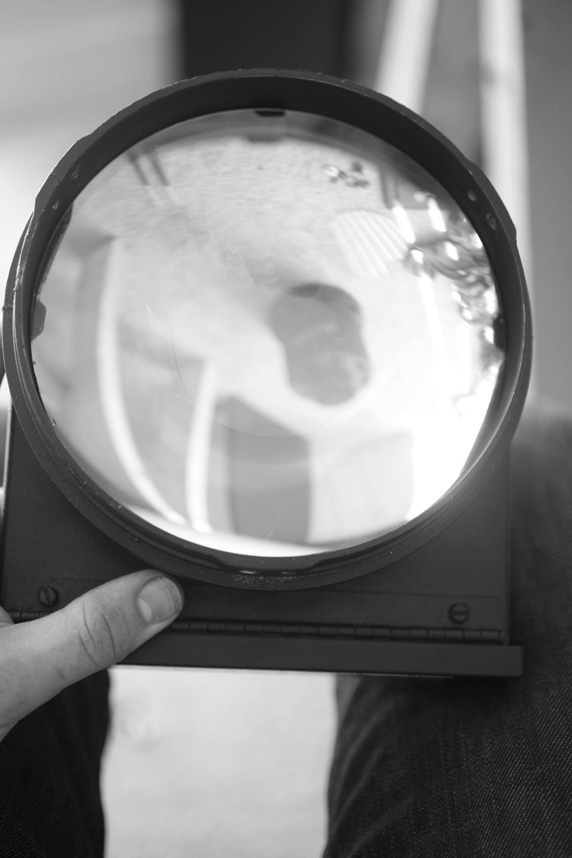

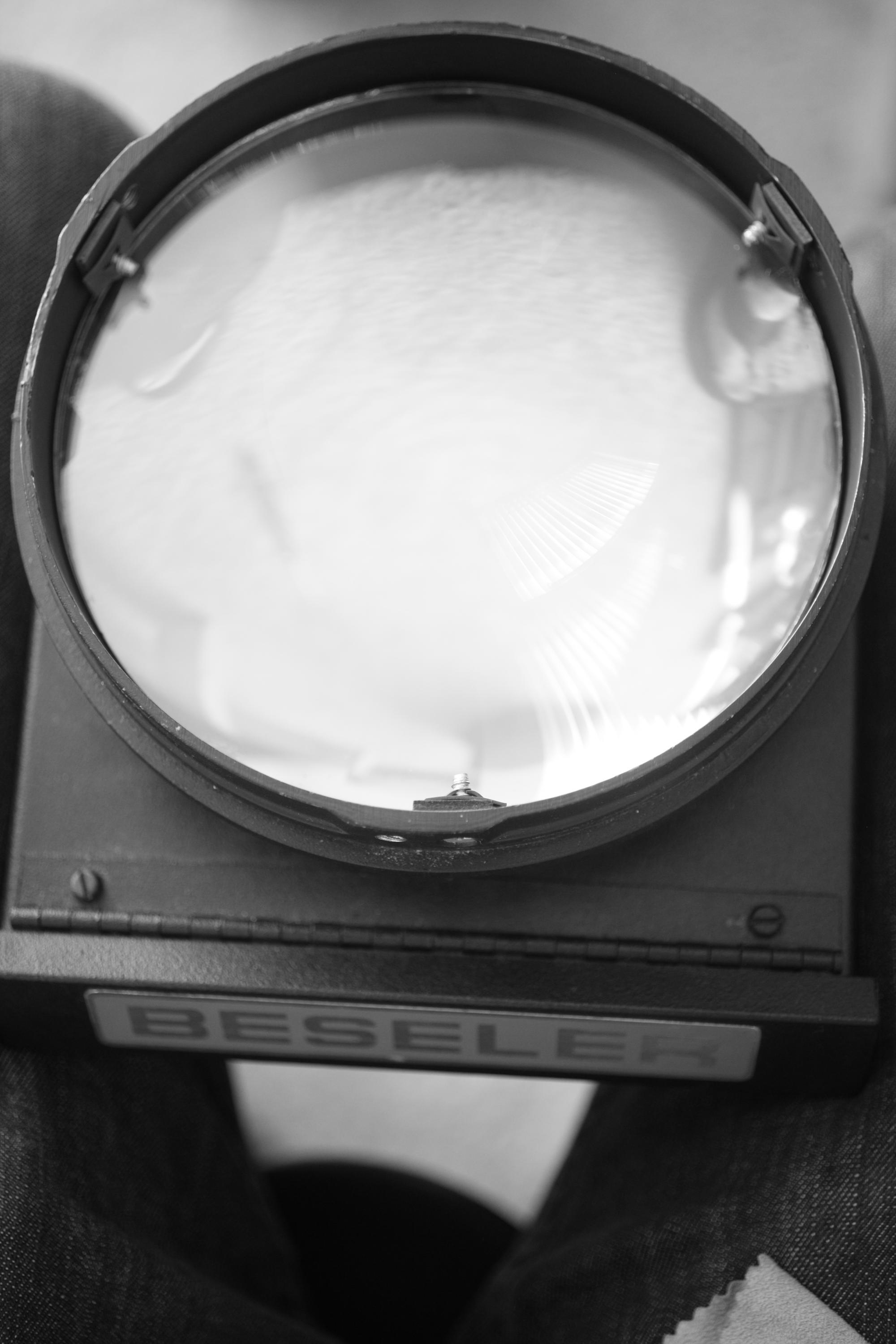

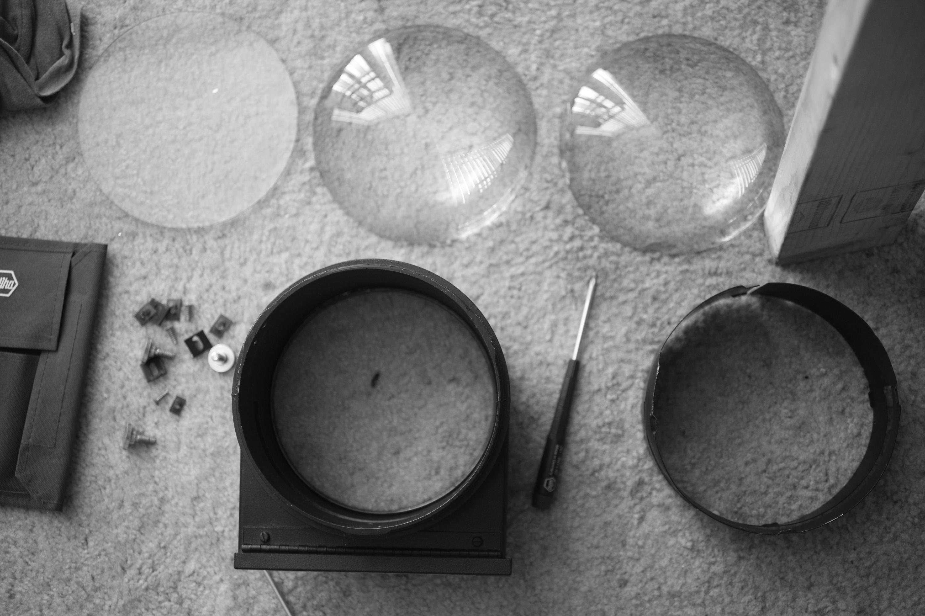

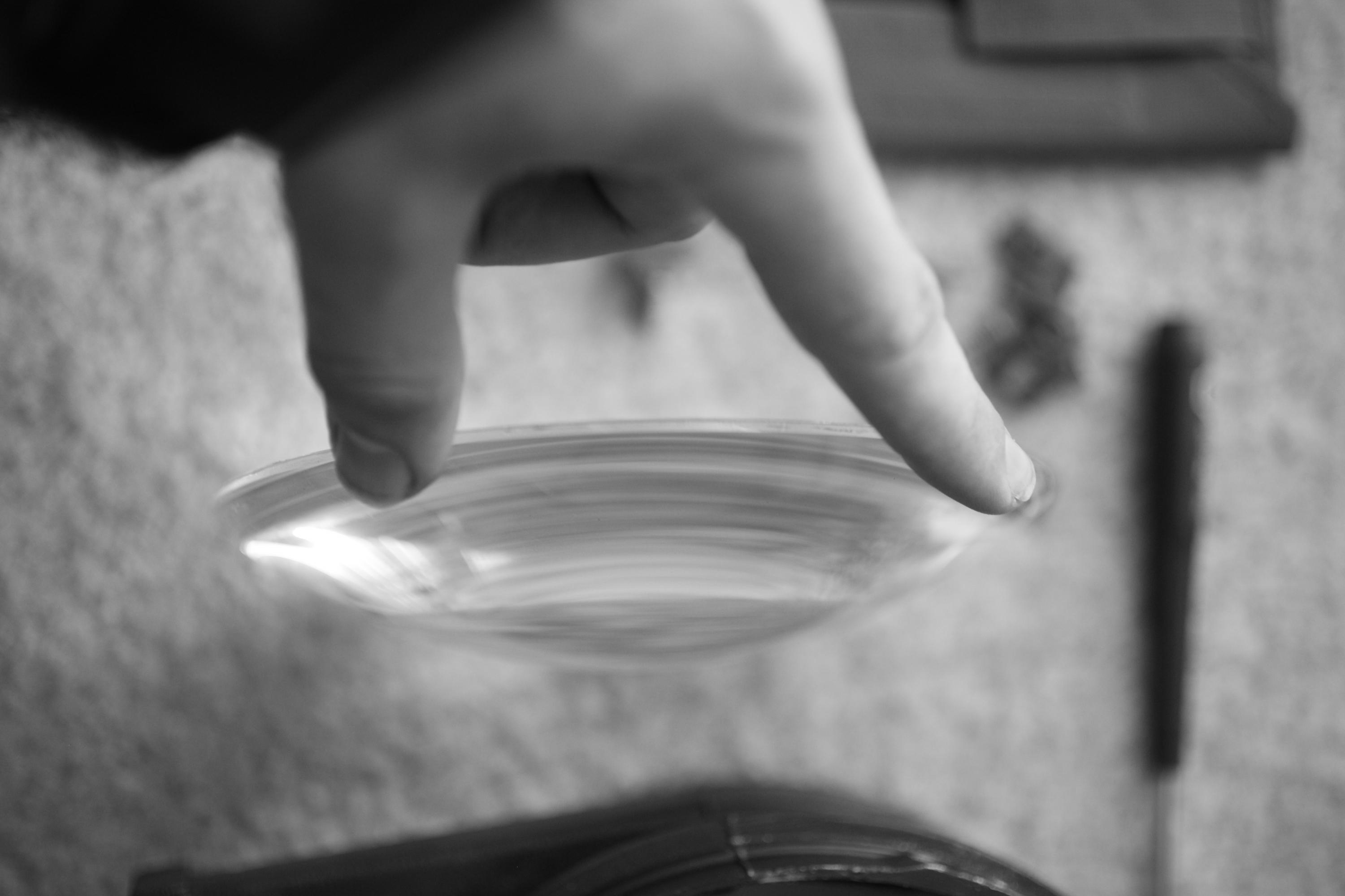

after looking at the manual, I believe item #5 the heat absorbing glass is improperly positioned. Currently it is placed directly ontop of #10 condenser top 7 1/8.
Apr 20, 2015
28
Instant Films
after removing the heat absorbing glass I am still getting two concentric circles and uneven distribution of light even without a lens.

attachment.php
attachment.php
attachment.php
attachment.php
attachment.php

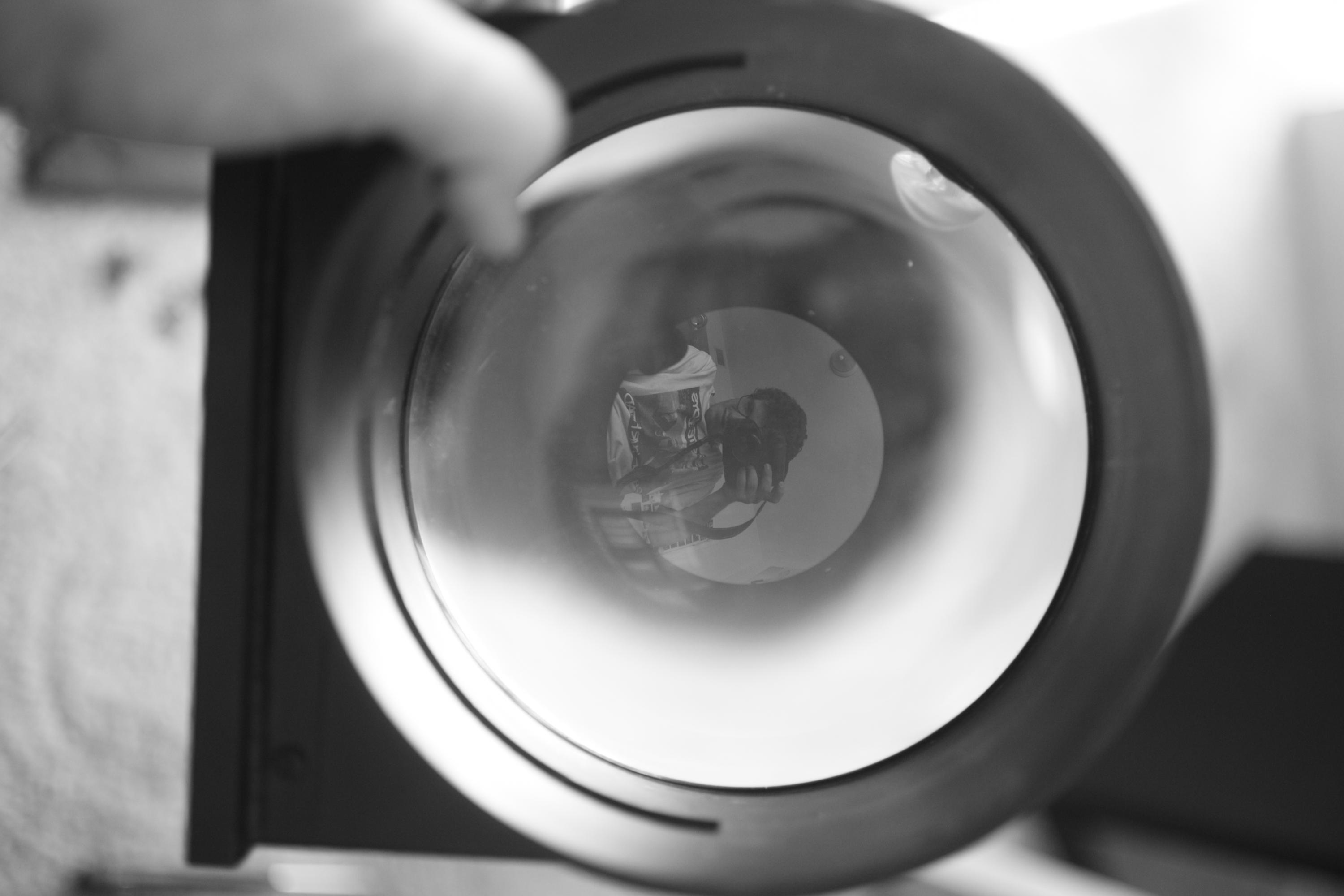

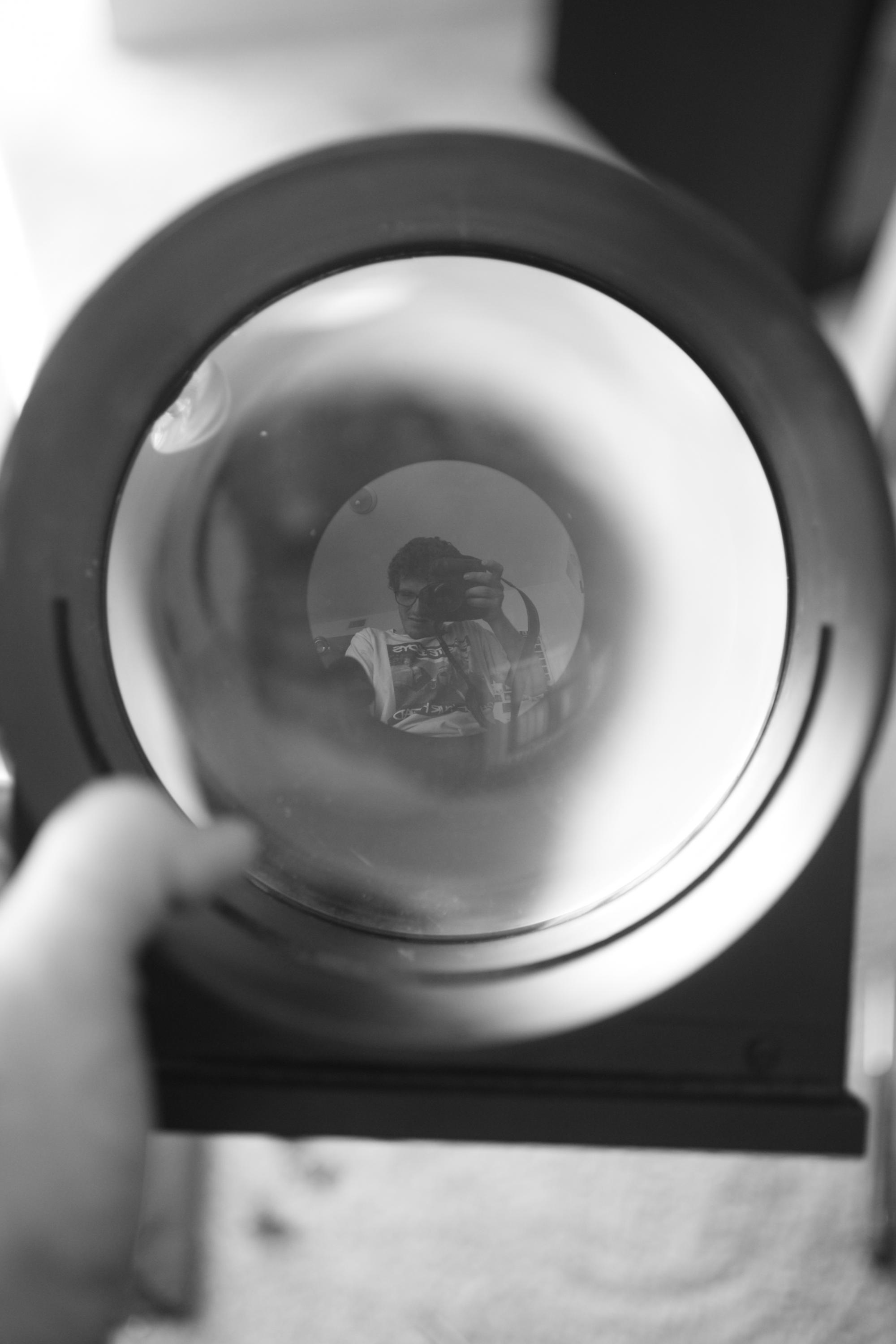

msage
Mar 22, 2003
437
Washington State
I use the Nikkor 75mm to 16x20 from 6x6 negs all the time.
Two thoughts.

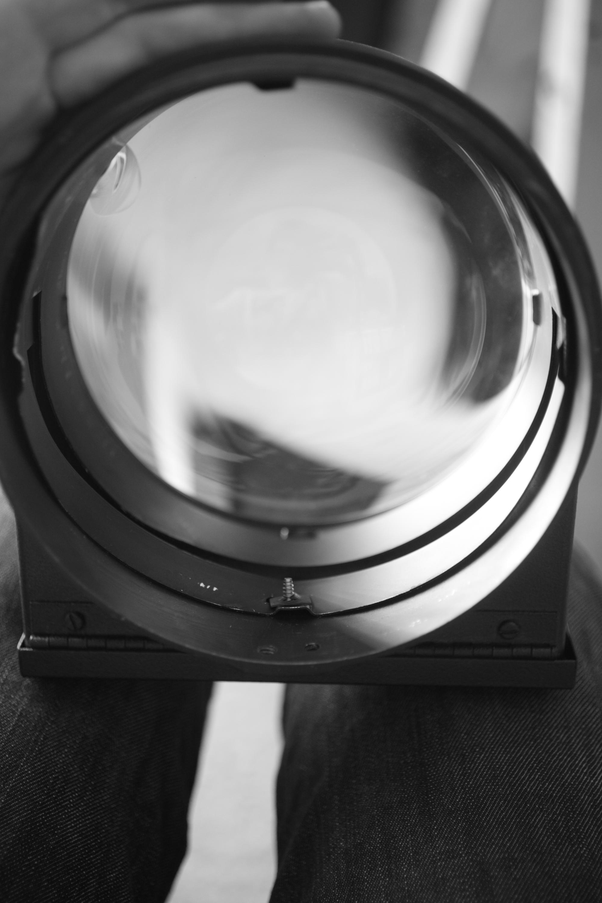

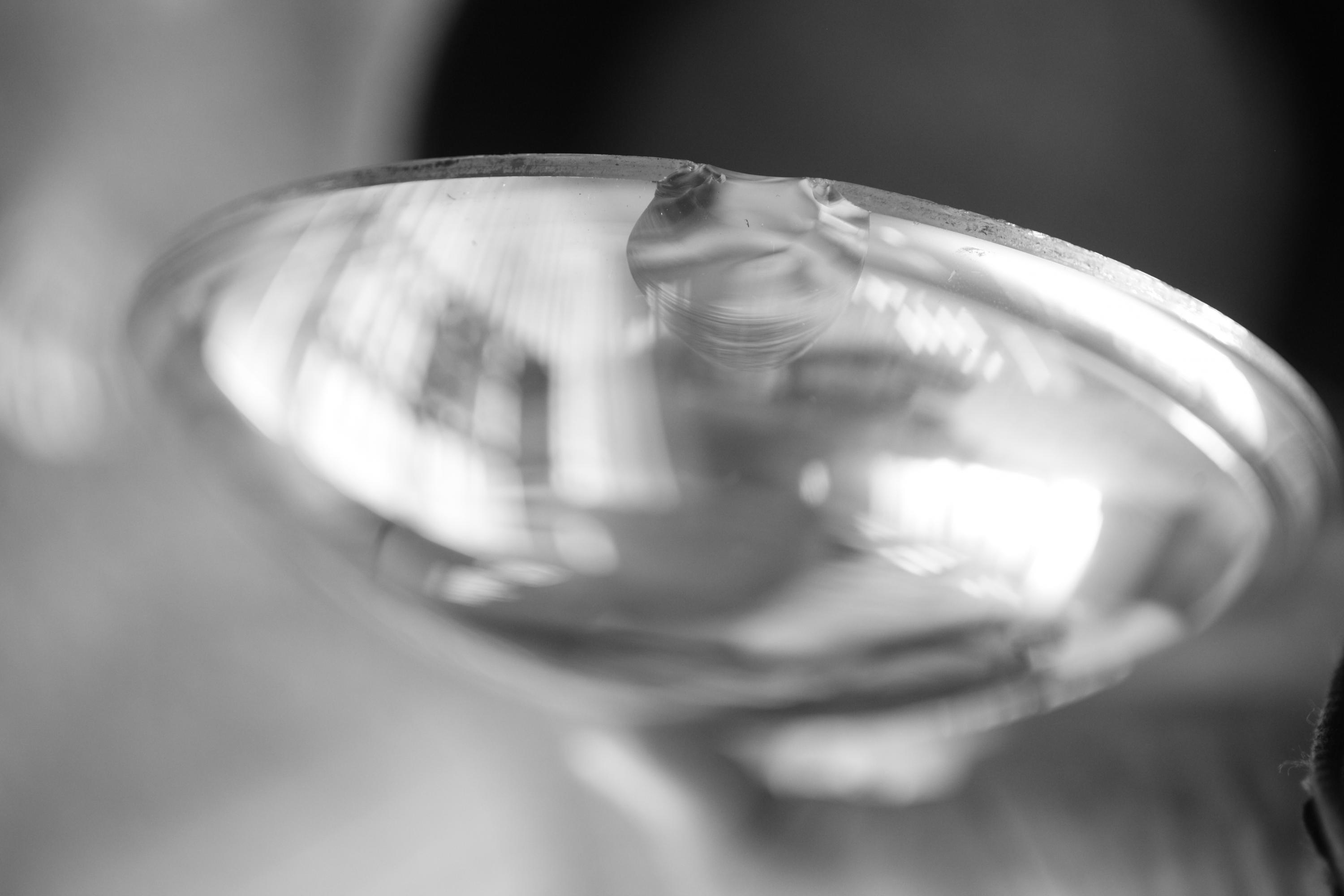

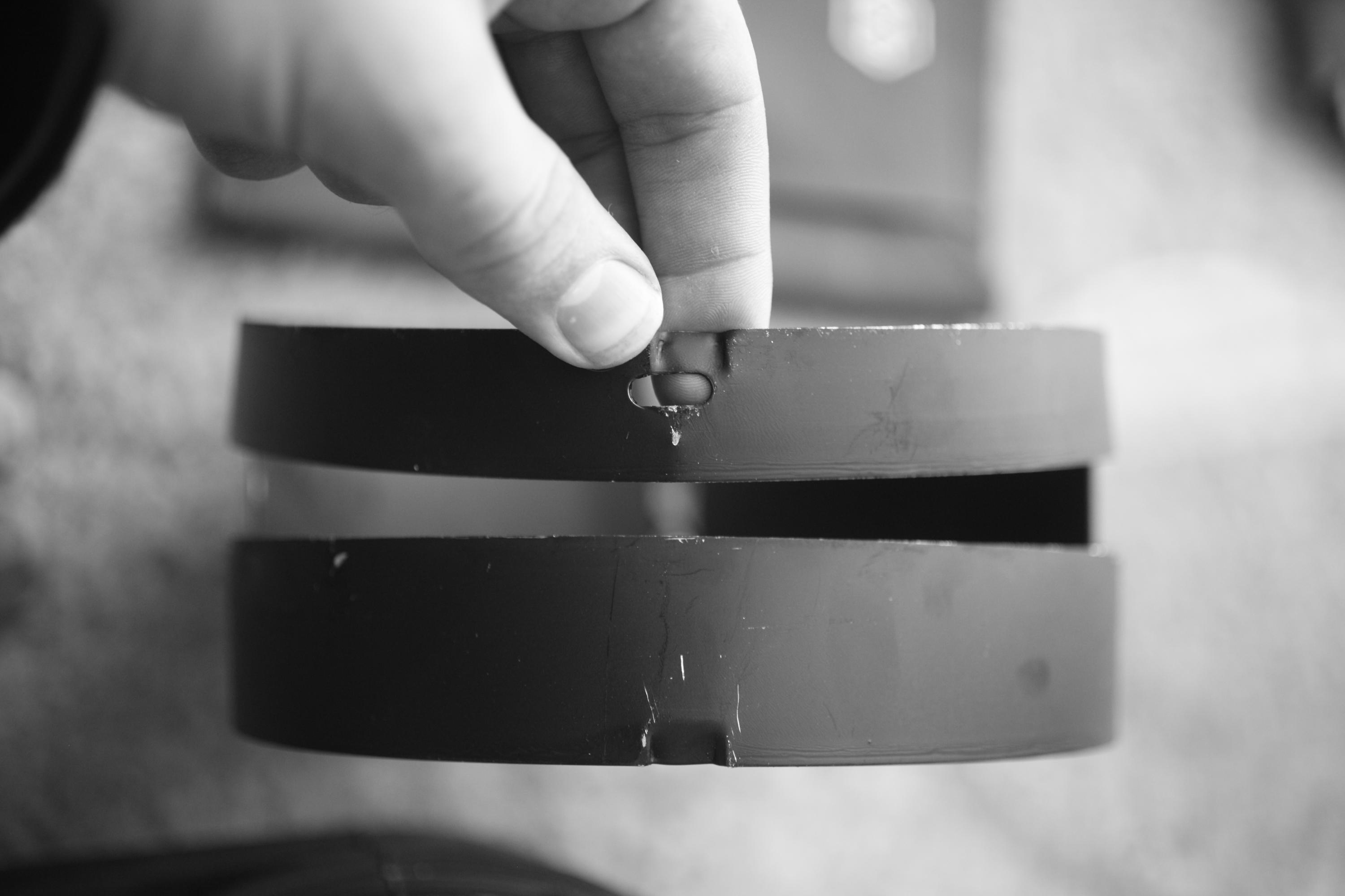

Is the condenser put together correctly? Going by memory, the curved surfaces face each other with the spacer between them. The slot in the spacer aligns with the filter drawer.
Or the condenser is too high, the top knob controls the height. There is a guide to set the condenser that is often missing.
See this http://www.beselerphoto.com/parts-pdf/condenserheadview.pdf

attachment.php
attachment.php
attachment.php
attachment.php
Apr 20, 2015
28
Instant Films

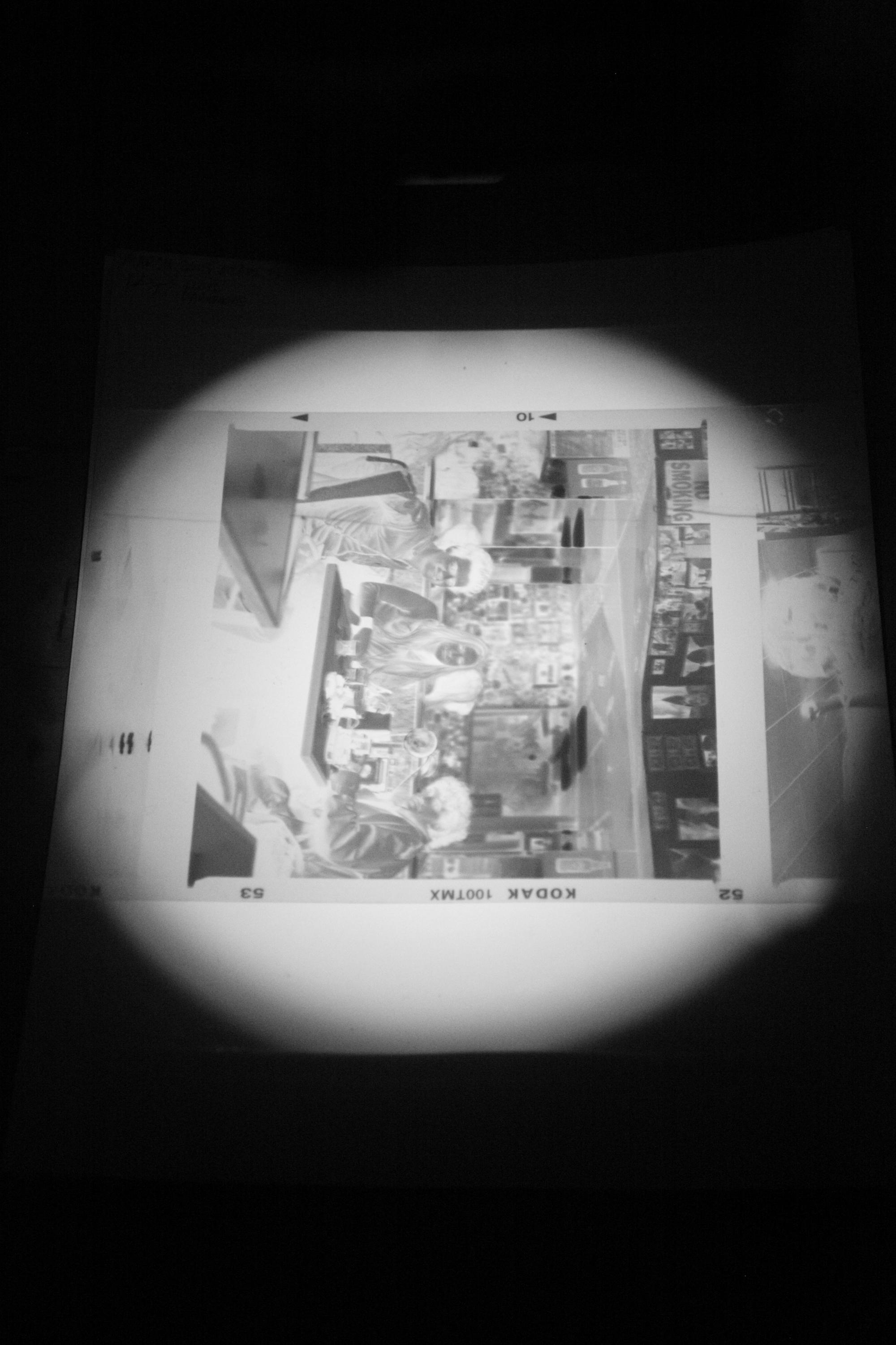

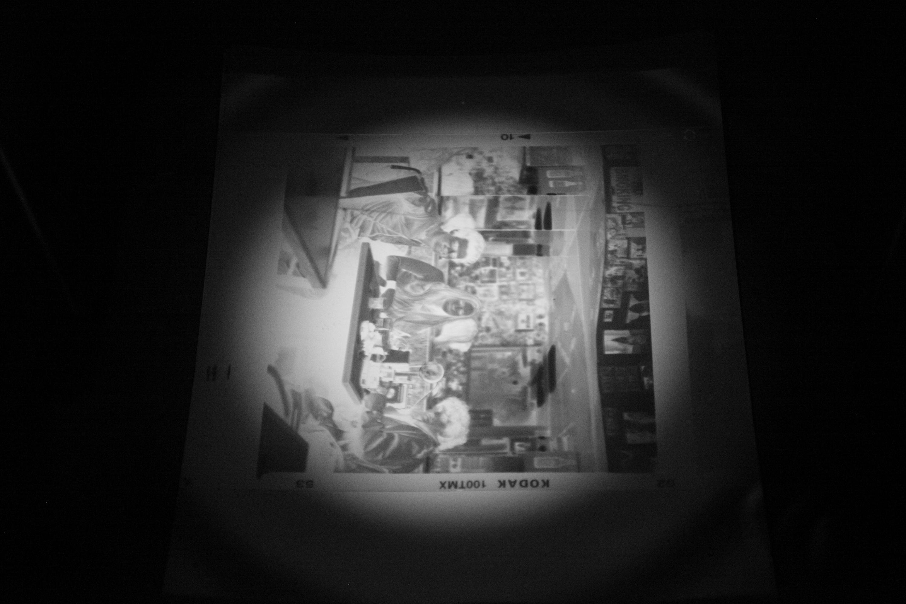

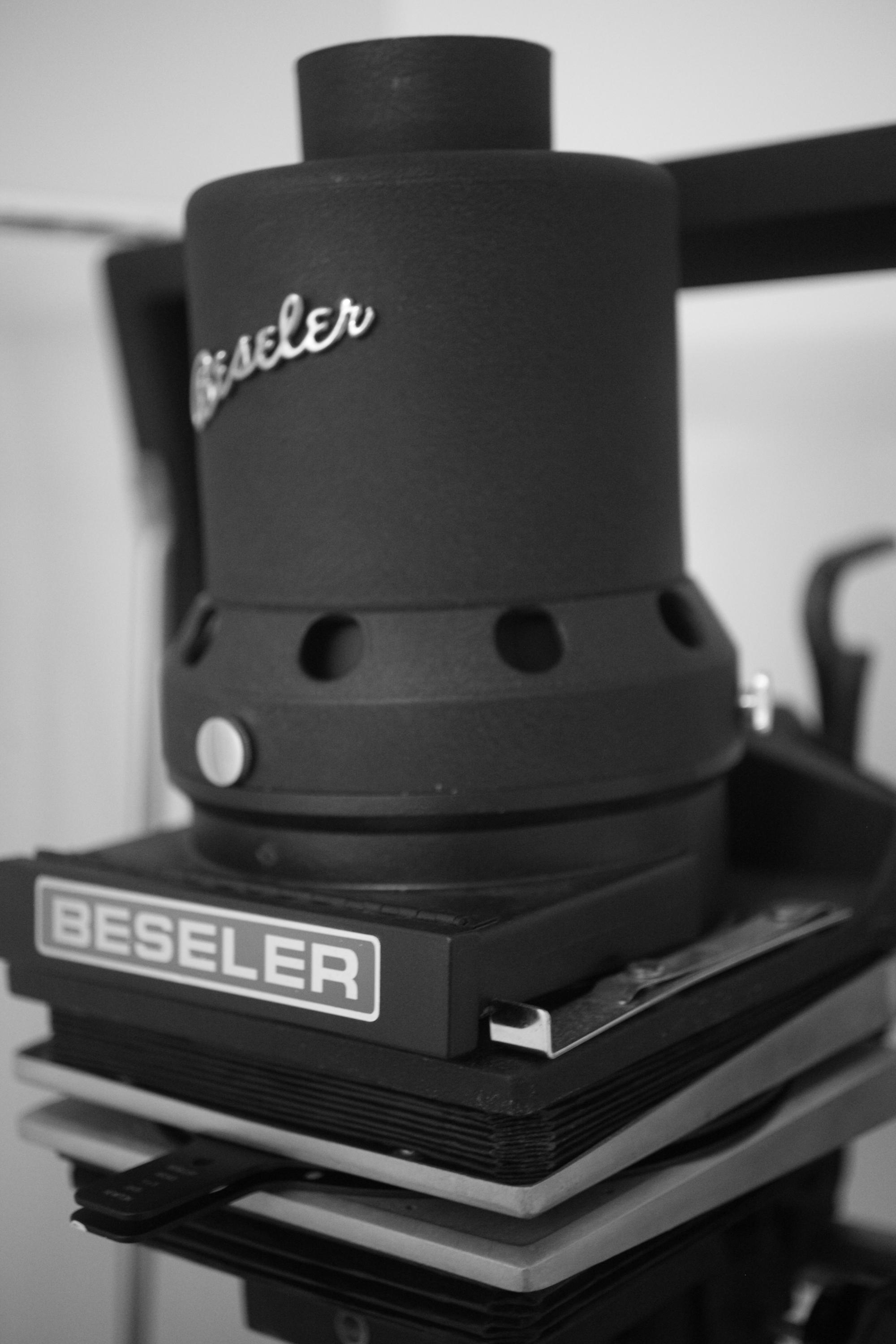

i think i fixed it. i am having trouble uploading the photos. it is the motorized model....hold on and i will try to upload a full image. when I extend the top condenser bellows I believe my issue is resolved...
Apr 20, 2015
28
Instant Films
attachment.php
when the bellows are too high i get the vignette...when i adjust them the results are the image i shared above
Apr 20, 2015
28
Instant Films
the cone of light covers the entire negative! as you can see my 6x6 negative is in a 4x5 carrier. thank you for your help I believe my problem has been resolved. If I attempt to enlarge the 6x6 and crop it to fill out the entire 16x20 paper I do not have a vignette. the problem was with the condenser bellows being at the incorrect height. as you can see my unit is missing the gauge that tells you the correct heights...must have broken off.
