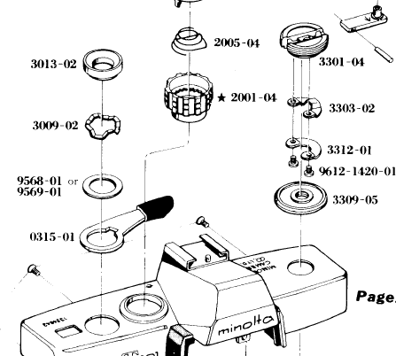

You need to unscrew 3013-02. Slip a piece of rubber hose over a plier and have a go. If 3013-02 is already damaged skip the hose.

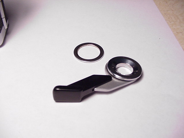

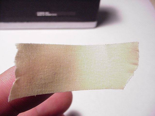

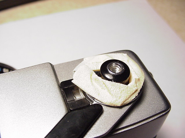

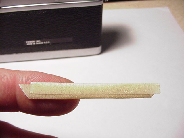

I always use masking tape...it works every time and never risks scratching or destroying your camera. Roll a piece of tape which is about 2.5 inches long inside out so that you make a roll which is sticky on all exposed sides. Then stick this on the ring and grip and unscrew. I do the same thing with Canonets. If you want to see images, please see below (taken from the Canonet re-sealing instructions I've written).
