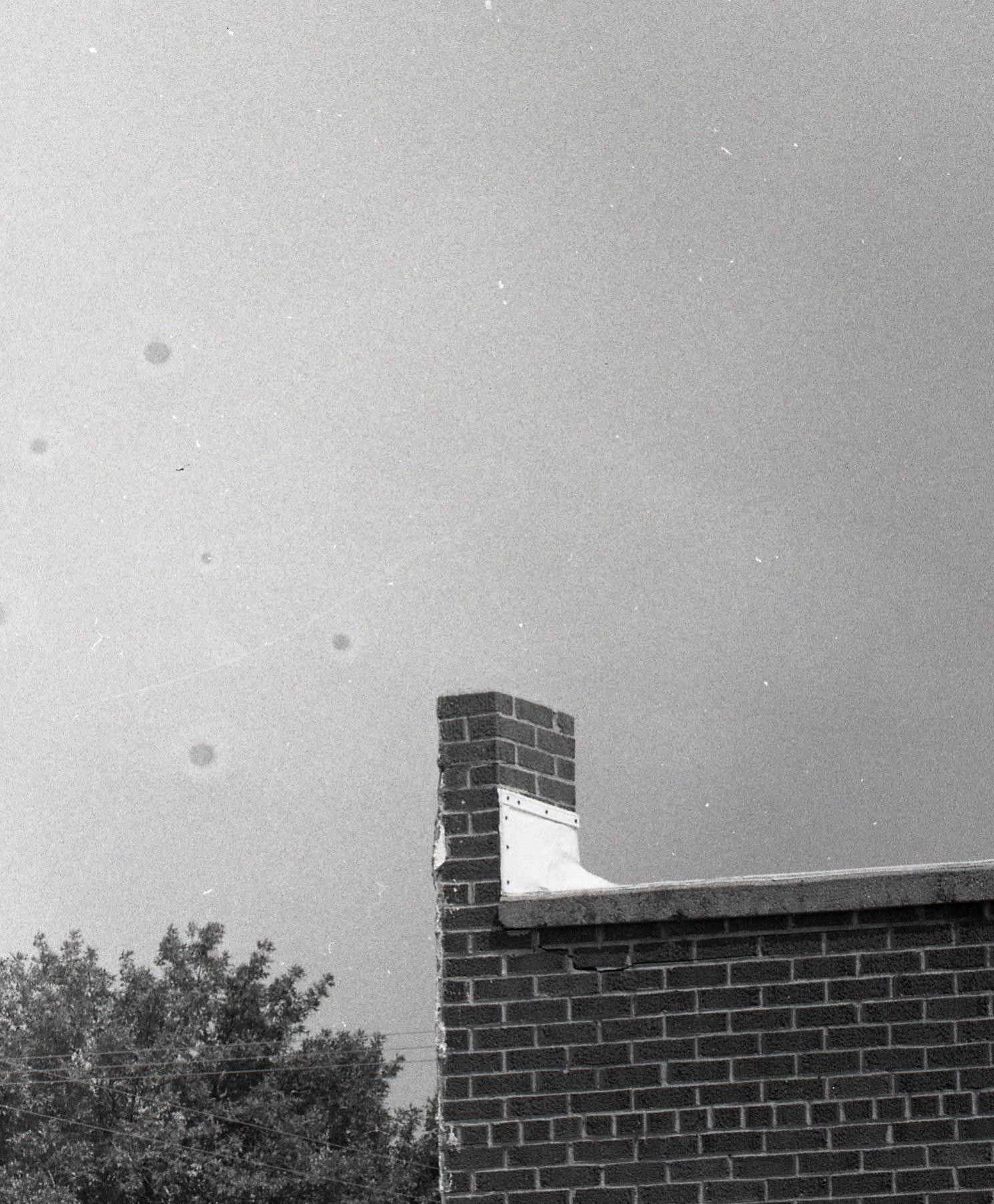

This is from a clip test with a fresh batch of Diafine. I exposed and developed one frame from a new roll of Pan F, 35mm. I placed the clip (about two inches long) on to a reel and developed it in a Paterson tank. Three minutes in each bath at 70F, rinse, fix, rinse, PhotoFlo. I agitated with the twirl stick, very gently as prescribed, for five seconds of each minute, in each bath, and knocked the tank to dislodge any bubbles. This is the developed frame. The spots don't look like airbells to me; they seem to have a more complex structure. There are some streaks too. Any ideas? Thanks.

Most of the spots look like air bells.You may not have knocked the tank hard enough to dislodge them. I know you don't use a presoak with Diafine, but I use the method but not that developer.

If the real development happens in the B bath, I wouldn't expect airbells to be a problem given that the emulsion is already saturated. Or maybe that explains why they look different... ?

is this scan from a print or direct from film? I only ask because scanners can add flaws, it has been my experience. I've scanned negs that drove me to despair, but the prints were lovely.

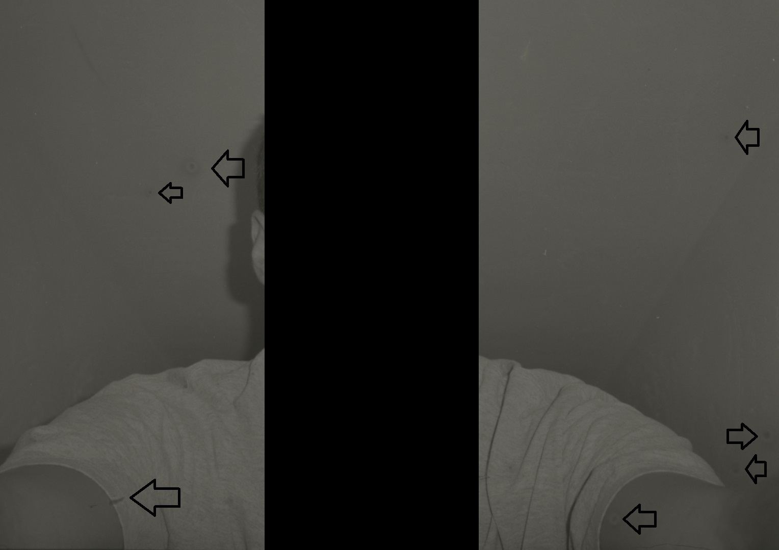

I'm NOT going to say they're NOT airbells, but here's a piece of neg that I'm fairly sure ARE airbells. And they have a look like I should know what they are (though the closest my brain gets right now is dust on the sensor and that doesn't apply - unless it's a scanner thing).
I meant to mention it. This is a scan with no correction, just inverted to show a positive image.

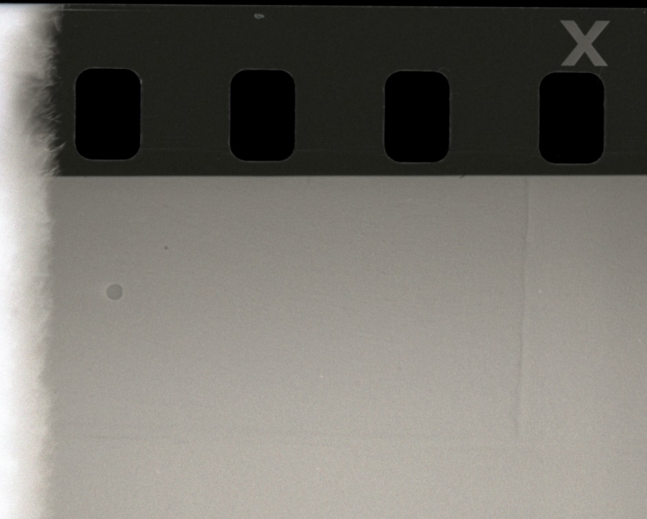

I'm convinced now that they're airbells. I ran a second clip test tonight -- a single frame of Tri-X, a flashed shot of my darkroom white wall from about two feet. Again, Diafine 3+3 at 71F, rinse, fix, rinse, Photoflo. For agitation, I did a gentle swirl in each direction, maybe twice, and then gave the tank a good rap against the work surface. I did this initially and after the first and second minute. The Diafine was prepared with distilled water.
The main difference between this and my first attempt is that I was more aggressive and consistent in rapping the tank. This time I got fewer airbells and they look different (different film?). But one is too many.
I'm thinking it's the agitation. With my usual development (using, say, D76) I always use inversion agitation and don't have any problems. With Diafine, the consensus is that inversion agitation for bath B is too aggressive, so I've only used the twirl stick.

You might be right. Still, I want to change only one variable at a time. My options for my next clip test are:
- Lengthen development times from 3 to 5 minutes
- Inversion instead of swirl agitation for bath B
- Different method of rapping the tank to dislodge air bubbles (but what?)

Inversion is the ticket. I ran another clip test and did three ridiculously slow inversions of bath B, followed by a bump each time. No air bubbles. Will do one more clip test before I drop anything critical into it.
