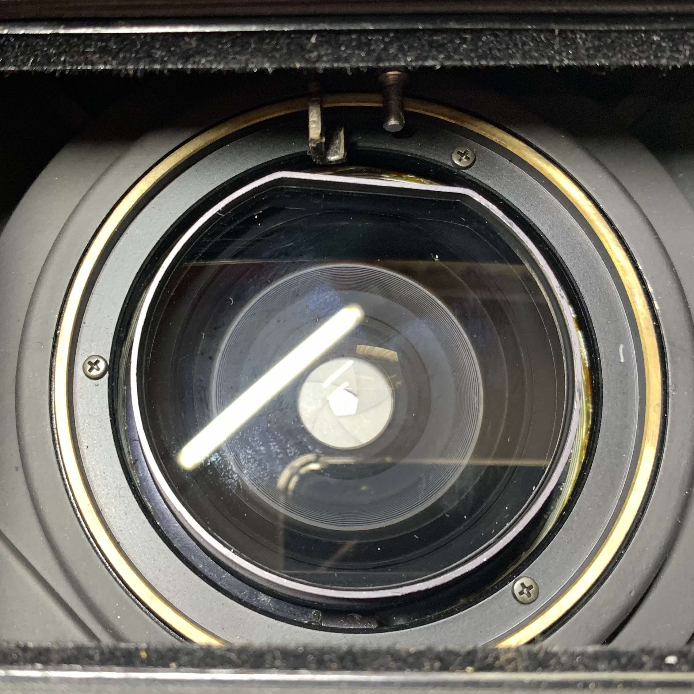

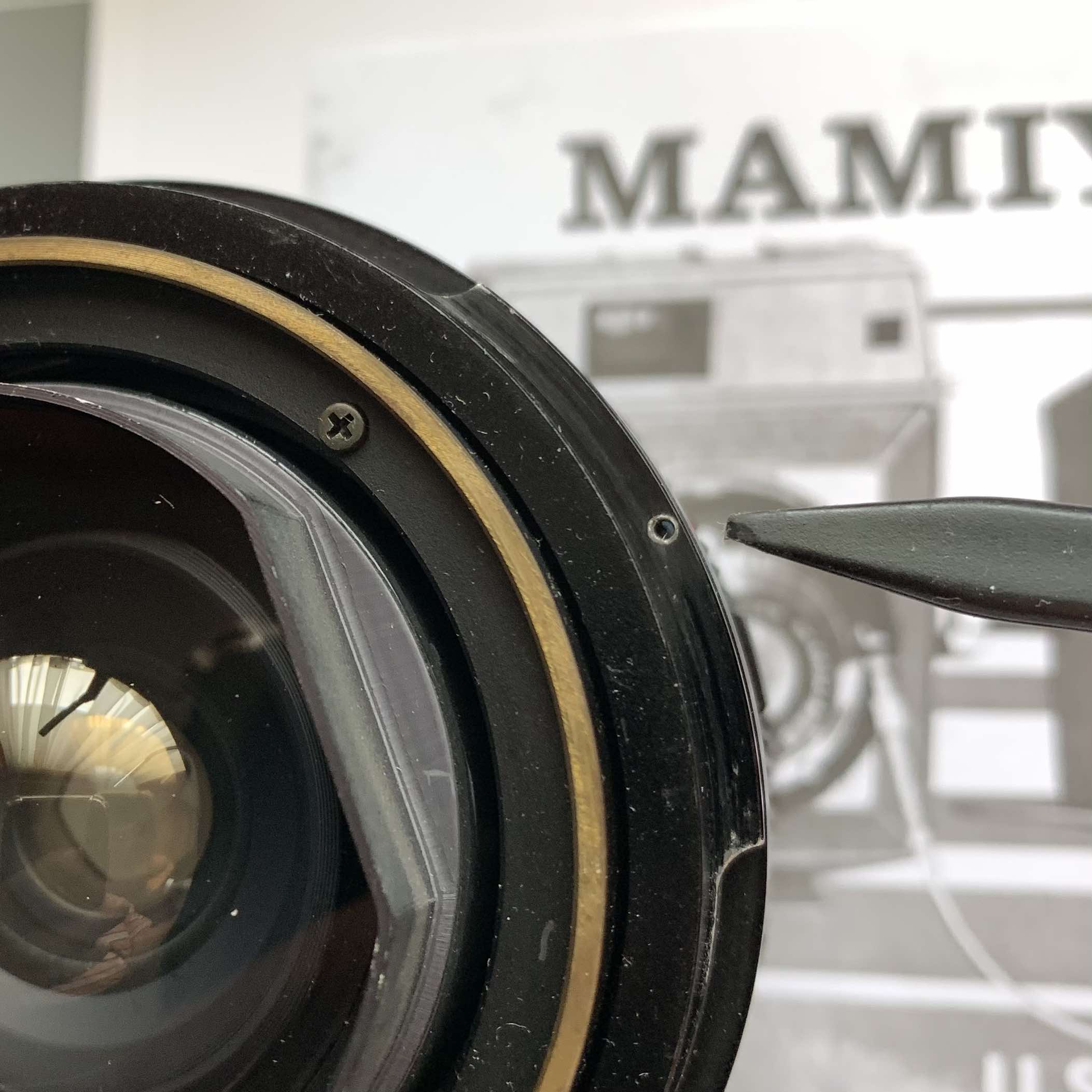

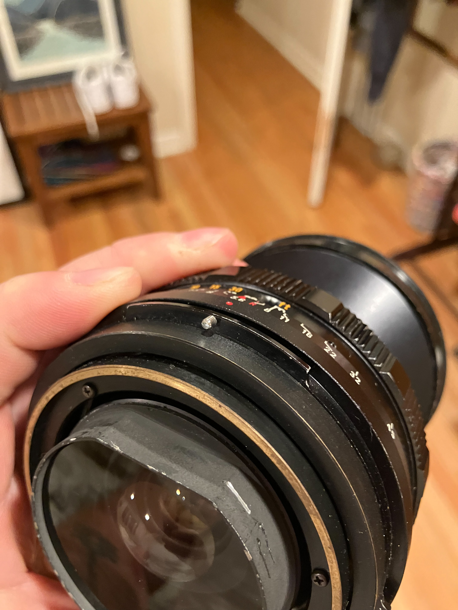

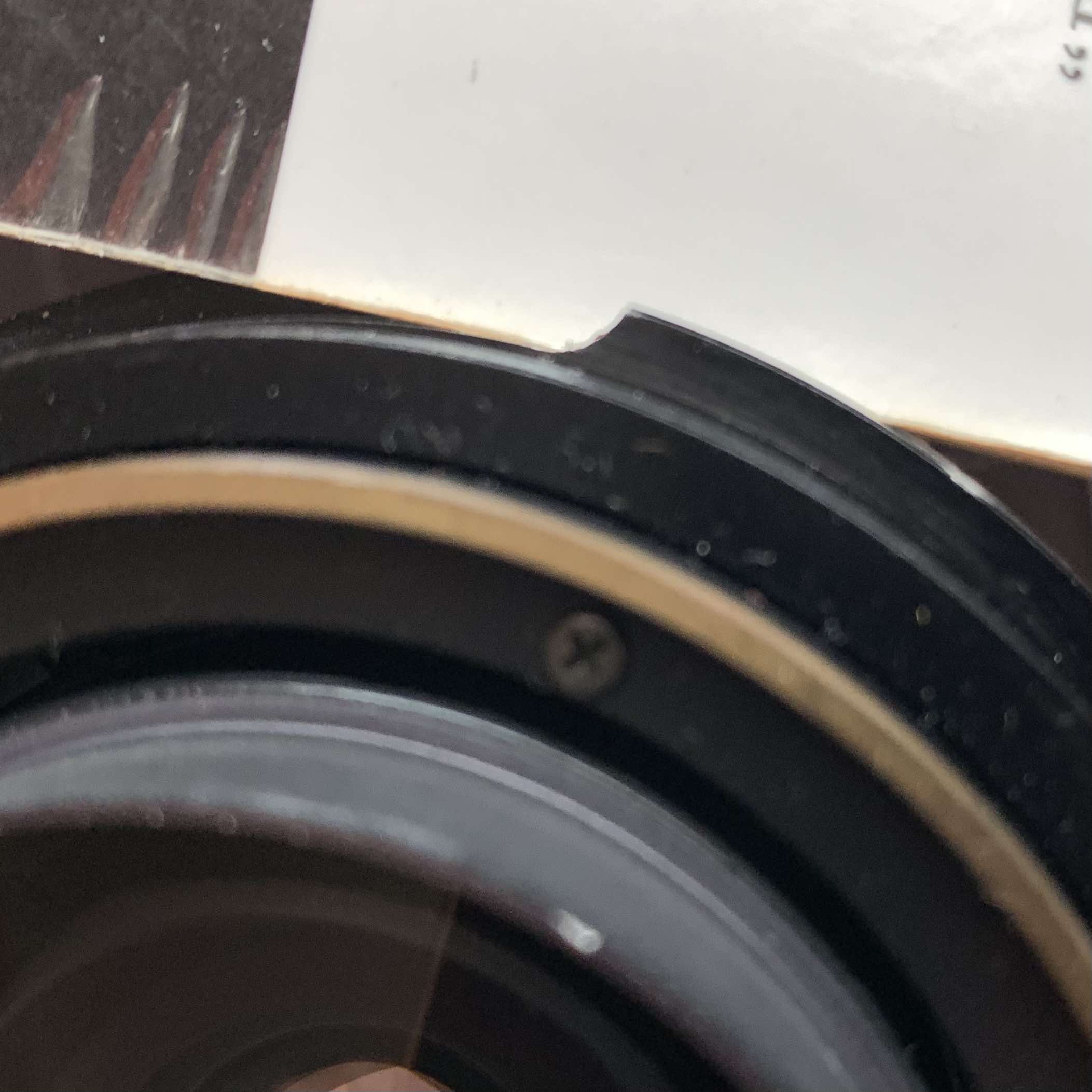

For what it’s worth my 75mm won’t mount to my press bodies.
I’m not entirely sure what fouls it, but there’s a little pin on the mount that isn’t present on any of my other lenses.
The rear element also rubs against the lever to show if the 100mm is retracted.

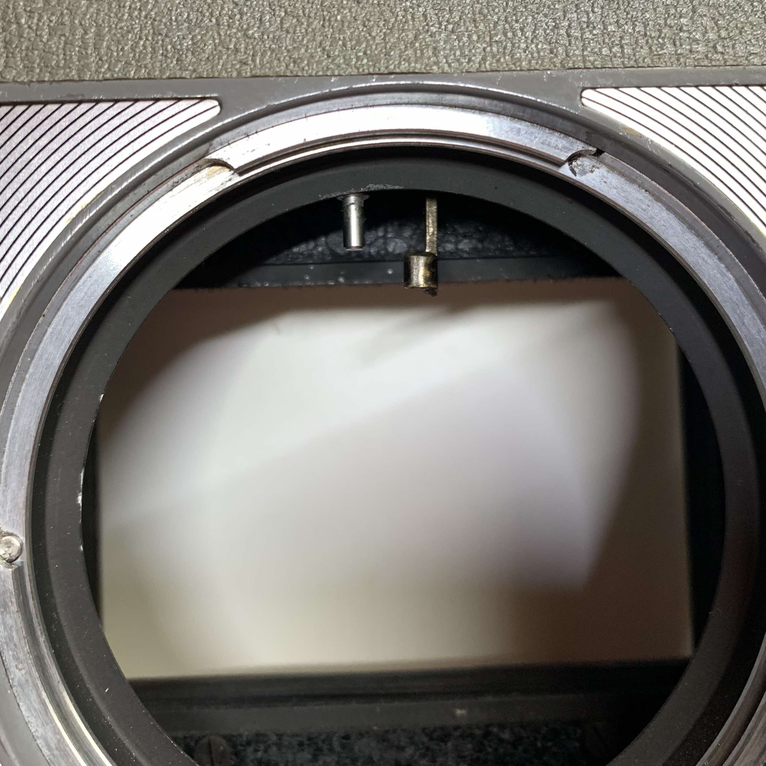

Curious! Do you mean the older Press bodies and not Super 23? Some of my stuff for this system is packed up now, but I can confirm that:
- my 75mm also has this pin
- there is a hole to accept this pin on the Super 23 and Universal bodies.
I don't have a older Press body at hand to check. But given that to mount a lens on a Press body, you rotate the lens, as opposed to the breechlock, I think it's pretty certain that the pin would not clear the body mount as you rotated the lens.
I don't know if the other larger later lenses (like the 100/2.8, 127, or 250) have this pin. One could probably unscrew it, but also presumably it's there because Mamiya thought the lens was incompatible with the older bodies somehow.

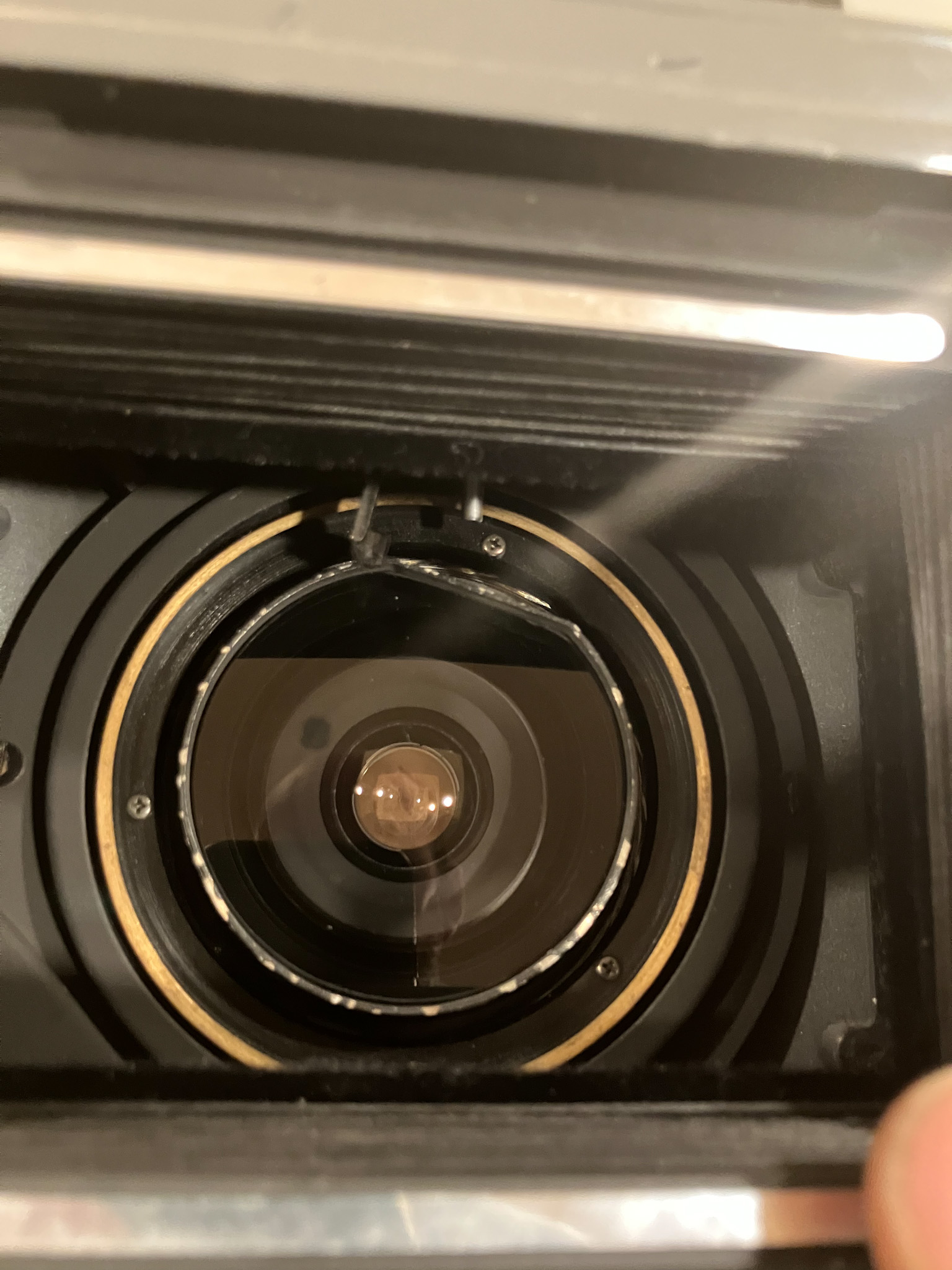

Yeah exactly, the original press body. I don’t even feel super great trying it! The scratch you see on the rear element is from my one attempt 🤣
When I was testing here I used a body without the rangefinder and retraction levers.
The 127 does not have this pin I’m not sure if i’ve tried attaching it to the original press but my suspicion is that it would mate fine.
Maybe it’s the size of that rear element, it doesn’t seem to safely fit into the press.

I think the 75mm and 250mm were introduced with the super and universal, and weren't back compatable.
My 75mm Mamiya Sekor P lens shows the threaded hole for this screw, but the screw is not there. Without the screw, the lens mounts easily on my Mamiya Press 23. I would simply remove the screw and try mounting it again.
Does your press 23 have the warning flag for a non-retracted 100mm lens? My lens catches on the lever in the original press body (as well as the screw that I’ll remove for another press body I have where I removed the lever!)

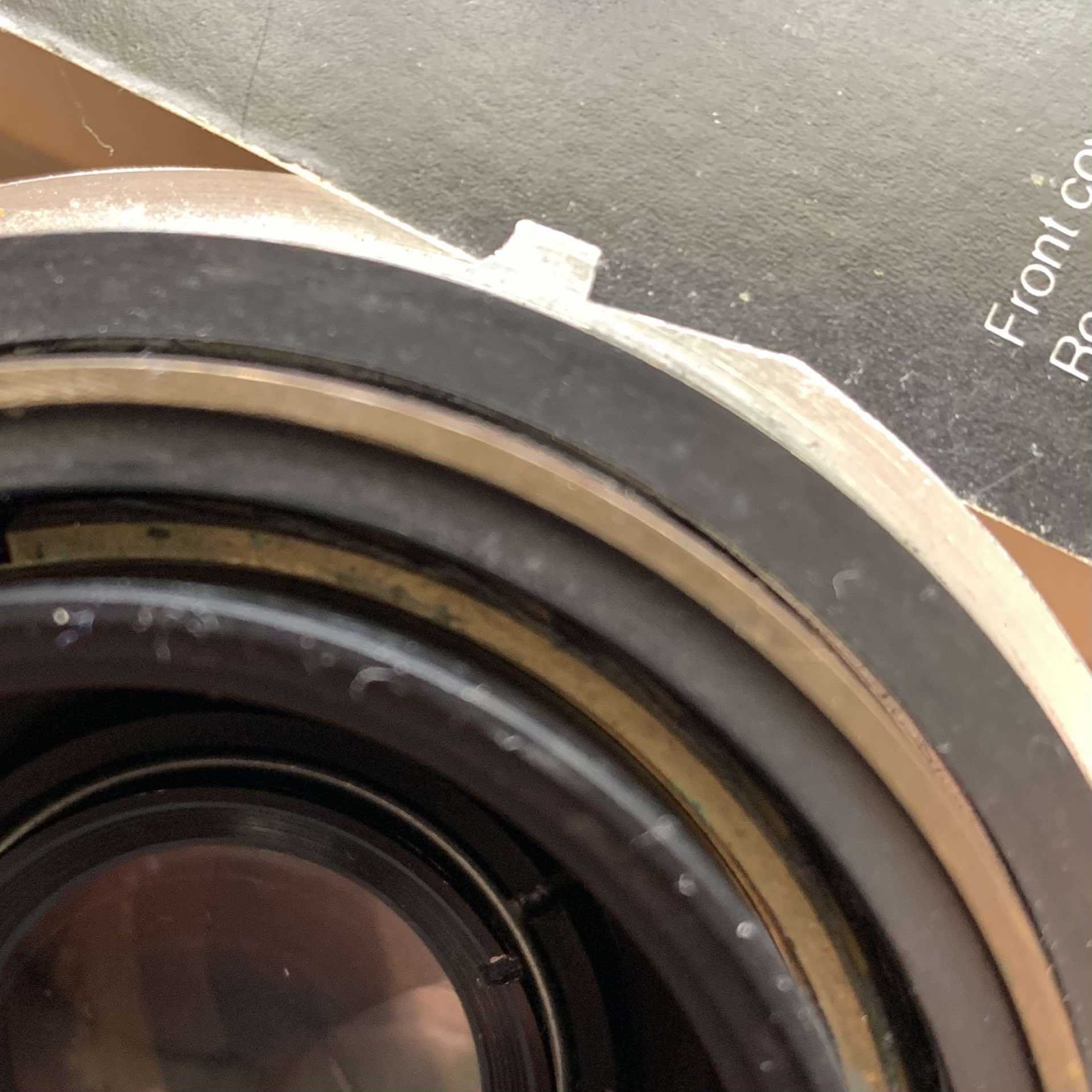

I've noticed my later, black-bodied Mamiya Press P lens doesn't have a notch in the lens mount bayonet to allow the lens release pin to click into place and release via the lens release button located on the lower right corner of the Mamiya Press 23. Earlier chrome lenses have this notch and will click securely into place when mounted. Apart from this notch, the bayonet mounts appear identical.

My later model 100, 127, and 50mm lenses all lock into the older press bodies and have the notch. The 75 does not have the notch (but see above for other issues I’ve had with it mounting)
- A
No, I don't think it does. The Press 23 is designed to work with the standard 90mm f/3.5 lens either in the normal position or collapsed to allow movements on the back of the camera via a ground-glass screen. The rear element of the 75mm is roughly the same diameter as the collapsed rear ring of the 90mm (and probably 100mm) so it would likely throw that flag. I suspect the flag is simply there to prevent people mounting lenses in collapsed mode and wondering why they don't focus. In which case it the lever could likely be removed without issue (other than perhaps resale value) providing you're aware of the existence of collapsible lenses and know to extend them to normal position.
EDIT: Apologies, yes it does seem to have that lever
- A
So yes, my Press 23 does have that lever. When the 90mm is retracted it throws a flag in place of the rangefinder patch, which makes sense since it is designed to be focused via the ground-glass screen in this mode. The rear element of the 75mm lens clears this lever, but only just. Curiously the 'flattened' part of the rear element doesn't sit square when fully twisted into place. I'm not sure what the idea is behind this squared-off part of the rear element; possibly designed to avoid contact with the rangefinder tab.
On mine the flag lever contacts the rear element glass 😬
