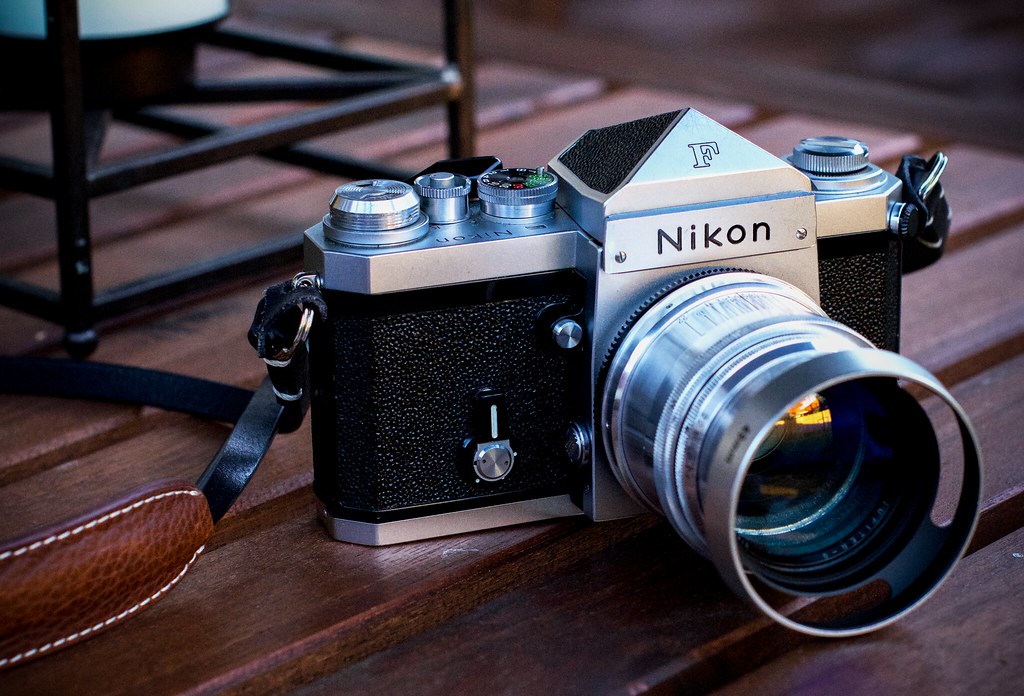

I love the Jupiter-9 85mm on my Nikon F.
That's beautiful. I have the camera. What's the story on the lens? New, old? I know the eastern bloc made some great glass in the day.
A boring F3 :smile:... a sad Alpa, a obcessive Hasselblad and a maniac Leica

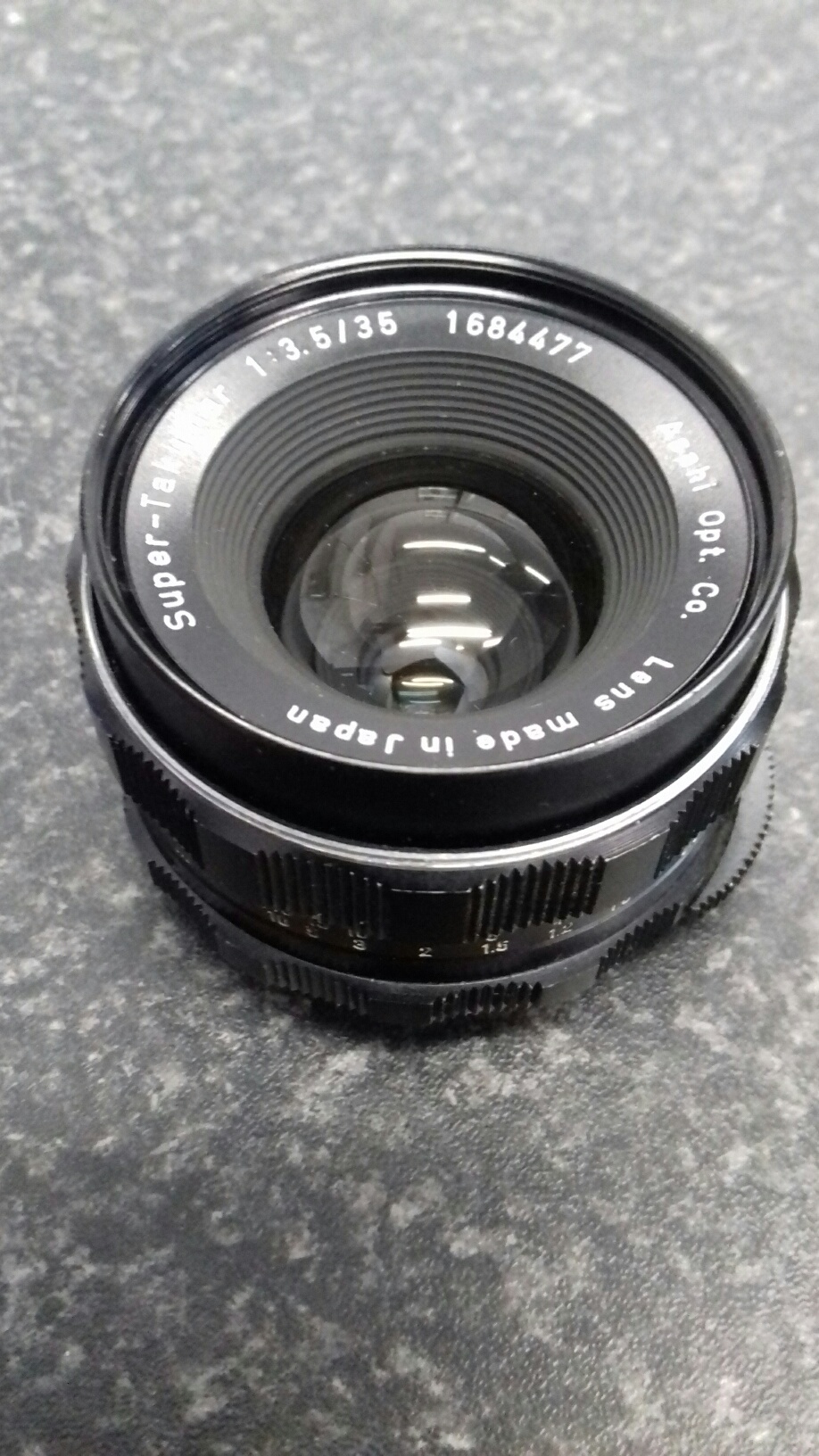

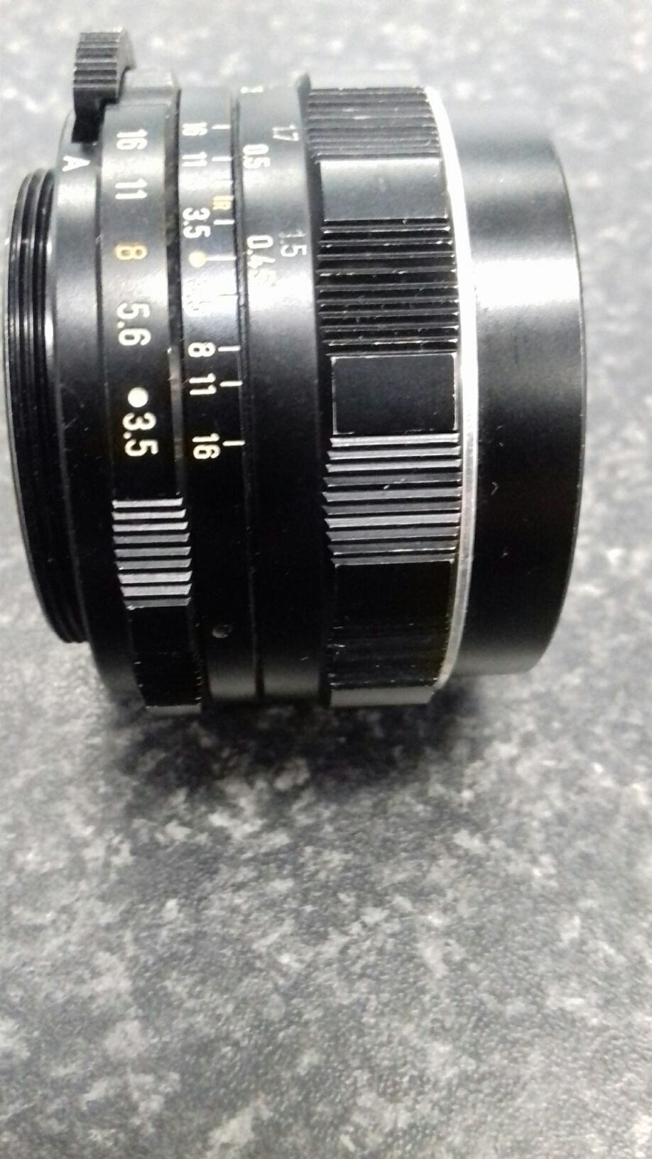

I want to get a super takumar 35mm 3.5 for my spotmatic and I have found one for a decent price. How do I tell if this is the multi coated or single coated version? (sorry about image quality, it's what the seller sent me)
Fortunately, with the Takumar lenses, it is easy:
1. If the lens says Super-Takumar, it has single coating.
2. If the lens has Super-Multi-Coated or SMC, then it is multi-coated and approximately later then 1972 production.
The Takumars were well-designed, and the single-coated ones are not especially flare-prone, in my experience. A deep rubber hood is a good idea.

In the 1960s and 1970s, tens of companies made or marketed M42 thread-mount lenses. For the most part, the Pentax Takumar versions were the best optically (with some exceptions) and usually were the best mechanically. Considering that the 35mm lenses are so inexpensive now, I'd recommend you look for a 35mm SMC version followed by a Super-Takumar version. Really, for most conditions, I doubt you would see much difference. Possibly with sun shining right on the front element, the older one will have more flare.

If it was the multi-coated version, wouldn't it be an SMC Takumar lens? I have the Super Takumar 35mm f/3.5 myself and it's definitely single-coated.
