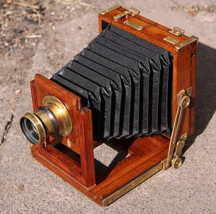

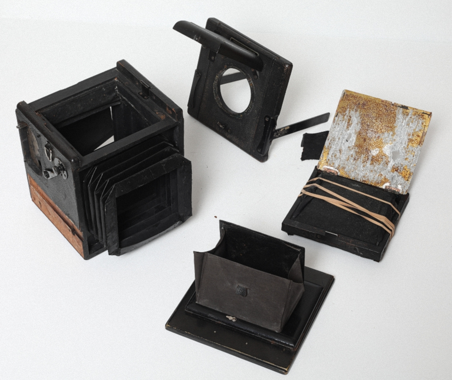

I began with this one . . . .

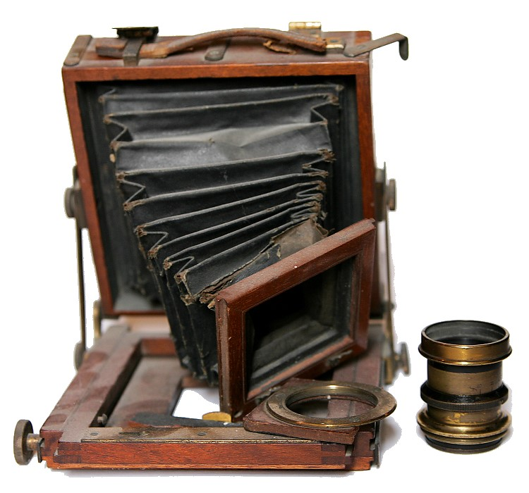

Then this one.

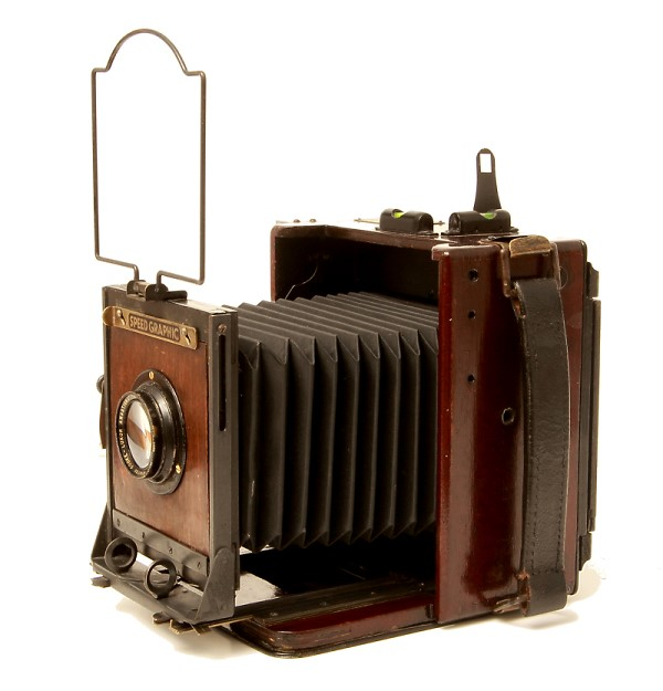

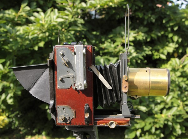

It's a pre-Anniversay Speed Graphic that had been converted (from new) to be a wide angle camera, the Meyer rangefinders is set for a lens of around 90mm
The lens is an 8" approx Petzval, I have used the camera a with a 14" Dallmeyer Telephoto. I eventually replaced the bellows
Here the camera is fitted with a TT&H Cooke Series II 5¾" f4.5 triplet. I think it's actually marked as a Cooke-TP Luxor.

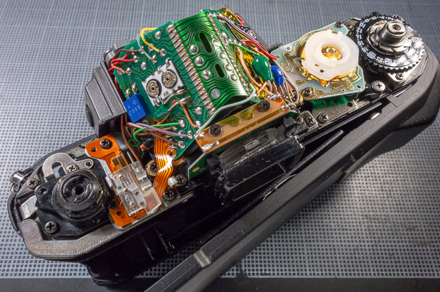

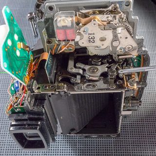

SLRs are on the list, this was last night . . . . . . . . . . .

Not bad: Now that I've done a couple, I can turn those around fairly quickly. But need to remove adhesive stuck to the front of the pentaprism before it damages the silvering, and there's an rubber damper on the side of the mirror box which needs replacing. Need to unsolder a number of wires and remove mirror box in order to access, but it's not particularly difficult.
Actually, I have been trying to find some affordable SLR with AEL button, exposure memory lock, that would be easy to service, and not too modern - I do not want noisy motor winding nor autofocus-oriented small viewfinder. Maybe Pentax P30?
Never attempt to remove the lens mount in the P30. It'll be a nightmare to put the electronic contact pins and aperture coupling lever back again.
