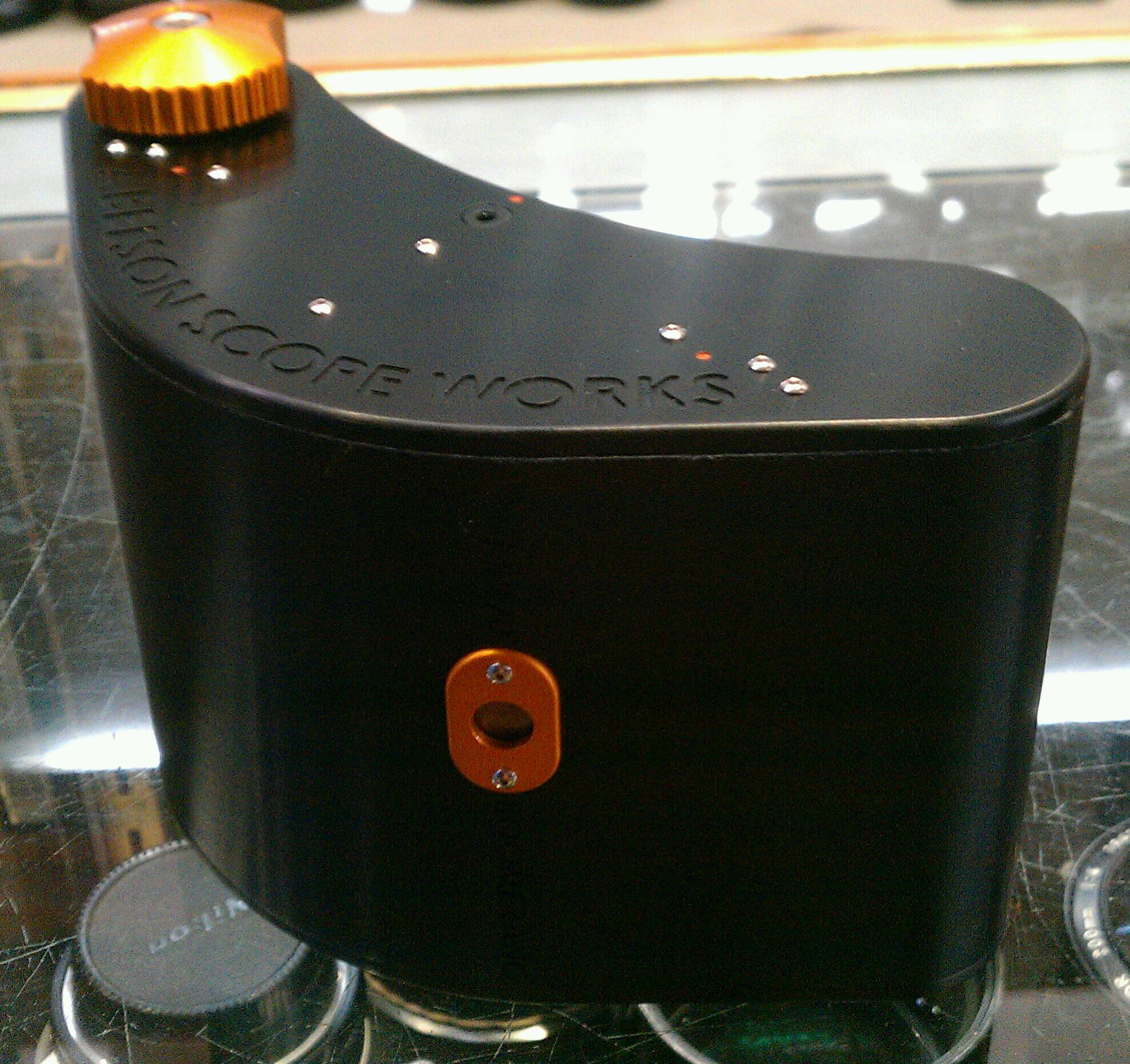

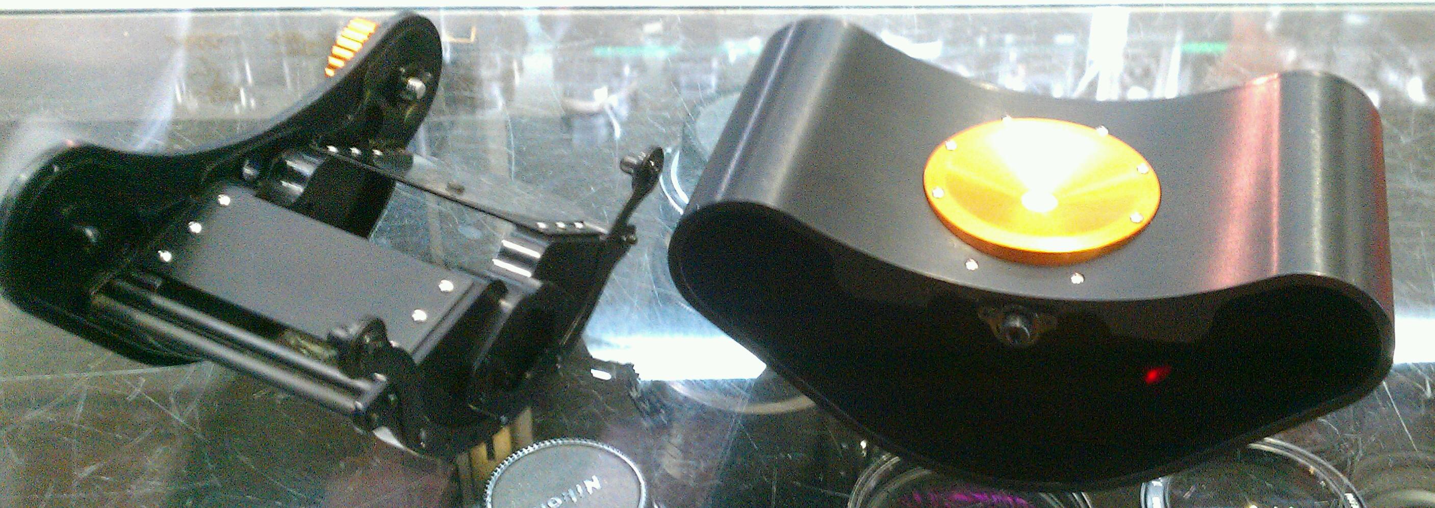

Pinhole Blender - a metal tin fitted with a pinhole - you use a 35mm film run from cassette to cassette. It has a curved film plane, and depending on how far you wind you can either take individual photos or "blend" the pictures together.

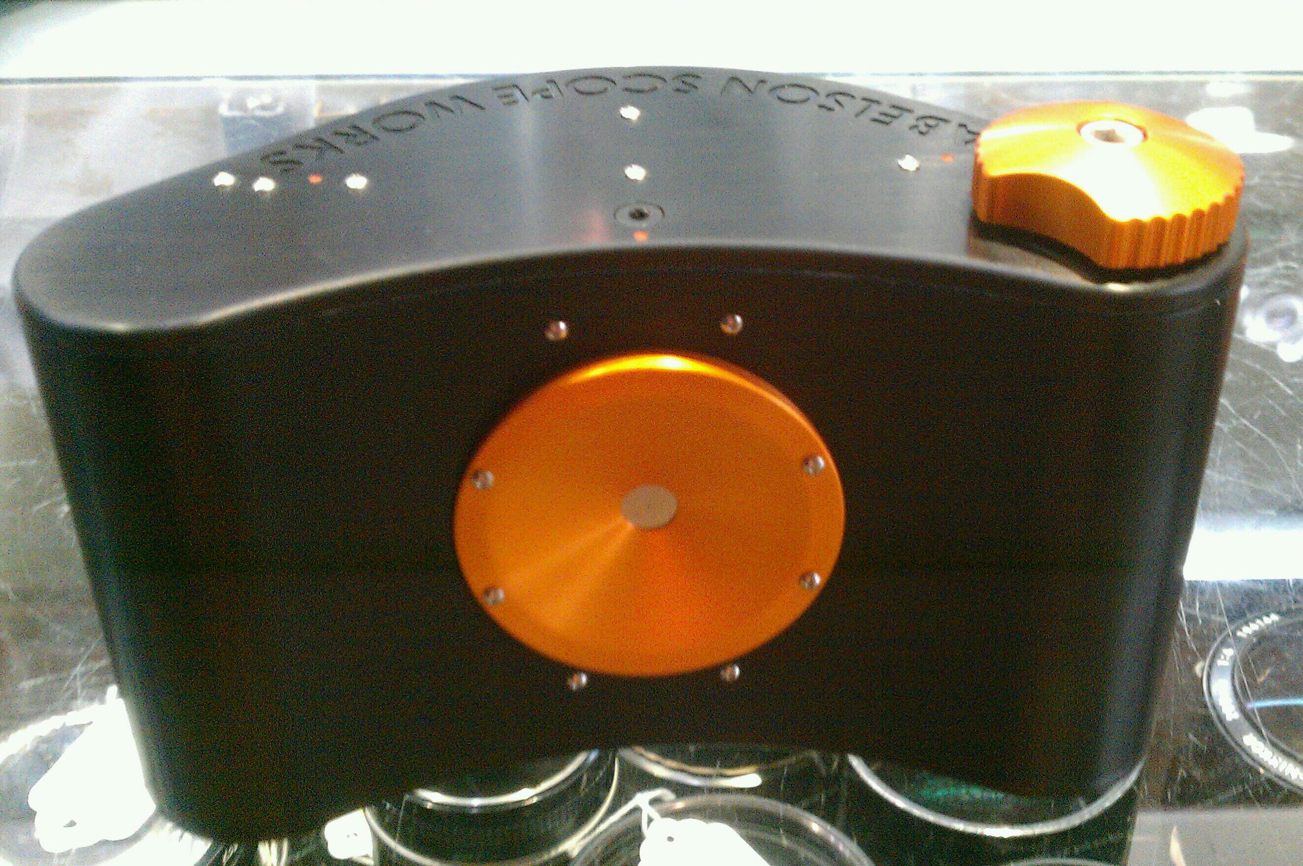

For amazing workmanship in metal, I did see this last year:
