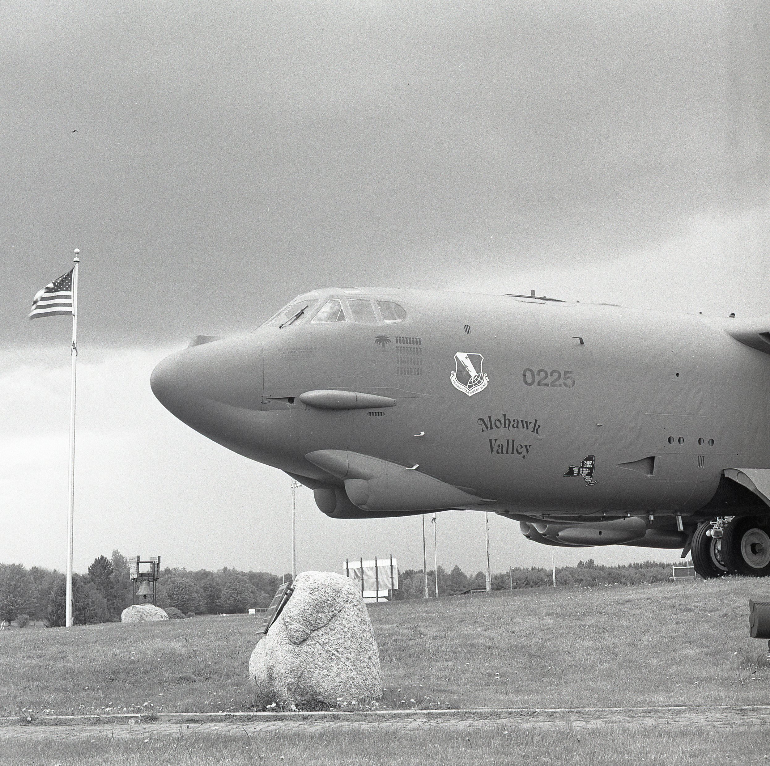

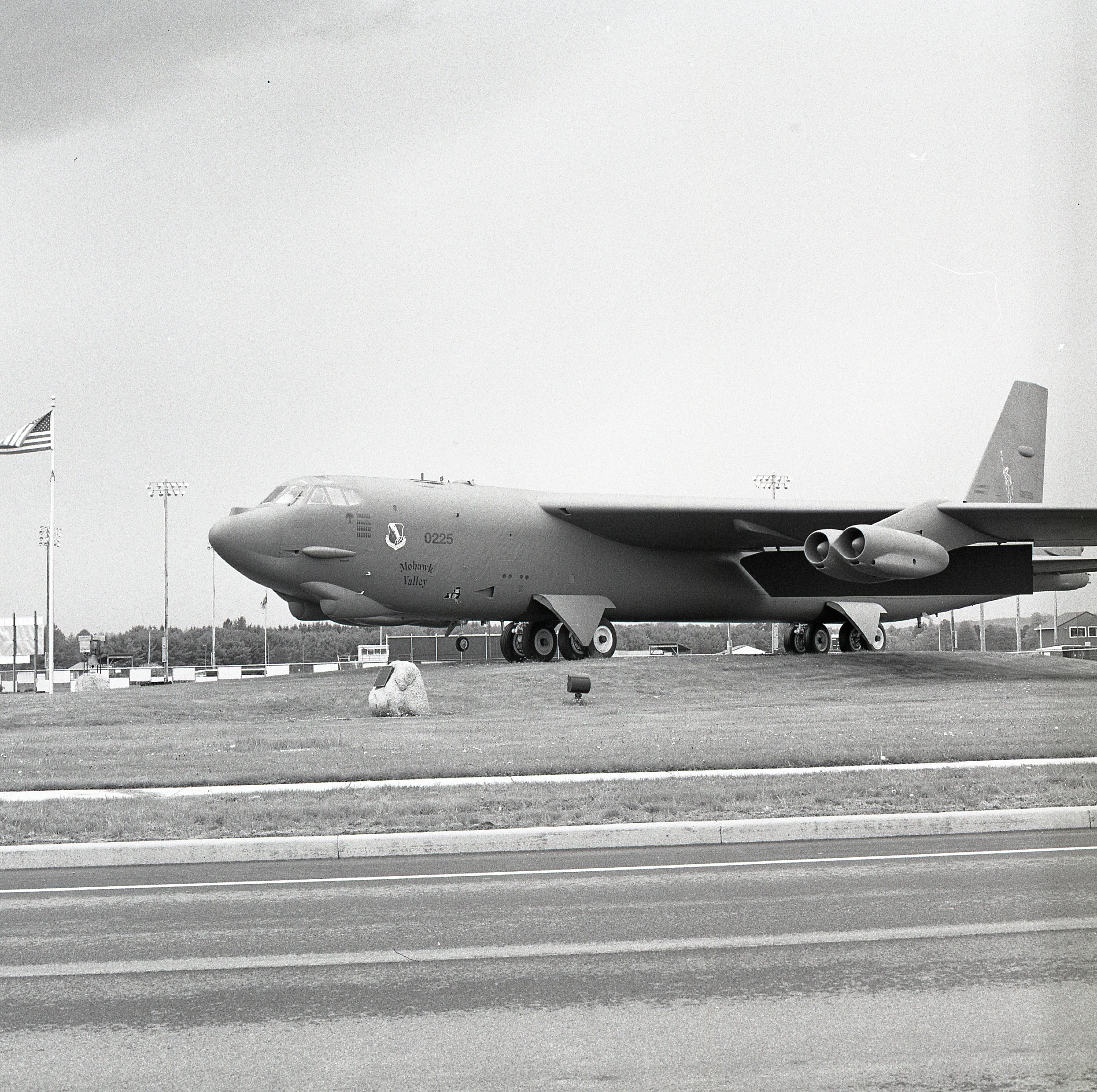

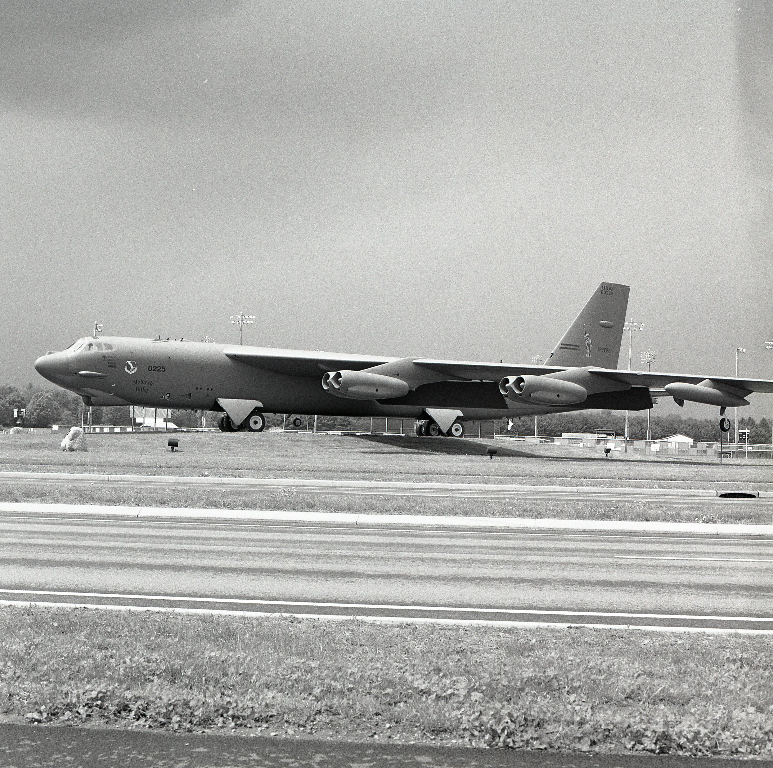

What is this on my Negatives??

I bet you’re using a late model Epson scanner, maybe the v750?
Bob Carnie
Apr 18, 2004
7,735
toronto
Med. Format RF
looks like insufficient agitation in the first 15 seconds of development... grey skys are the worst to control.
John Galt
John Galt
Mar 8, 2017
357
Rivendell
Bob, nope, don't think so. I agitate for the first full minute of processing, then 10 seconds every minute after that. This artifact is on all 12 frames, some are worse than others. I can see why you may think this though.
Bob Carnie
Apr 18, 2004
7,735
toronto
Med. Format RF
Ok - I invert as soon as I fill the tank even on a jobo to eliminate this issue..
koraks
Nov 29, 2018
26,731
Europe
My first thought was "are you using a jobo..." My second thought was: is the developer volume sufficient, is the reel correctly positioned at the bottom of the tank throughout processing and is there no excessive foaming?
MattKing
Apr 24, 2005
55,080
Delta, BC Canada
To eliminate scanning as the cause, re-scan a couple of the negatives with the negative rotated 180 degrees. If the dark band disappears or moves to the other side, you know that the problem originates at the scanning stage.
Otherwise, I would look at the following:
1) residue in the reel, causing foam and bubbling near the edge;
2) not quite enough developer in the tank; or
3) the reel is riding up on the tank core, leaving a portion of the film in the air.
Not necessarily in that order.

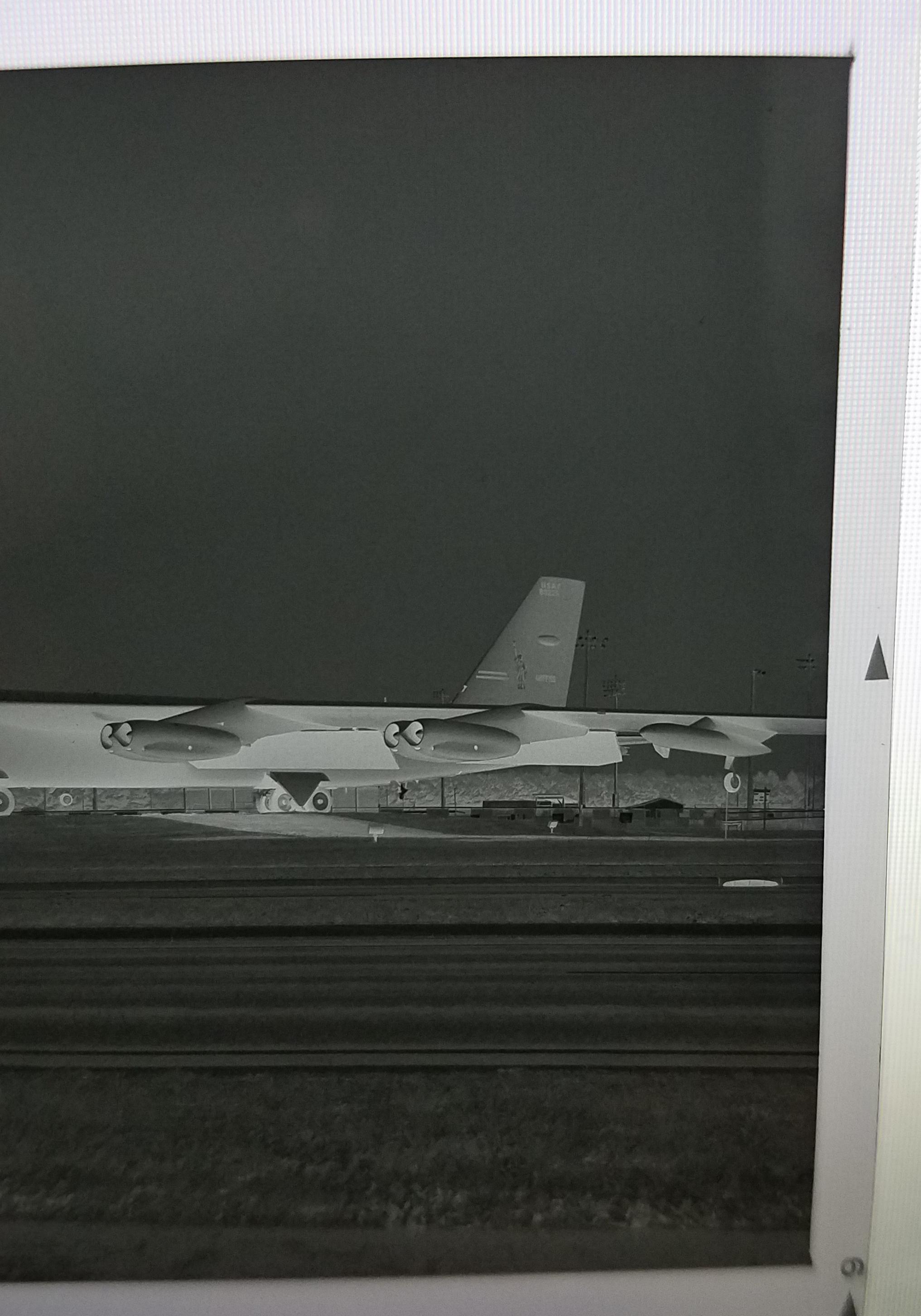

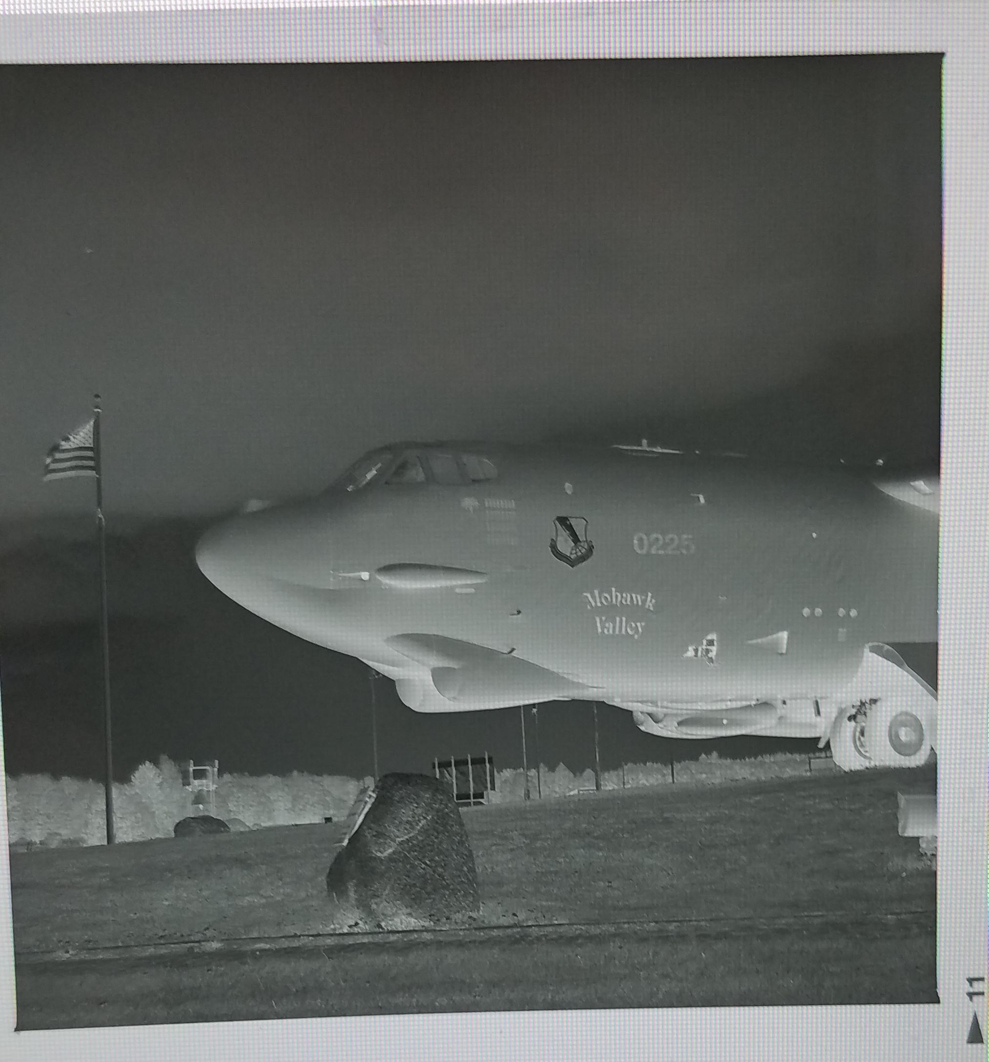

I want to thank everyone for their thoughtful inputs to my problem.
I scanned the images again, changing the orientation in the scanner. The artifacts did not change, still on the same edge of the negative.
Then, using my monitor as a lightbox I examined the negatives . . yep, the artifacts are on the negative.
So, Occam's Razer applied here; I must have ham-fisted the developing process somehow. I use the Patterson plastic tank that holds either two 35 mm or one 120 roll. Either the spool slipped on the spindle, or I did not fill the tank enough, I suspect the former.
PLEASE, critique my negatives. What would you change?
Which version of the Paterson tank - the older ones with the (usually grey) cap, or the current Super System 4 with the flat black top that goes on like a Tupperware lid?
And how much developer are you putting into the tank?
koraks
Nov 29, 2018
26,731
Europe
When inserting the loaded reel into the tank, check religiously if the reel is slid all the wat to the bottom collar of the spindle.
Do inversions somewhat cautiously.
Use a little more chemistry so that the reel is covered with half an inch of fluid on top of it.
That should prevent this from happening, I'd say.
John Galt
John Galt
Mar 8, 2017
357
Rivendell
Hmmm, MattKing not sure it actually is a Patterson tank now. It does not say Patterson on it anywhere. It says made in Spain on the bottom. It has a red plastic lid. It does not leak which is why I uses it, I got it in a box of used dark room stuff at an auction. It is my Go-To tank.
The quantities are embossed on the bottom of the tank, it calls for 20 oz for a single 120 roll, I usually use 22 oz to be safe.
removedacct1
Nov 12, 2014
1,875
97333
John,
I'm glad to hear the scanner isn't to blame. If the artifact is on your negatives, then its likely a problem with developer volume. Good luck!
John Galt
John Galt
Mar 8, 2017
357
Rivendell
Thanks koraks, I am probably a little on the aggressive side with my inversions. I usually uses a few oz more than called for. I will be more careful to check that the reel is actually bottomed out in the tank and be more gentle with my inversions :smile:
MattKing
Apr 24, 2005
55,080
Delta, BC Canada
That is probably an AP/Arista/Samigon/??? tank that is sold by a number of vendors under their own name.
Either one of these (Arista Classic at Freestyle): https://www.freestylephoto.biz/5031-Arista-Classic-Double-Reel-Developing-Tank-with-Two-Reels
Or one of these (Arista Premium at Freestyle): https://www.freestylephoto.biz/5041-Arista-Premium-Double-Reel-Developing-Tank-with-Two-Reels
If it is the "Premium" version, there is a reel retaining clip that can be used with them to keep the reels from sliding up - one of these, also available from Freestyle: https://www.freestylephoto.biz/5504...Plastic-Reel-Clip-for-Premium-Film-Developing
