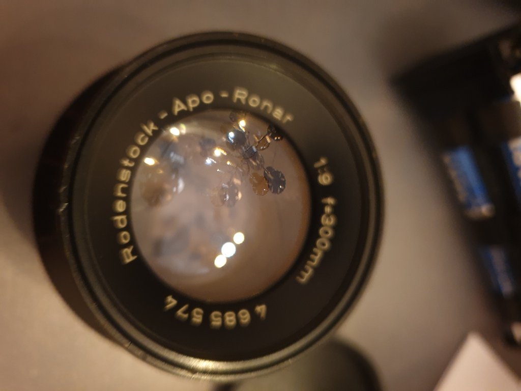

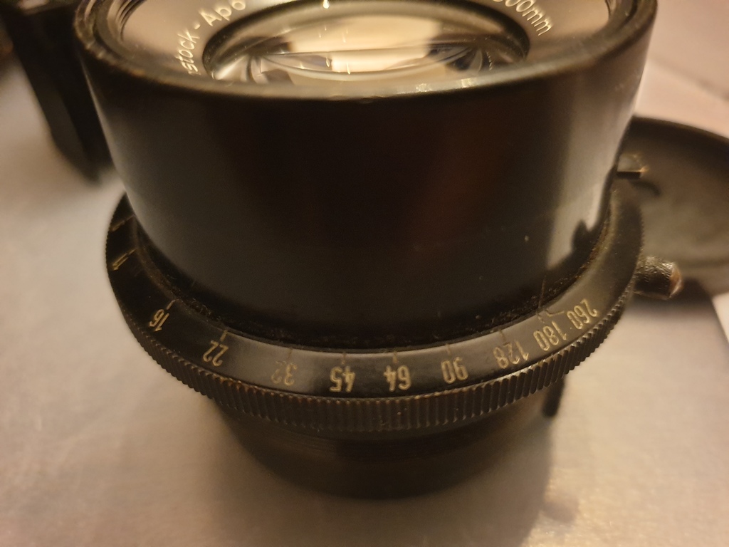

I've received this lens from a friend today. He said something like "enlarger lens".
But this seems not to be correct. f/9 doesn't seem to be that fast, and which enlarger lens needs to be stopped down to f/260??
What is the use of such a lens?
regards,
chris

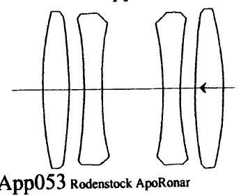

What makes it special is that is of absolute symmetrical design. In contrast to enlarger lenses.

Ok. Thanks. But maybe I need to rephrase my question:
I understand "macro work" and see the general usefulness of being able to stop the lens down to such insanely small apertures. Is this one reason for these small apertures? And doesn't diffraction work against picture sharpness then?
But what exactly is a "process lens" or "process work" ?
regards,
chris

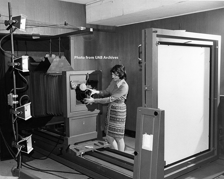

Process Work means Repro Photographie in a print shop

Your lens is at the short end of the scale. Most horizontal process cameras were immense. Small ones took 16x20 film, bigger 3x4 foot film and larger.
https://en.wikipedia.org/wiki/Process_camera
