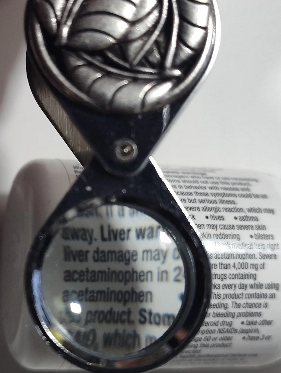

I'm looking into getting a necklace with a magnifier to be used for focusing a 6x9 ground glass. What magnification strength would be most useful? I have decent eyesight.
So far I've noted:
A typical TLR magnifier is 3x, so I probably want more than that - at what point does the magnification become too much?
I want to be pretty close to the ground glass when I use it in order to block stray light from dulling the image
I might want something all-purpose that doesn't need to be touched to the ground glass and which can be worn comfortably all day
Not sure how practical these things are, but would something like this with a strength of 20x even be useful for the purpose?

The type of magnifyer you show os very useful for checking the corners as well as the whole ground glass. Loupes cannot get into the corners. A magnifier made for coins should be fine.

This is a magnifier, a tube with lenses on top and that you have sit on the ground glass itself. It's a small diameter- 1-1/4 or 1/2 inch- so it can move around most of the screen.
