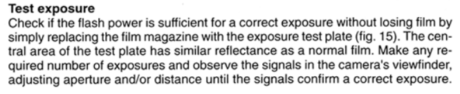

It's mentioned in the D-Flash manual as a way to check exposure without wasting film. There are no pictures nor discussion of it that Google or Kagi can find, which is wild, and I can't imagine how it would work.
Does anyone know anything about this thing, or even better, have pictures?

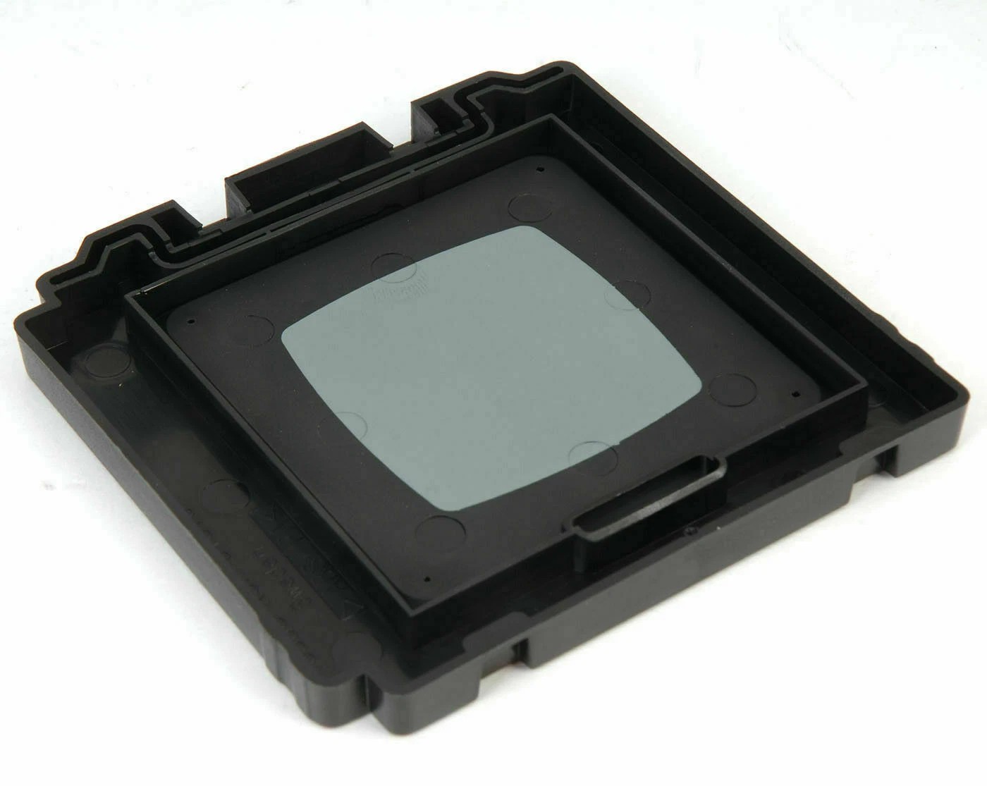

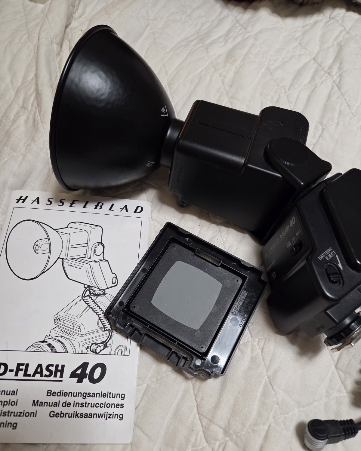

It's a body back cover with a gray finish for testing the TTL flash before actually exposing the film. Like a 18% reflectance test card

Wild. So it’s just a test target for the OTF sensor. I was imagining you somehow looked through it.
I always wondered if this would match up to actual film. This would sure help if you were doing some sort of macro work. Probably would need fancier flash. The flash is almost certainly Sunpak, it's a nice flash, I never use (but I'm ready!)

It is for TTL flash exposure testing. The grey is the same reflectance as film. With TTL film, the sensor in the body measures the flash reflecting off the film during exposure, and shuts off the flash when the correct amount of light has been detected. To avoid exposing film for testing, you put of the body cap. An all black body cap would not reflect the correct amount of light, so the exposure would be more.
You can tape some grey material to your existing body cap to do the same thing.
