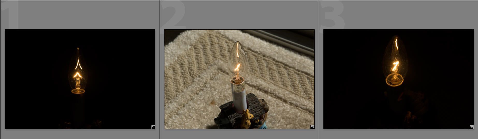

There seems to be a fundament lack of comprehension of the issues involving shooting lava at night on a boat. So let me substitute an electric light bulb with visible filaments in lieu of the lava, and put that light into several very different ambient light conditions, and take photos.
  1. Light filament measures (with reflected light one-degree spot meter) ISO 100, 1/4000 f/11
  2. Ambient light in shot 1 measures ISO 100, 1/30 f/2.8 with incident meter (indoors)
  3. Ambient light in shot 2 measures ISO 100, 1/100 f/16 with incident meter (Sunny 16)
  4. Ambient light in shot 3 measures ISO 100, 1/2 f/2.8 with incident meter (dimly lit indoors)
All shots below were exposed at a fixed ISO 100, 1/500 f/11 (-3EV below what was metered for the filament):
If you are interested in seeing the filament (or lava) glowing red hot, you do not shoot it as suggested per bullet 1 -- or the spotmeter reading of the lava!
If you are interested in seeing any surrounding detail (detail which is not the filament itself) it is very dependent upon the brightness of the surrounding AND the shutter speed and aperture suitable for that light level
The reading on the incident meter measurement has no direct bearing on the measurement of the filament! The reading on the incident meter measurement has no direct bearing on the measurement of the lava!
If I adjust my exposure for ambient light situation, I screw up my exposure of the filament or the lava!
  • If you SHOOT FOR THE FILAMENT, there is NOTHING than you can do to render the surroundings visible/invisible, you are at the mercy of the RELATIVE DIFFERENCE in brightness between the filament and the surroundings.
  • If your primarly interest is to capture glowing red lava, there is NOTHING than you can do to render the surroundings visible/invisible, you are at the mercy of the RELATIVE DIFFERENCE in brightness between the LAVA and the SURROUNDINGS.

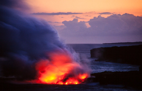

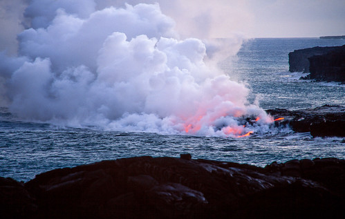

This discussion motivated me to post my lava flow photos online. I was in Hawaii in July and took photos from the official viewing area (reached by bike ride). Though that was in the evening with Velvia 50 slide film and a tripod. The first photo was taken when it just became dark enough to clearly see the lava. At those light levels you will probably be OK on a boat with ISO 400 film. Having a lens with image stabilization will be an extra bonus.
The second photo is from the end of my shooting session when the brightness of the sky and the lava matched pretty well. That would be too dark for handheld shooting with a long lens.
For metering, I used the partial metering mode of my Canon EOS camera (that's a somewhat larger measuring area than spot metering tends to be). For the first photos, I measured the white smoke cloud and placed that at about +1. And then later when it was darker, I measured the lava glow and also placed it at about +1. My concern with slide film was not to blow out the sky. So I also measured that to figure out how much and what area of the sky was safe to include.
