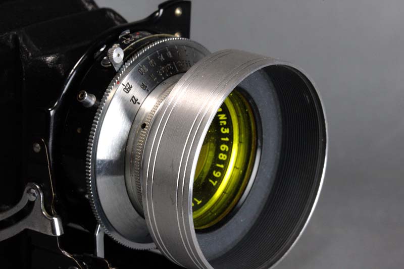

You might be able to find a suitable push-on adapter, either to a series filter (which are admittedly a bit thin on the ground of late) or adapt to a standard filter thread large enough to work. I have a rig that adapts my Ercona II (East German Ikonta) for Series VI filters. And I've no idea how old some of the filters I've seen actually are, but some relatively old ones are still in decent shape; I think it depends a lot on type of filter and also how it was stored.
attachment.php

Kodak Series adapters may be the way to go. For my Perkeo II folder I use a Kodak Series VI adapter ring over the lens. The adapter ring has a 44mm outer thread, but there are not many 44 filters out there. I found a 44-49mm step up ring so I can use modern 49mm filters.

Homemade? That looks like a good idea. The lens seems a little prone to flaring, and I sometimes like to use a yellow filter. Series vi filters are a lot easier to find!
Actually not homemade; it's a genuine "Kodak Series VI Adapter Ring 1 15/32 In. - 37mm" push-on device that I had to machine the tabs down a little in thickness to fit in the groove, as well as create a notch to clear the top of a pesky setscrew that pokes into that groove. There's some shots in the 3rd row in my Ercona II gallery that show the handiwork such as it is.
A question in another thread has me wondering about something to screw on the outside and adapt to standard filters, but it's not a priority, as I don't use that camera a lot to begin with.
Funny, upthread I mentioned the 37mm push-ons get into Bessa collector territory. A while back I found a guy in China on ePrey who offers newly manufactured lens shades in the near-exact style of the Voigländers for about $25. I bought one and found the edge that has to push into the groove in the Ercona is a bit too thick to fit. :sad: I may eventually do it, but the part, brand new, is so gorgeous I hate to apply cutting tools to it!
