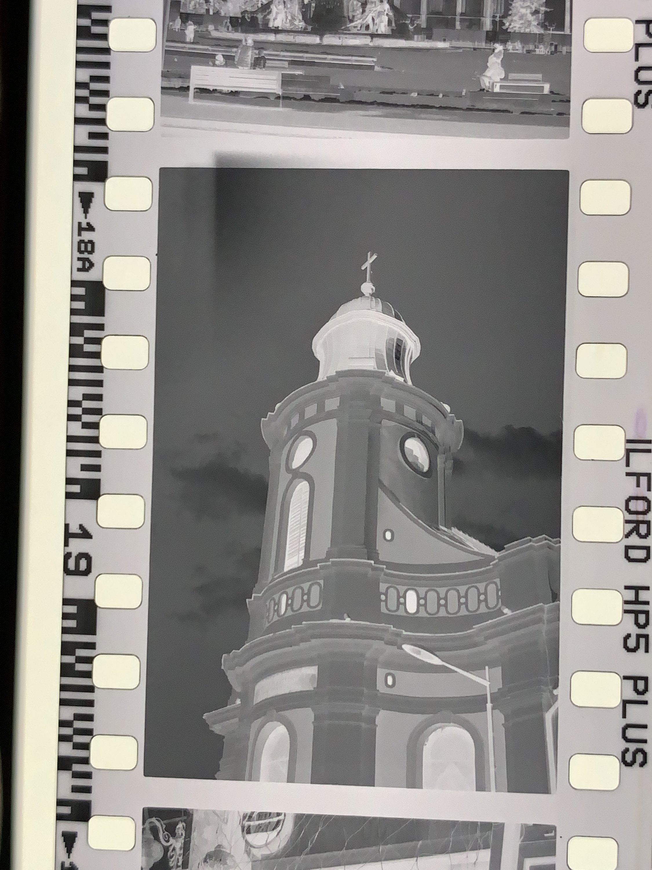

Does anyone know what that could be? I developed using 1+100 Ilfotec HC (3ml + 100ml water) for 90 minutes with one inversion midway. All the other photos on the roll look fine.
I would’ve suspected that the end of the roll touched this part of the negative on the reel, but that’s impossible since this is position 19. Could it be some sort of light leak or reflection? That would also be unusual because I have not seen it on other negatives including this roll.

That is a light leak. It may be the sort of leak that only reveals itself infrequently, when bright light hits the camera in a particular way.
What type of camera is it? Is it one with a little window in the back that shows the film cassette loaded?
It's a Nikon FM2n. I think you're right. It does look like that part was exposed to light. The fact that it also reaches outside the frame confirms it even more.

I'd check the usual suspects: the seals on the back, especially around the hinge, and the pressure plate to see if it's properly springy and holding the film nice and flat.
Ah, yes. You are right. It was a typo. It’s actually 300ml water and 3ml HC, so 1+100. I am going to edit my post.
