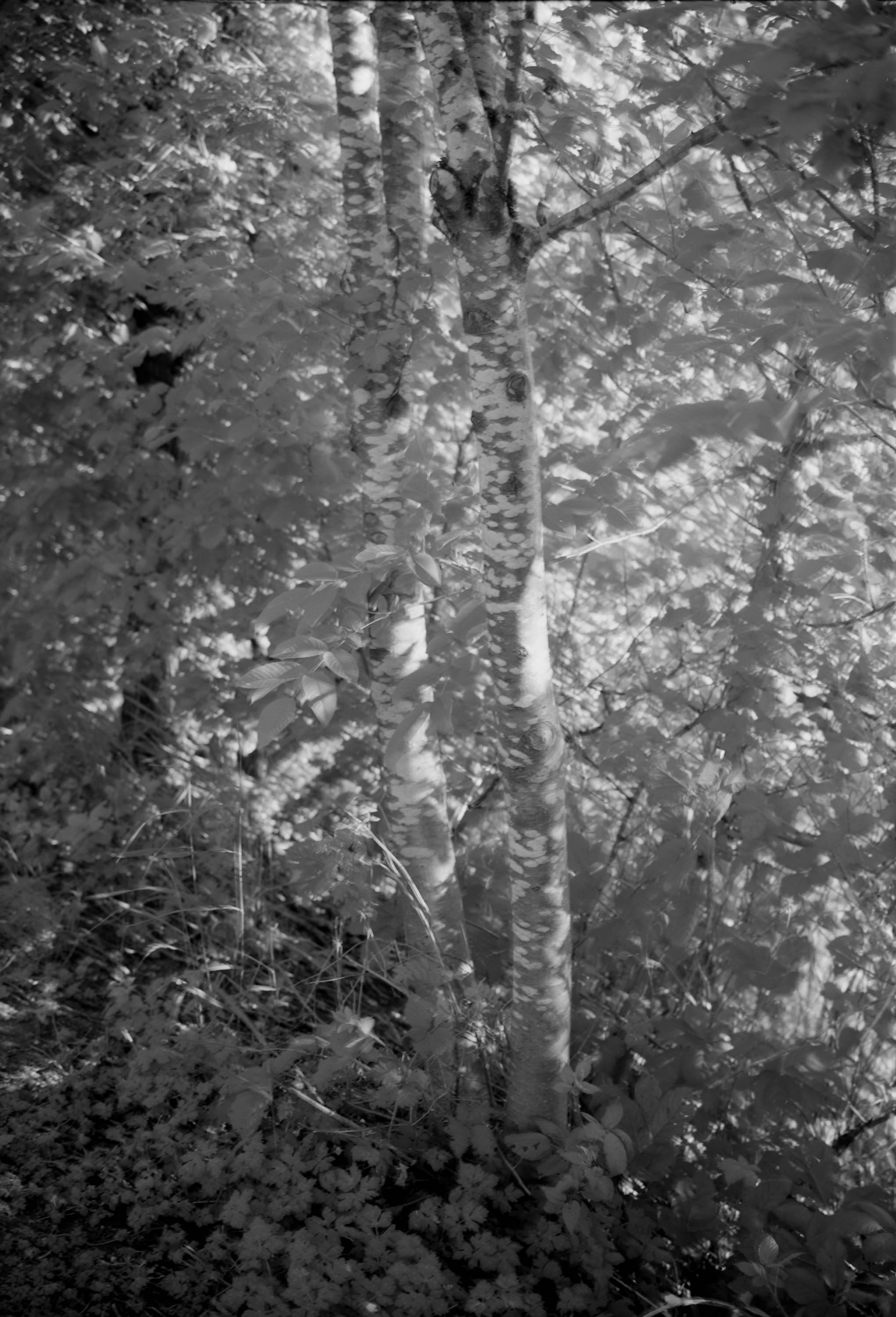

As mentioned this film is aerial film with a string S curve. Unlike Rollei Retro 80S, which is the same film, 25 is more like the actual speed for ground level photos. It's not yet available in 120 or 4x5 due to difficulties slicing PET base, but if you shoot 35mm, the better film is ADOX Hr-50. That is again, Aviphot 80, but ADOX has applied a proprietary "speed boost" which gives it a smoother curve for pictorial subjects. Here's a recent shot of mine in this film

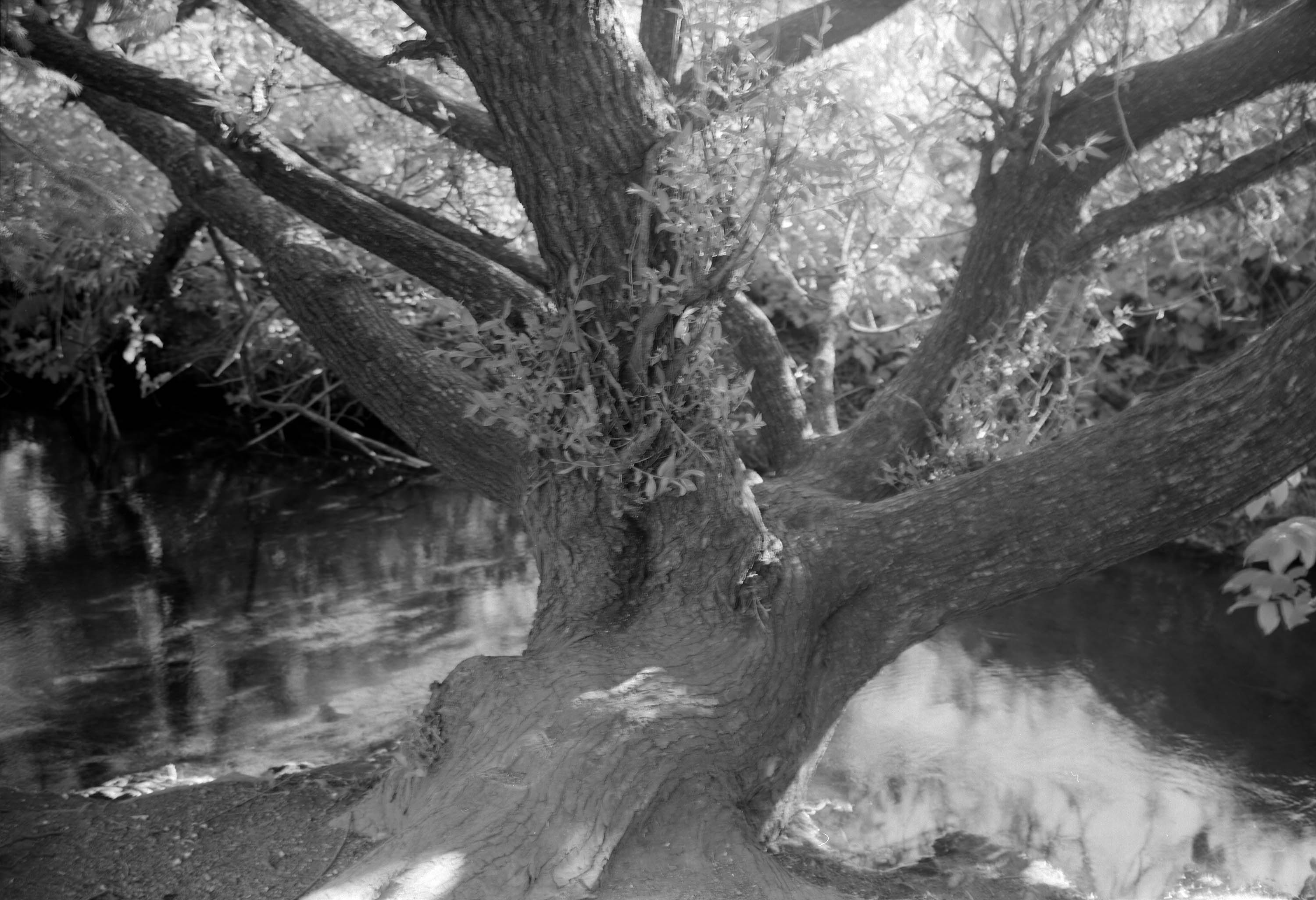

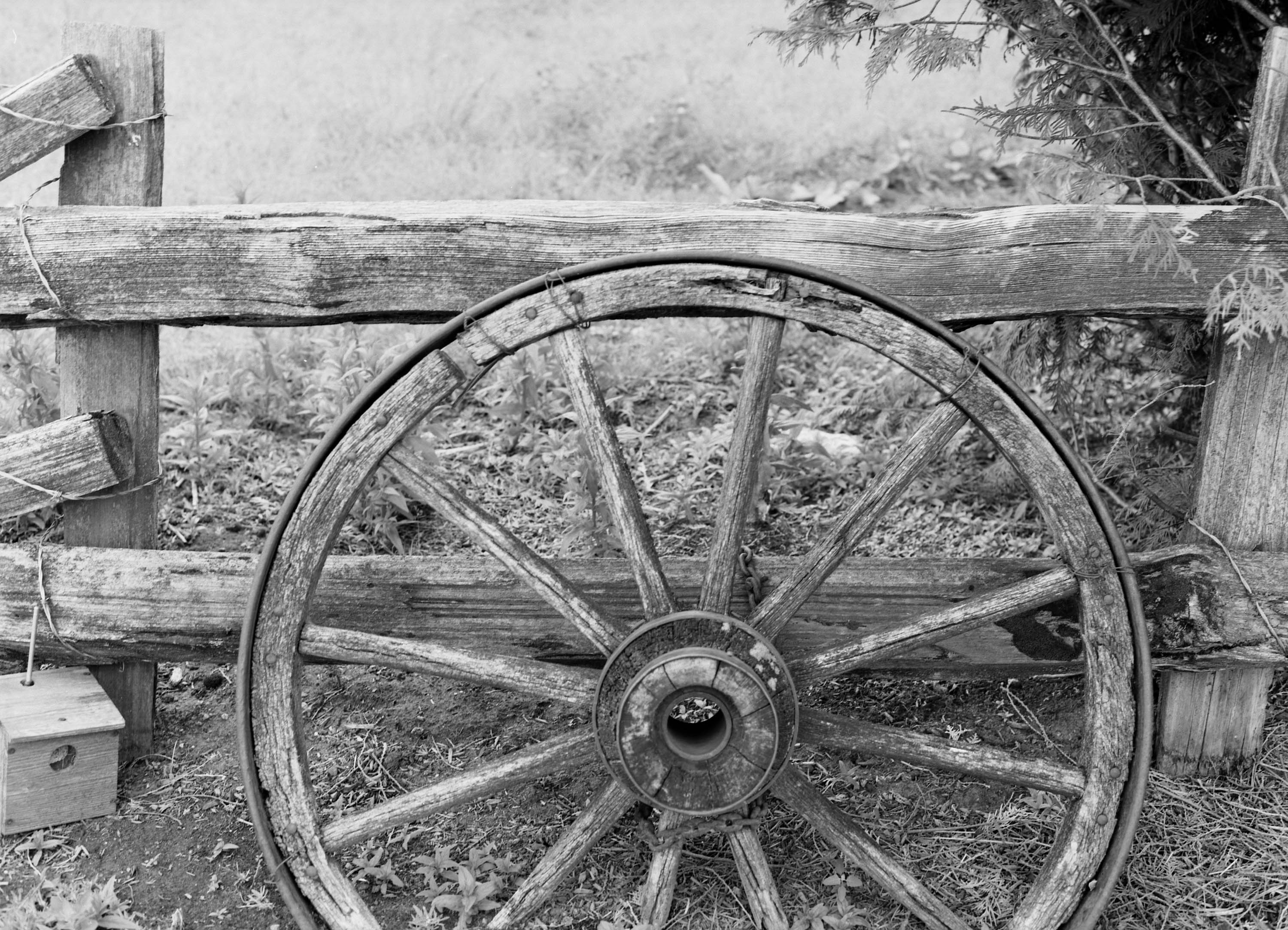

These shots dont look too bad. Not a lot of tones in this film compared to other B&W I've shot recently, including TMAX 400. These pictures were taken in a shaded area in some of them, with the sun peaking through. Shot on my Fuji GW690 camera.

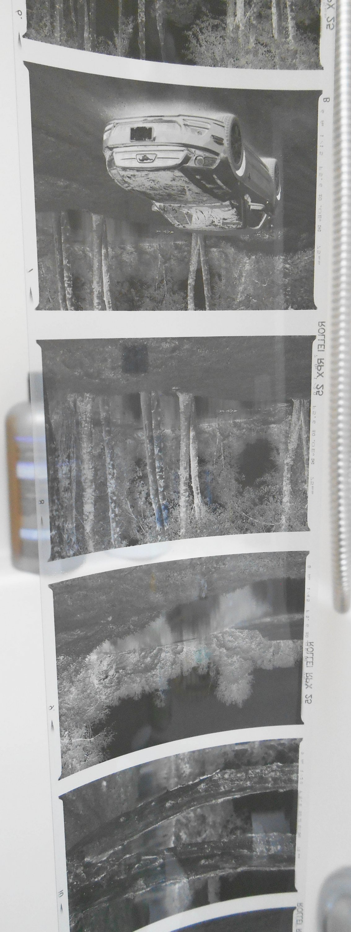

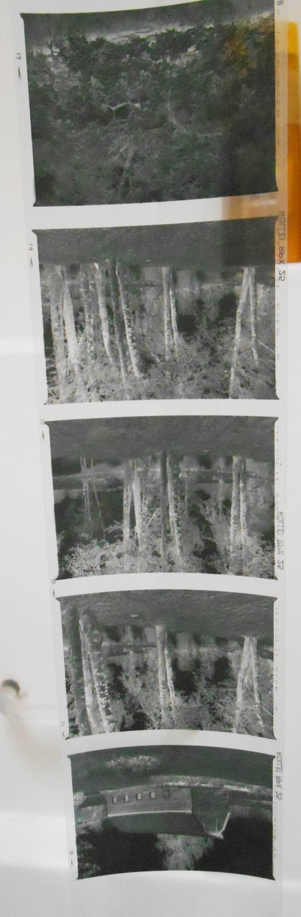

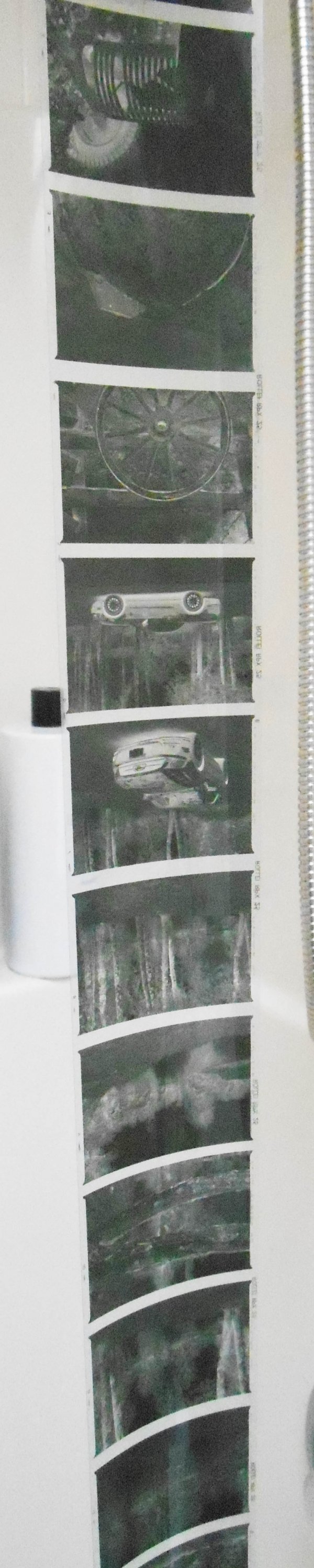

Film is drying. Here are the raw negs before scans.

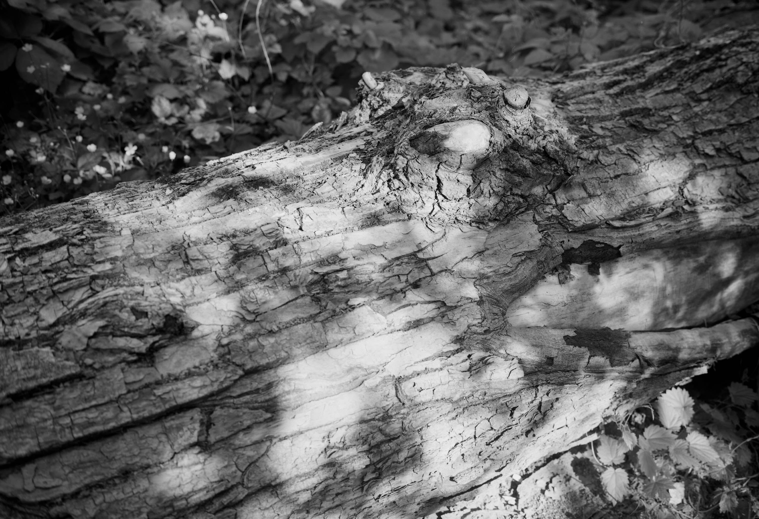

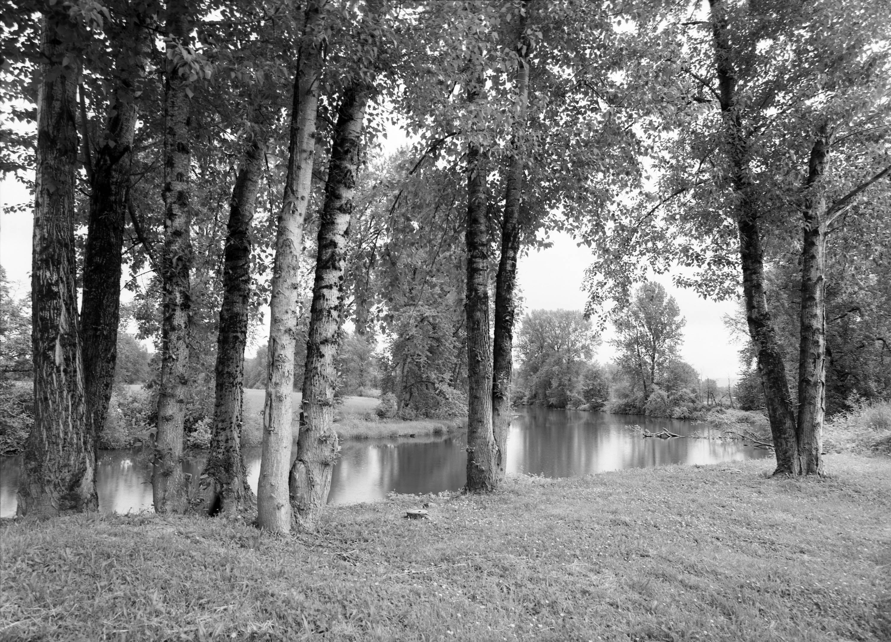

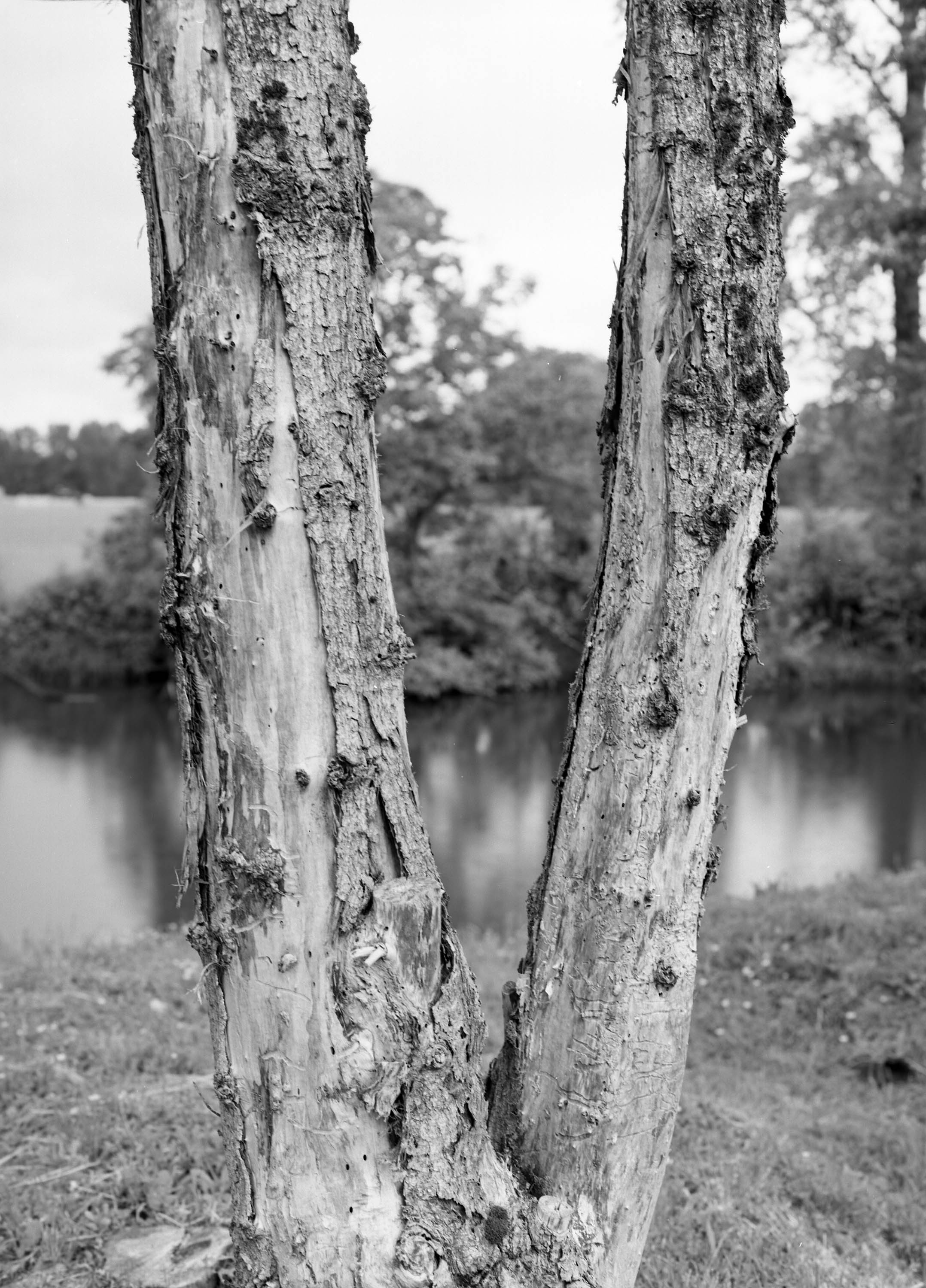

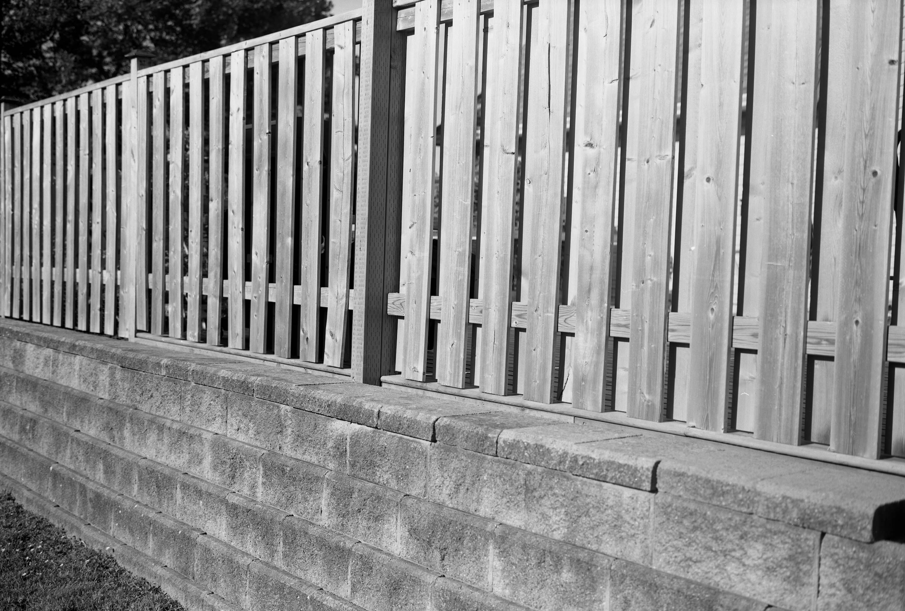

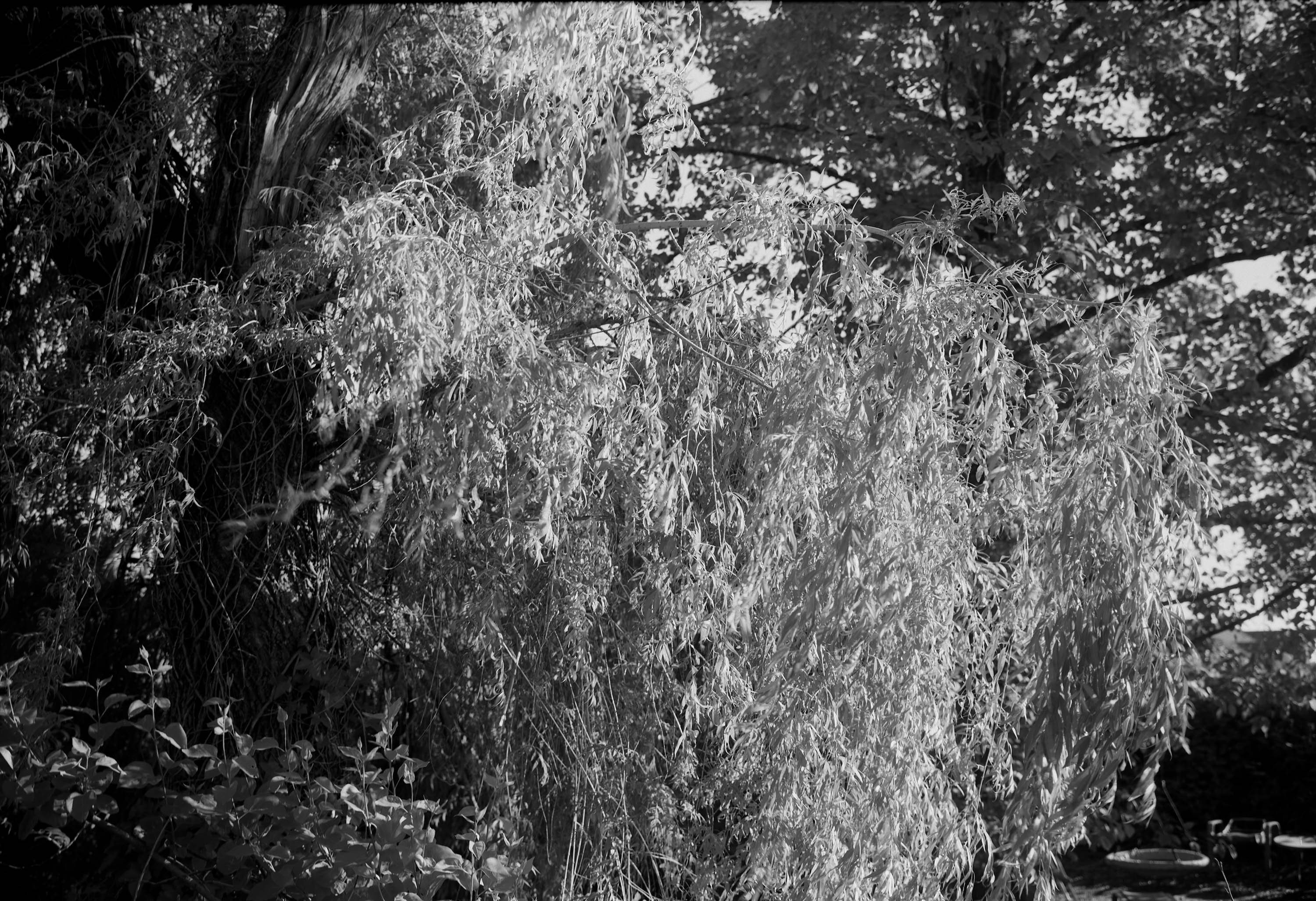

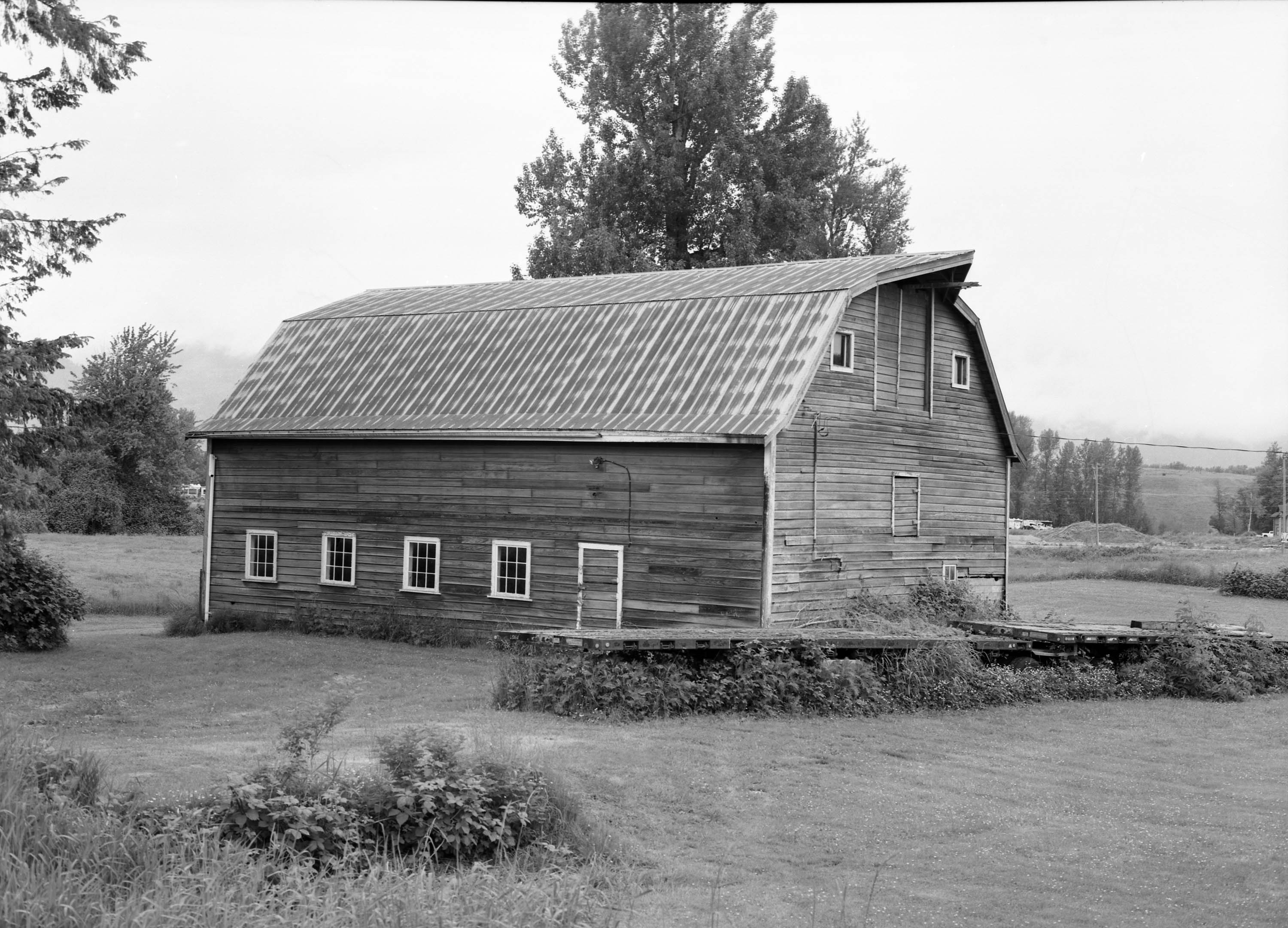

Here are the samples off my 645N camera today. I notice with this film, the midtones arent very good compared to other film types of this speed. It seems rather bland in the midtones (or lack of a lot of different midtones).
I wonder if the bland midtones could be due to the extended red sensitivity.
I'm not sure how you'd negate that... A cyan filter?

It is an aerial film.
Which means it is designed to maximize that mid-tone contrast, usually at the expense of shadow and highlight rendition.
If you develop it to bring in the shadows and highlights, the mid-tones go blah.
I doubt it has to do with that. I know other films with extended red have really good tones. I think it just is mixed only for aerial photography and not for general photography.
The origin film, Aviphot 80, is IR sensitive. From the graph in the link, green foliage (grass, trees) reflect IR strongly and appear lighter.
That is what you see. BTW, what EI and developer were used?
