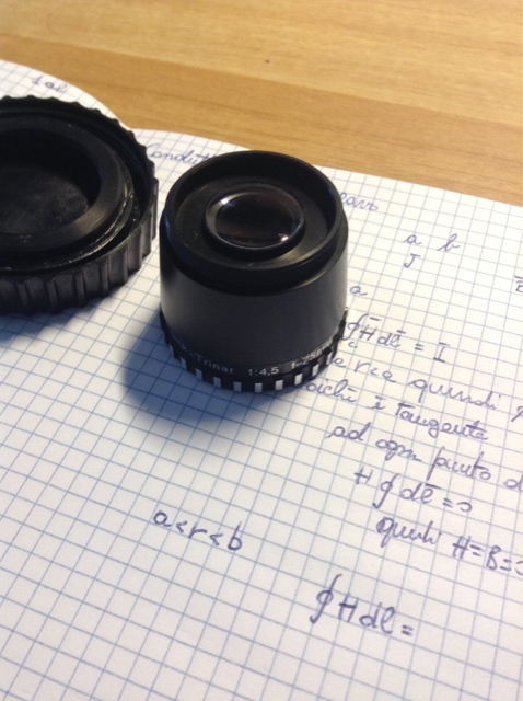

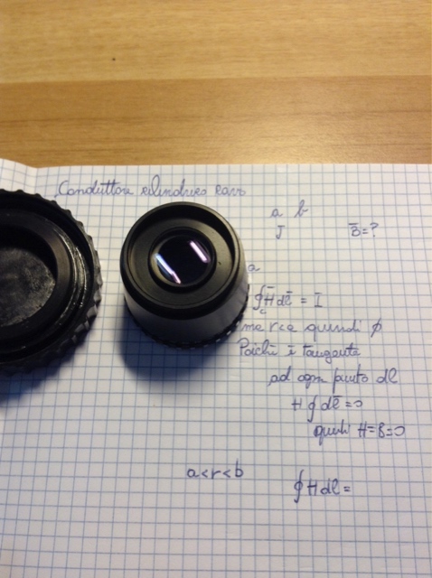

I wanted to start printing from my 6x6 negatives and, for such occasion, I bought a simple Rodenstock-Trinar 75mm.
On e[...], the item's description says "standard mount".
Isn't the standard mount 39x1?
When I bought my Meopta Opemus 6, I found that the 50mm lens of my older Durst F30 would fit on the new enlarger but this lens it's smaller. See photos attached.
What else should I buy? ImageUploadedByTapatalk1421058138.964340.jpgImageUploadedByTapatalk1421058170.761647.jpg

Note that some enlarging lenses use an M23.5 thread. I suggest you confirm the size before purchasing an adapter (I don't know about the Trinar specifically; it may be that Steve has better info). If it is M23.5 then you may be able to find a suitable 23.5mm lens board for your Opemus 6 since some of the Meopta enlarging lenses have an M23.5 thread. I have a 23.5mm lens board for my Opemus 5, like this one.
You might consider buying a better enlarging lens in the standard 39x1mm thread rather than adapting the lower quality Trinar.
My understanding from the original post was that the enlarger had the 39mm thread and the lens had a smaller thread.
Steve.
I also thought the same as you when I first read the post but then I looked at the photos of the Trinar lens, the rear mount of the lens looks to be too big for 25mm plus it looks exactly like the dozens and dozens of enlarger lenses that I sold during the 70'-80's. I then re-read the post and I now preceive that he meant that the enlarger opening is too small. Zehner21, can you measure the opening in your enlarger to give a better understanding of what diameter size lens you need, you may need a 25mm size mount lens or even some other size besides 39mm. Most hobby enlargers made in the last 30 years had the mount size as 39mm but some had no standard size at all. Some hobby enlargers used lens mounting plates while others were just odd sized openings. (odd sized by USA standards, the size may be perfectly normal in whatever country the enlarger was made/sold) A few photos of the enlarger opening would also help. It is entirely possible that I'm way off base with my assumptions, OP please correct me if I'm wrong. RandyB
Yes, a 75mm is not suitable for full frame 6X6. You need 80mm to get the corners.
You could get a Rodenstock Rogonar 75mm lens which is the standard 39mm thread and should be inexpensive. I've used one in the past to print 6x6 and found it to be acceptable. If you do look for one, make sure you shop around to get the best price as some sellers think these are worth more than they really are. Minolta also made a 75mm, again with the 39mm thread, and it should also be inexpensive. Another one I have used is a Komuranon 75mm which is a six element design, but is not expensive. There are a number of 80mms around which are worth a look. The Durst branded versions are good, but be careful about the mount size with these as at least some versions use 25mm rather than 39mm.
