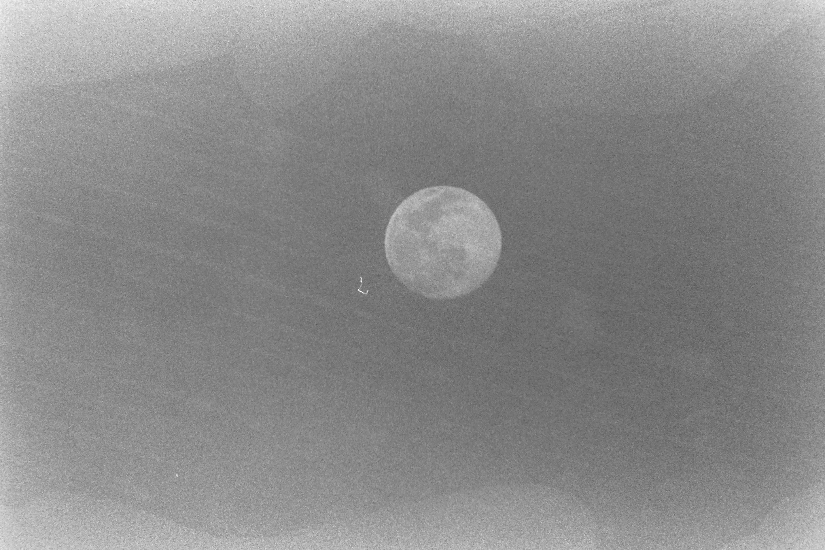

Here are two images I made in 1985 during the last apparition of Halley's comet. These are about 45 sec. unguided exposures made with f/1.7 50mm lens and processed in D-19 (2475, Halley-1) and D-76 (Tri-X, Halley-2), if I recall correctly. Both images are almost full-frame, viz. scans of about 80% of the 35mm frame.
The exposures were made on a moonless night with a clear and cold New Mexico sky and no exterior lights to interfere by brightening the sky.
I believe the 2475 was about ten years out of date at that time and had been kept frozen until use. I post these here just to add interest to the discussion.

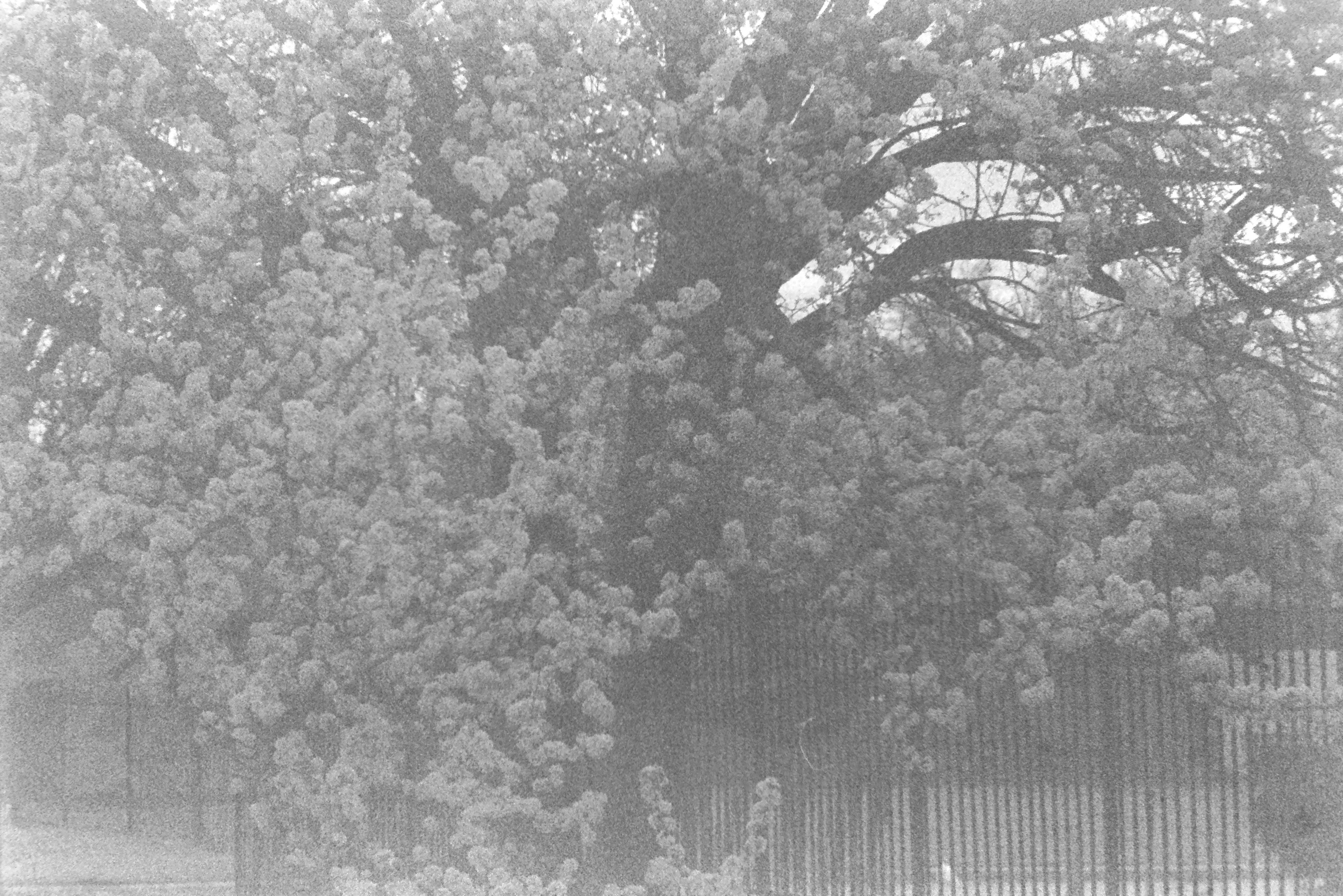

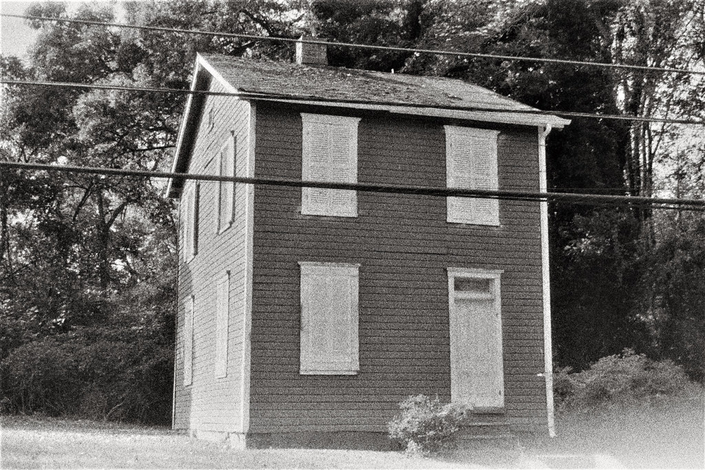

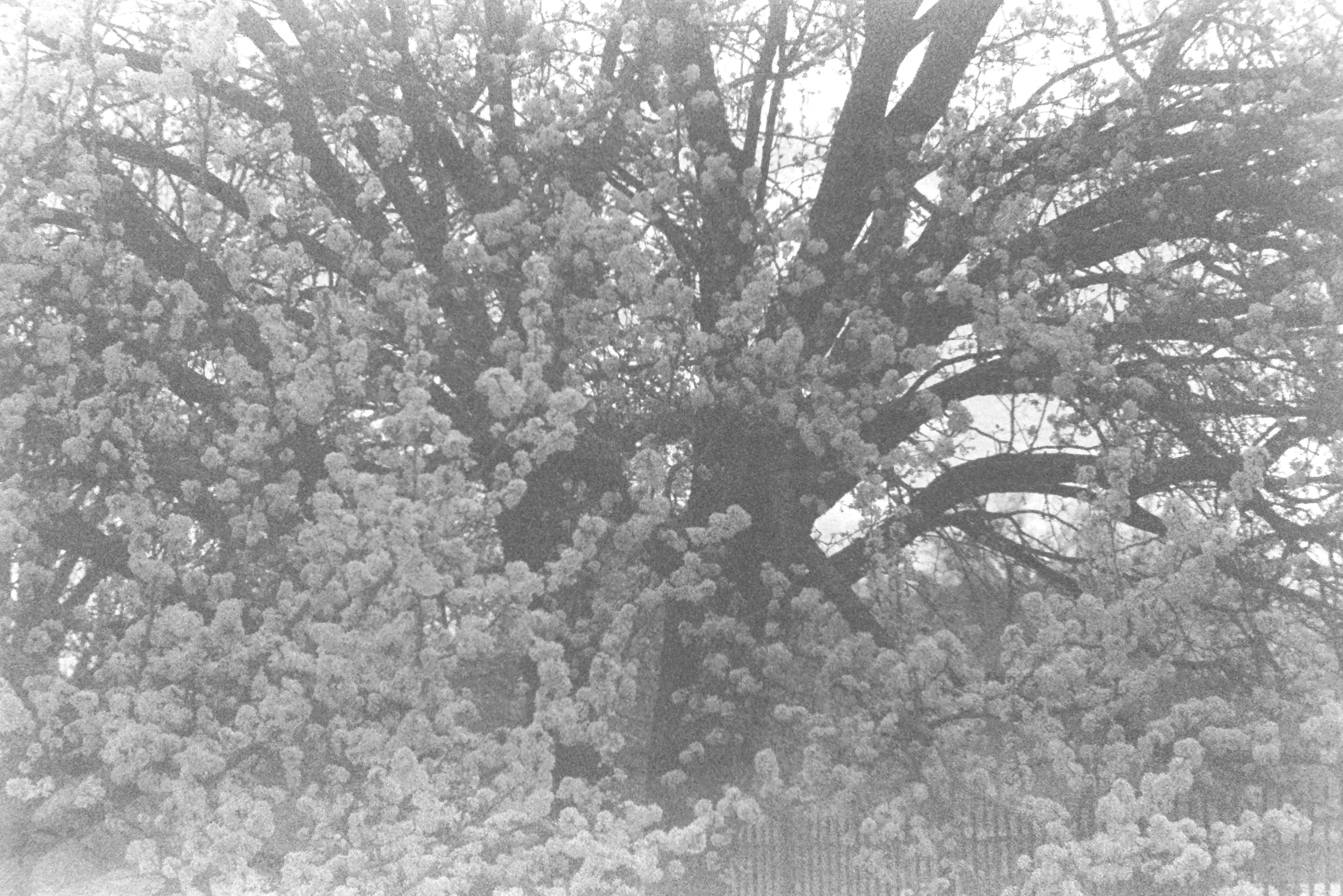

Yes, I realize, kind of an old thread, but I found some expired at 1976 2475 in the bottom of my freezer and I couldn’t resist giving it a try and posting the results. I walked through the neighborhood with it loaded in my Yashica TL-Electro, metered at ISO 50 to blast through whatever fog there might be, developed normally at 8 minutes, 70 degrees in HC-110B.
I expected a strip of black film, but the base fog wasn’t too bad and images were easily visible... I was stunned! Here’s an example, scanned with minor adjustments:
Looks very good for a 45 year old roll of film. It probably recorded some cosmic radiation that increased the grain a bit.

Very nice, good plan to shoot at 50. What great grain!
Thanks Bill! What surprised me was the base fog wasn’t as bad as I expected and the grain pretty much looked the same as I remember from when I used it regularly 40 years ago. It’s definitely something I’ll be experimenting with more, I still have four or five rolls left.

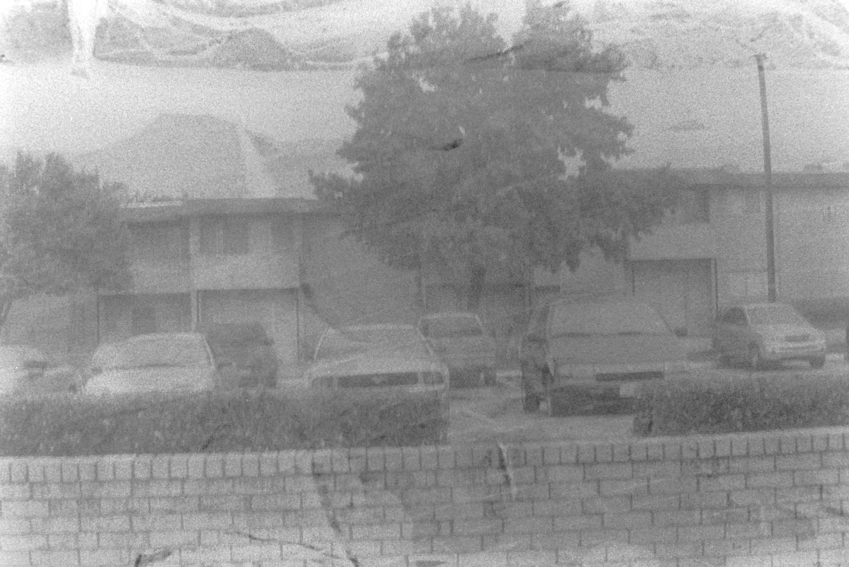

I am the OP back after 11 years, finally exposed the rest of this same roll at EI 1600, developed in DK-50 stock 4:45 (72F)
actually got an image on the film (!), even after 11 more years of frozen storage. should have exposed at 1000, the shots i took present day are much harder to make out from the physical damage
the first part of the roll i'd shot in 2011 was exposed at EI 1000

the first one was taken in 2011, at EI 1000, #2 in 2022 also at 1000
third one was exposed at EI 1600 and that was honestly the best I got at that value, the rest started out like #4 and i think i accidentally tried to expose at EI 3200 on some of the other frames, was practically unusable due to emulsion damage

Thanks, well positives show plenty of grain and adequate photographic detail.
It might look good (and grainy) at 400, which could make for a fun project.
