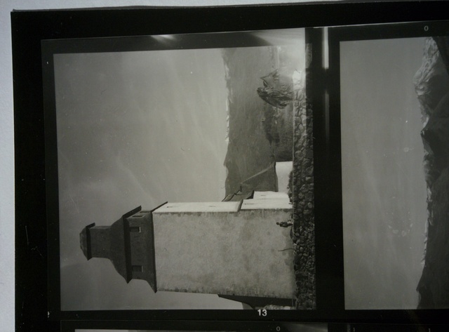

I made some 6x6 films with my Minolta Autocord, which I developed myself, and I have a kind of veil (I think), but I do not know if it's due to the development, or to the camera, with a defect of foam seal, causing a light leak. But if it was the camera, it should be the case for all the views, right?
I developed at the same time 2 films Arista EDU Ultra 200 in HC110, solution H, 1 + 63, in 9 min, fix in 10mn. One of the films is correctly developed, flawless. The other presents a kind of veil in the lower right corner (next 2 pictures):

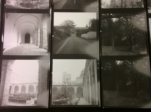

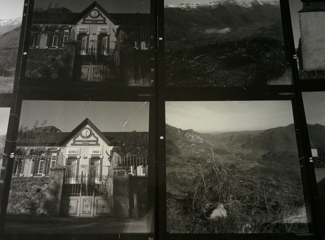

And also an Arista Edu Ultra 100, with again a very regular wave-shaped veil:
Would you know what could be the problem: quality of the film, quality of the joints of the Autocord (light leak), or development problem, or other?

Light leak - either in the camera, while developing or as a result of film handling.

Don't think the camera, but the roll of film could have been loosely wound on the spool when taken out of camera and the sun got to it or film was incorrectly loaded on a reel for development.

Definitely a light leak from somewhere... Interesting that the shape of the light seems similar in each picture but they don't seem to be evenly spaced, which makes me think it's not the camera (but could still be).
As some negatives have come out fine, I'm leaning towards the film rolls affected not being tightly enough wound when not in the camera and a bit of light has got in.

The curved area the impinges on the image looks like a processing defect. What do the negatives look like.
You also have a light leak form between the spool end and the paper, but that does not impinge on the image and it is small, it is only on the rebate.
If the film is 120, while it is in the camera, the film gate prevents stray light from exposing the rebate. The rest of the time, the spool is light tight on each side of the film gate.

looks like your spool wasn't tight or the film unloaded in bright light...
was it tight and put back in a box or foil or kept out of the light
when you removed it ?
or when you LOADED IT was it in subdued light ?

Looks to me like a light leak that happened as the film was rolled up, so more likely was loosely rolled after being shot. If it happened in the camera, I'd expect to see it in exactly the same position on each affected frame. Is it worse on one end or the other of the roll?

Light leak, probably from the film not tightly rolled. Do not use a rubber band because that will leave a mark on the negatives and result in another thread about a new problem.

light leak at the top left on your camera back.

I've just developed a new film, again ARista Edu Ultra 100, and there is no issue on this one. I took very careful when I removed it from the camera.
So, let's wait the next one...
