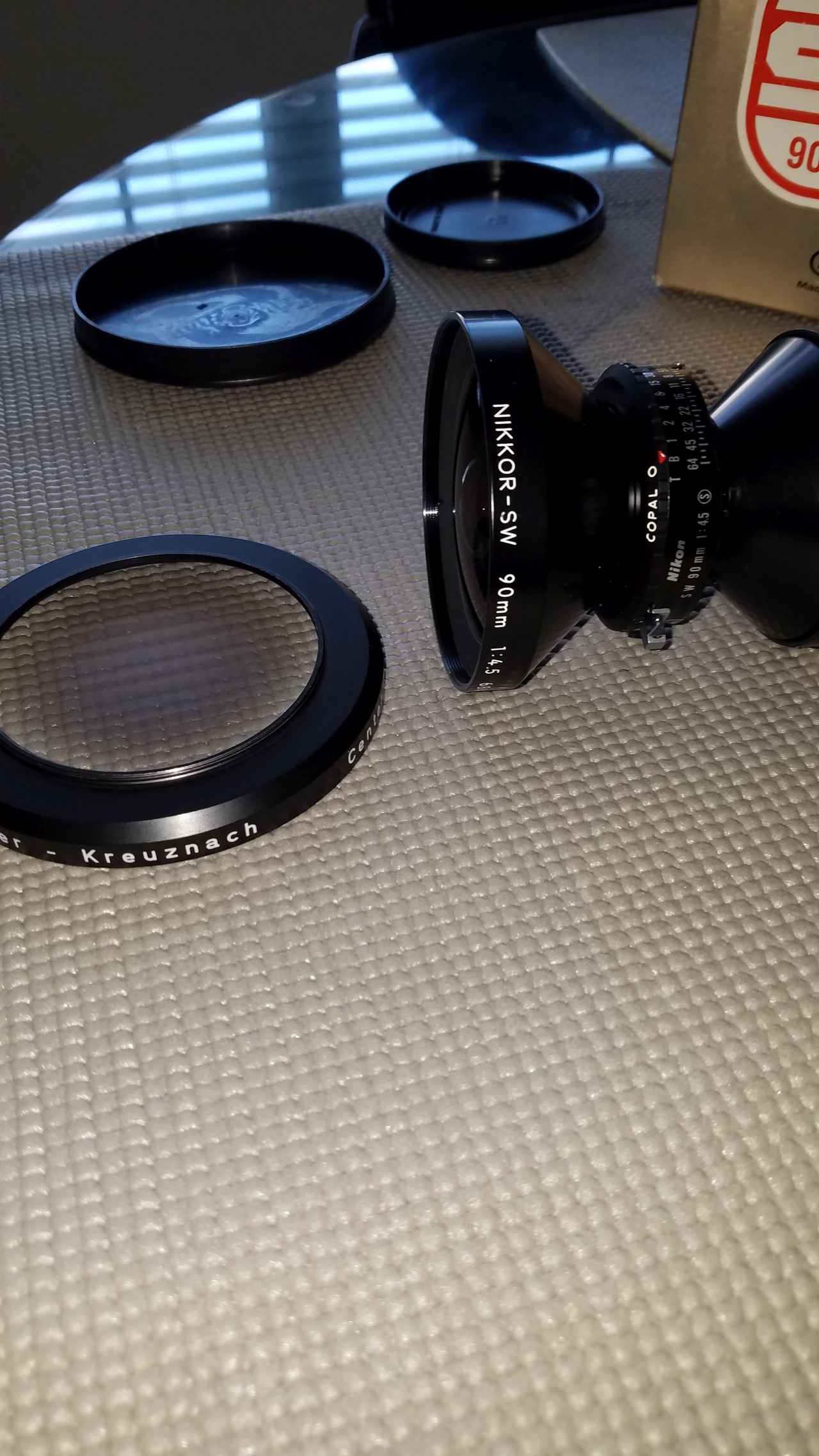

Thanks JIm. For whatever it's worth, I already got 75, 90, 150 and 300 lenses for my 4x5. I have a CF for the 90 but seem to be favoring the 75 for shots. The 90 is a bright Nikkor SW f4.5 with Schnieder IV CF. The 75, 150 and 300 can take my existing 77mm filters on adapters that I have. The 90 can't and would require a new set of much larger BW contrast, polarizing and grad NDs to fit the 105mm CF threads. I like what the 75mm is giving me and seem to favor it so I might get rid of the 90mm and CF and not bother with a replacement. You want to buy my 90mm? :smile:
The scratch has nothing to do with wide angle cosine failure. It is pure physics. Shoot a light colored evenly illuminated subject, white sand beach, clear sky, etc. that goes from edge to edge and corner to corner. The falloff is there.
