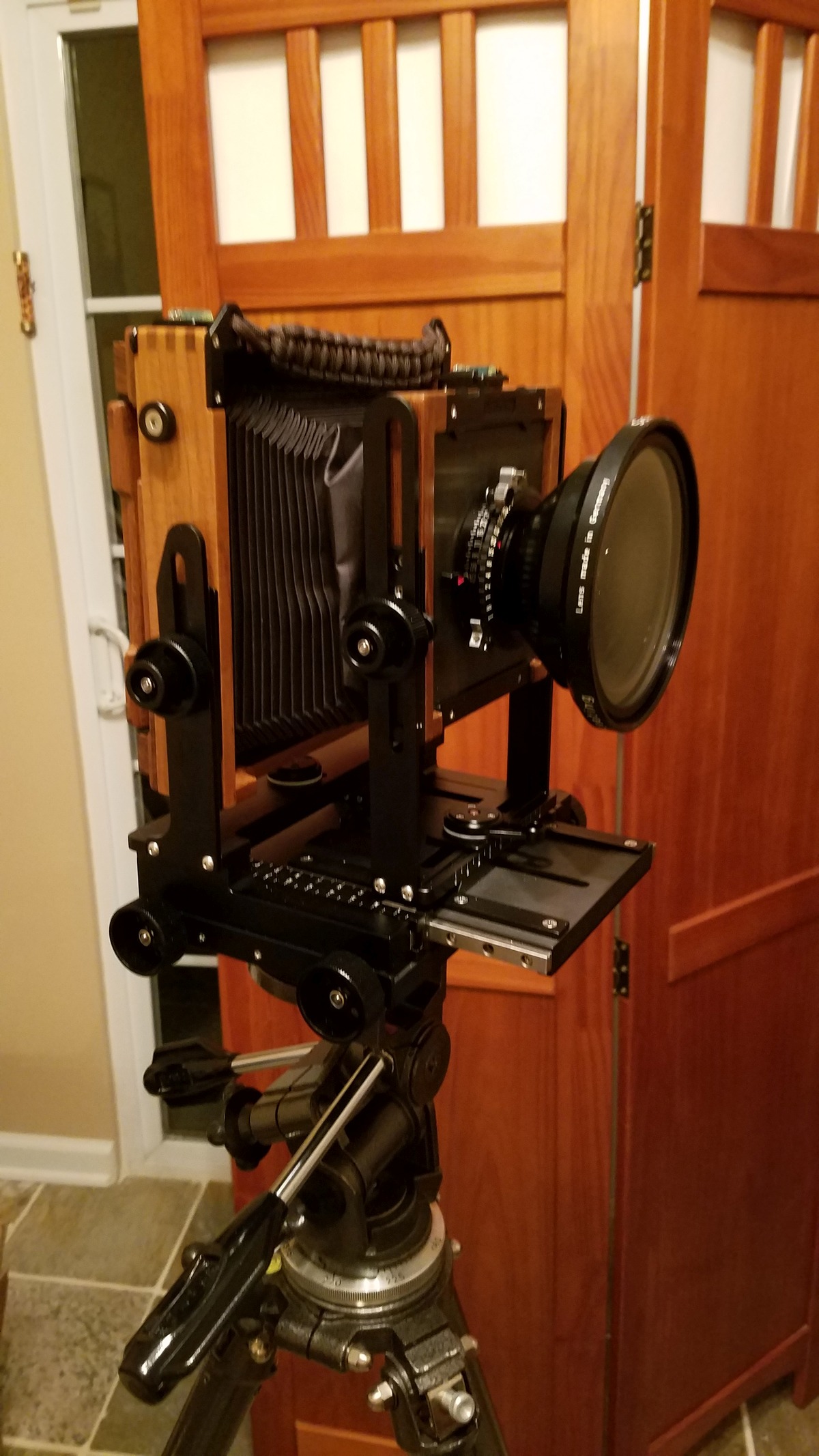

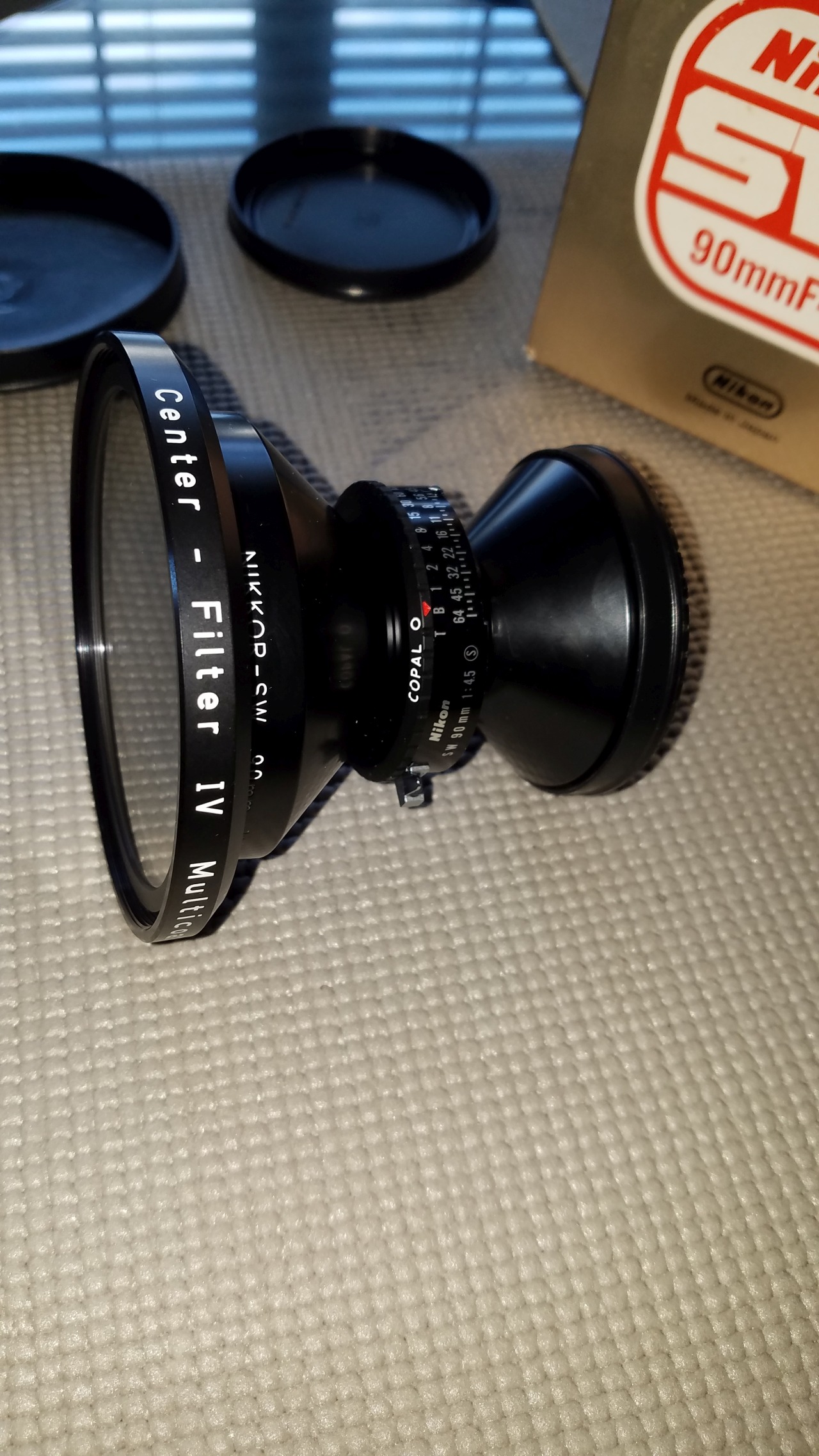

Thanks. My 90mm is a Nikkor SW f/4.5. It's a beautiful lens that needs a 105mm filters for the Schneider IV center filter. So I can;t use my 77mm medium format filters that fit on my other 75mm, 150mm and 300mm with adapters. I just don;t want to go out and spend all that extra money for filters.
20200316_114607 reduced.jpg 20200316_114607 reduced.jpg 20200324_224752 reduced.jpg
