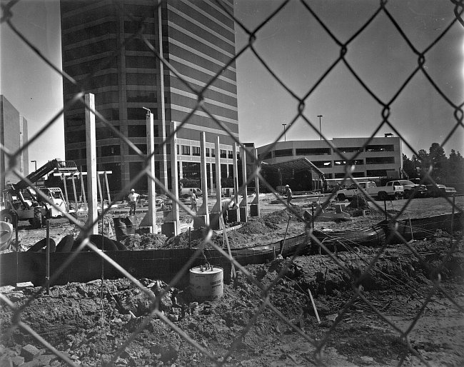

Okay, here's the scan I promised earlier.
4x5 Speed Graphic, Agnar 105mm f/6.3, .EDU (Forte) 400, Parodinal 1:50

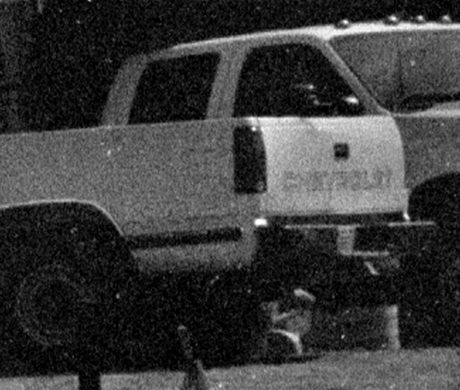

Detail of the white crew-cab Chevy pickup:

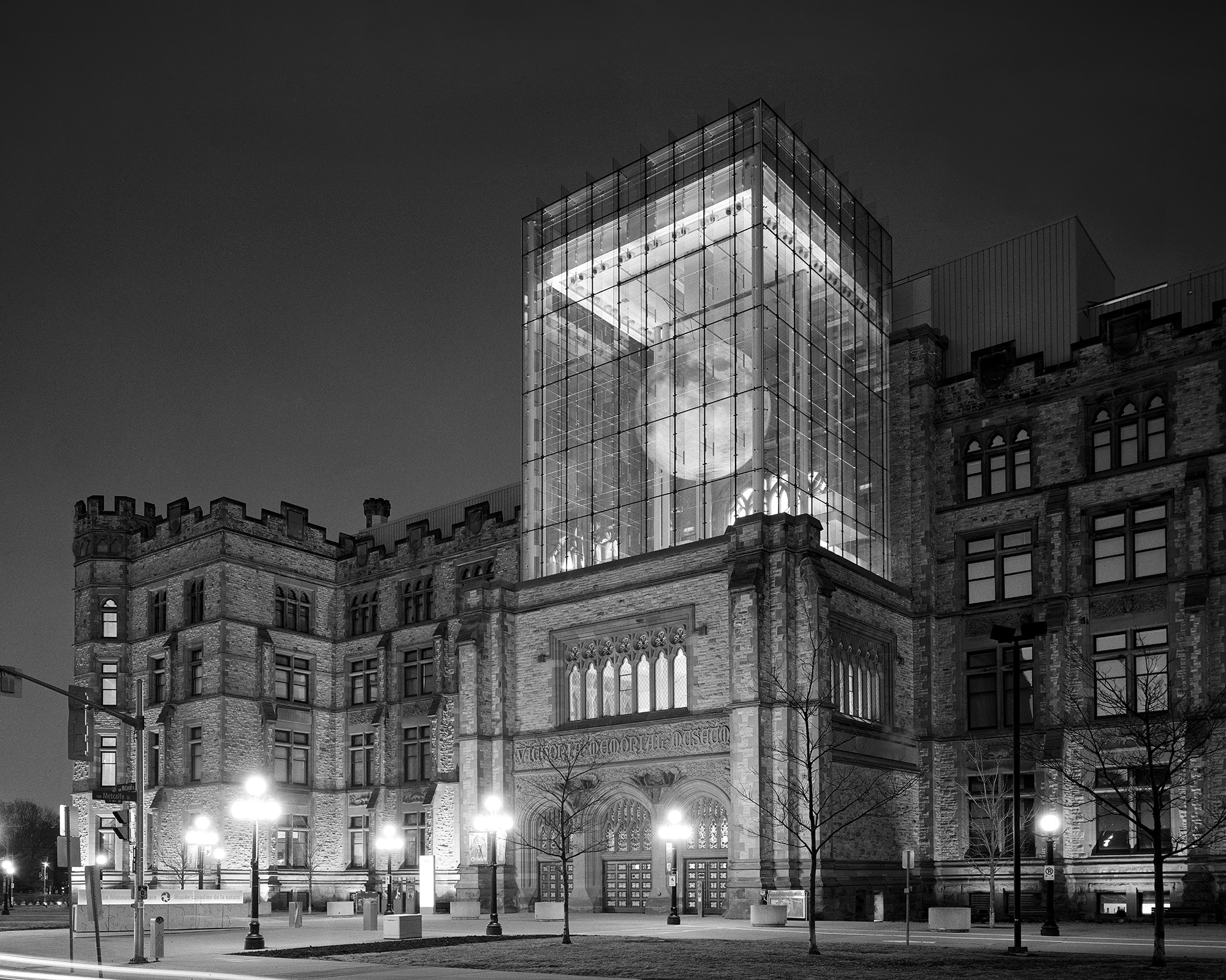

I have the cheapo Optar WA 90mm f6.8. Cost me about $75 in a shutter. Images are sharp (to me) to the edges at f22-f32. Sometimes I find composing at f6.8 and stopping it down to f11 for focusing helps make it sharper to judge focus. There's really absolutely no room for movements at the full 4x5 frame, but I sometimes use front rise which vignettes the top corners and then clone in the vignetted sky. Here's an example. I can send you full size examples by pm if you want to pixel peep.
Canadian Museum of Nature by Howard Sandler, on Flickr
