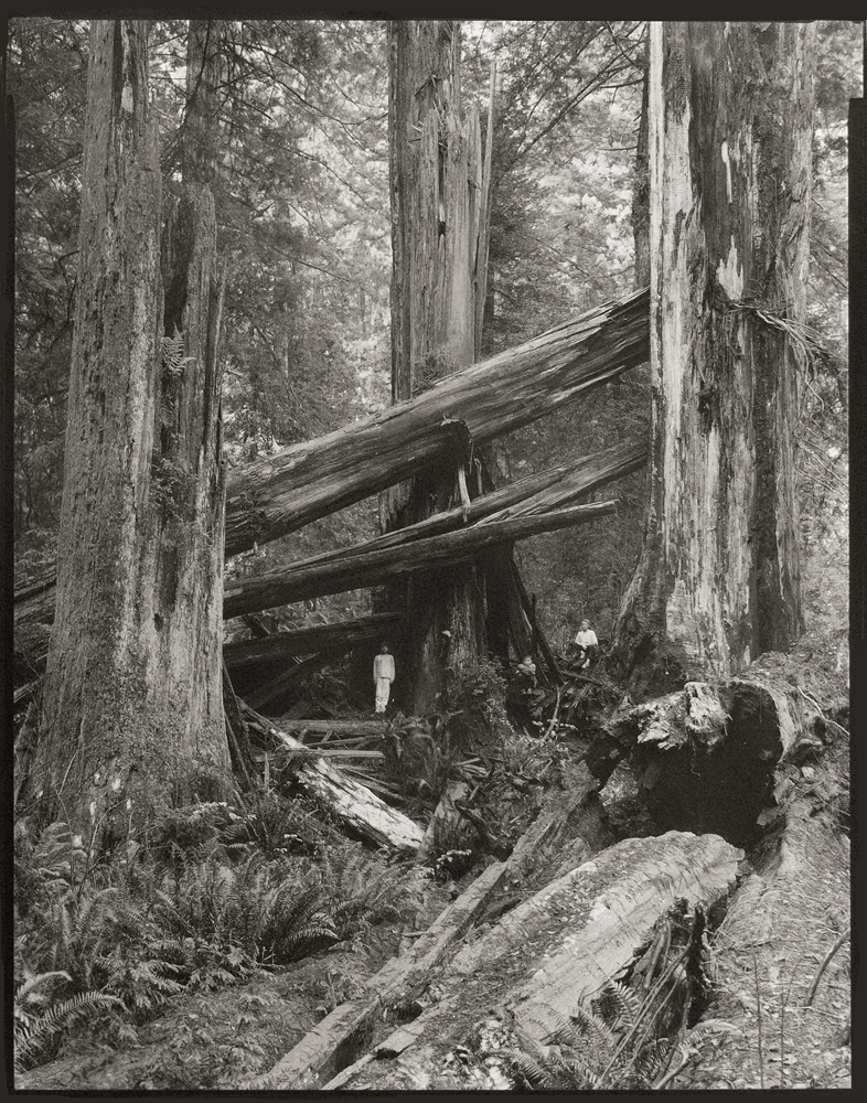

I am on the other end of the scale, where I tend to consider seeing, composing, making the negative, and printing as one step from me and to the work. Which is one of the reasons life with my triplet boys became part of my photography. Saw no reason to keep them separate.
Three Snags, Three Brothers, 2008
Prairie Creek Redwoods State Park
8x10, two minute exposure
Carbon print
