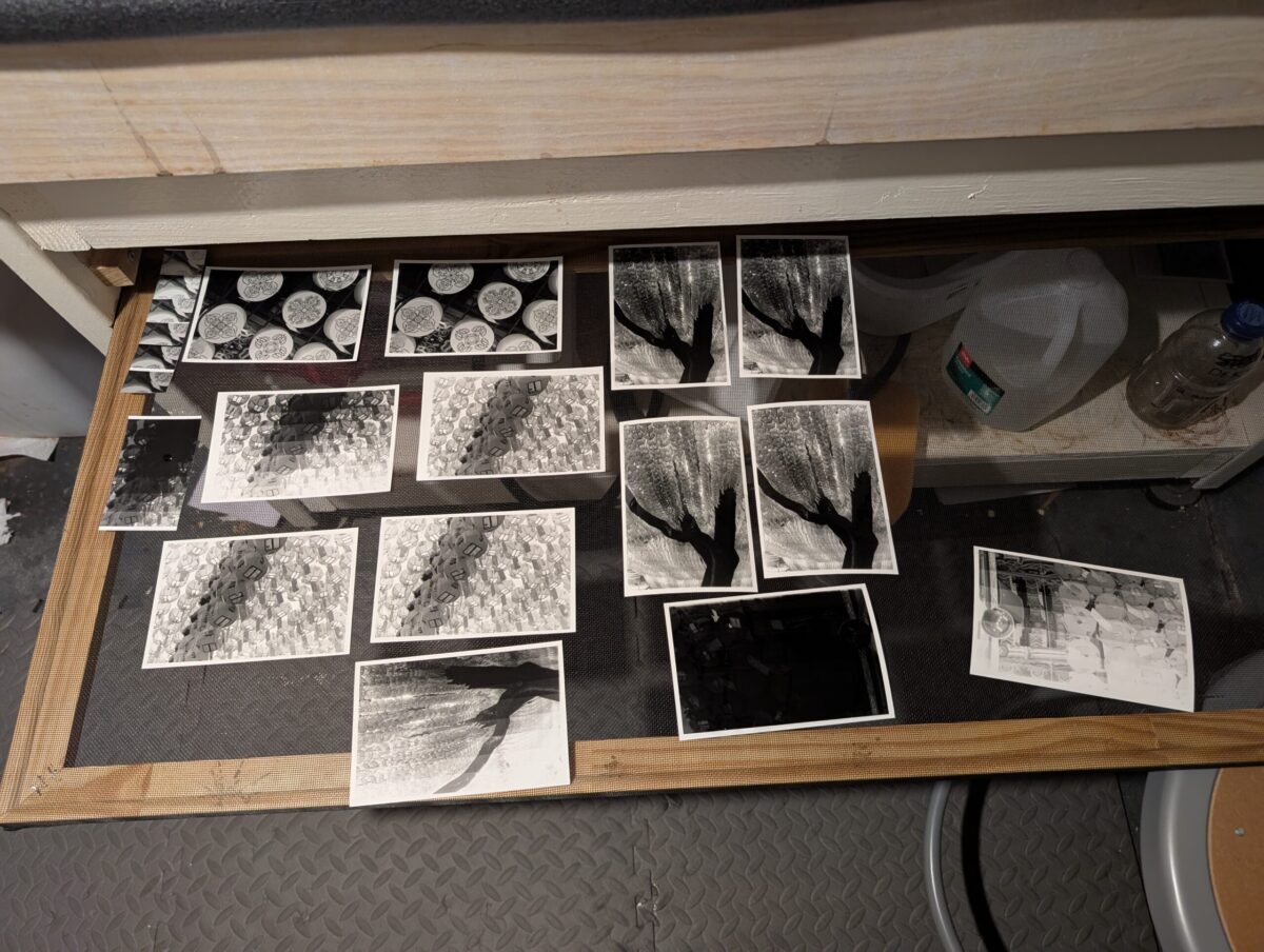

It's a little embarrassing how long it took me to figure out the light was too bright. I kept thinking the postcards looked a little too dark, but it wasn't clicking in my brain that I was looking at them under a bright white light.
I started taking notes on what looked good in the darkroom vs my living room. I do f/stop printing and use 1/3 stop times for my test strips. I quickly figured out that if I go about 1/3 stop lighter than I think looks good in the darkroom, it looks good in my living room. (That's for RC--I haven't done enough with fiber to figure out dry-down and all that yet.)
I also figured out if I block the single lightbulb in my darkroom with my body, and view the photo in shadow, that gives me about the same result as removing 1/3 stop.
