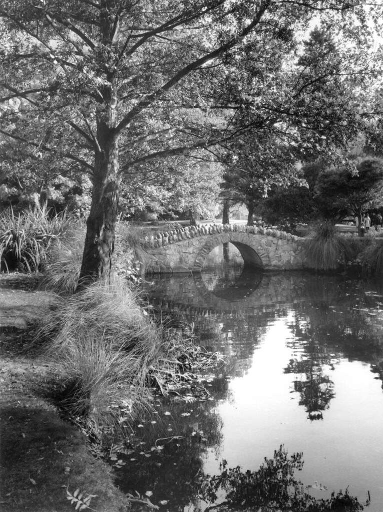

Bridge, Queenstown Gardens
Gelatin-silver photograph on Ilford Classic VC FB photographic paper, image size 21.5cm X 16.3cm,
from a 68 format Ilford Delta 3200 negative exposed in a Fuji GSW680 camera.
The Ilford Delta 3200 was exposed at EI 1000 and developed in a mixed batch of films in Replenished Xtol
at 20C for 11minutes 15 seconds. Nothing special, plenty of detail, no obtrusive grain, easy and routine.

This is a very good result, given that it's Delta3200, albeit at its real speed around 1000. I was wondering why you used such a high speed film for this scene where I would have thought 400 would be adequate.

The Queenstown picture was exposed during a recent tour of New Zealand where travel constraints meant I could not bring a tripod. This is one of my first hand-held exposures since 1977! I'm a bit paranoid about camera shake and with a red filter on the lens and looking for landscapes on the shady side of a mountain I feared I'd run out of shutter speeds and f-stops. Hence I used the fastest film I could find. The big 68 negative eased concerns about excessive grain in moderate print sizes.
