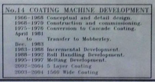

To answer some points above, the main Ilford Coater M14 was built specifically for them and commissioned in 1970 and was originally installed at their site in Brentwood Essex, development commencing in 1966 under ICI ownership and completing under CIBAs (later CIBA-GEIGY) ownership before being moved north to Mobberley in 1981 with the closure of the Essex site. Its undergone a number of upgrades over time as coating technology has developed.
There is a plan and brief history of the machine about half way down this article on an Ilford factory tour by a local newspaper in the NE.
http://this-is-sunderland.co.uk/2013/12/15/ilford-factory-tour-where-black-and-white-film-is-made/
At the end of the Article there is a short video of the M27 pilot coater, 120 spoolers and the ex Agfa conversion and packaging machines in action. The latter were fairly state of the art at the time of the Agfaphoto collapse and no doubt added greatly to Ilfords production efficiency and continued ability to compete in the current market including converting film for 3rd parties.
This is a narrow width coater similar to the Kodak machine except ours had 2 8 slide heads and this one appears to have a 4 slide head. Of course, there can be an additional slit at the very tip that is out of sight.
Very nice and clean. Ours was much much older and is rather getting to show its age. At least IMHO.
