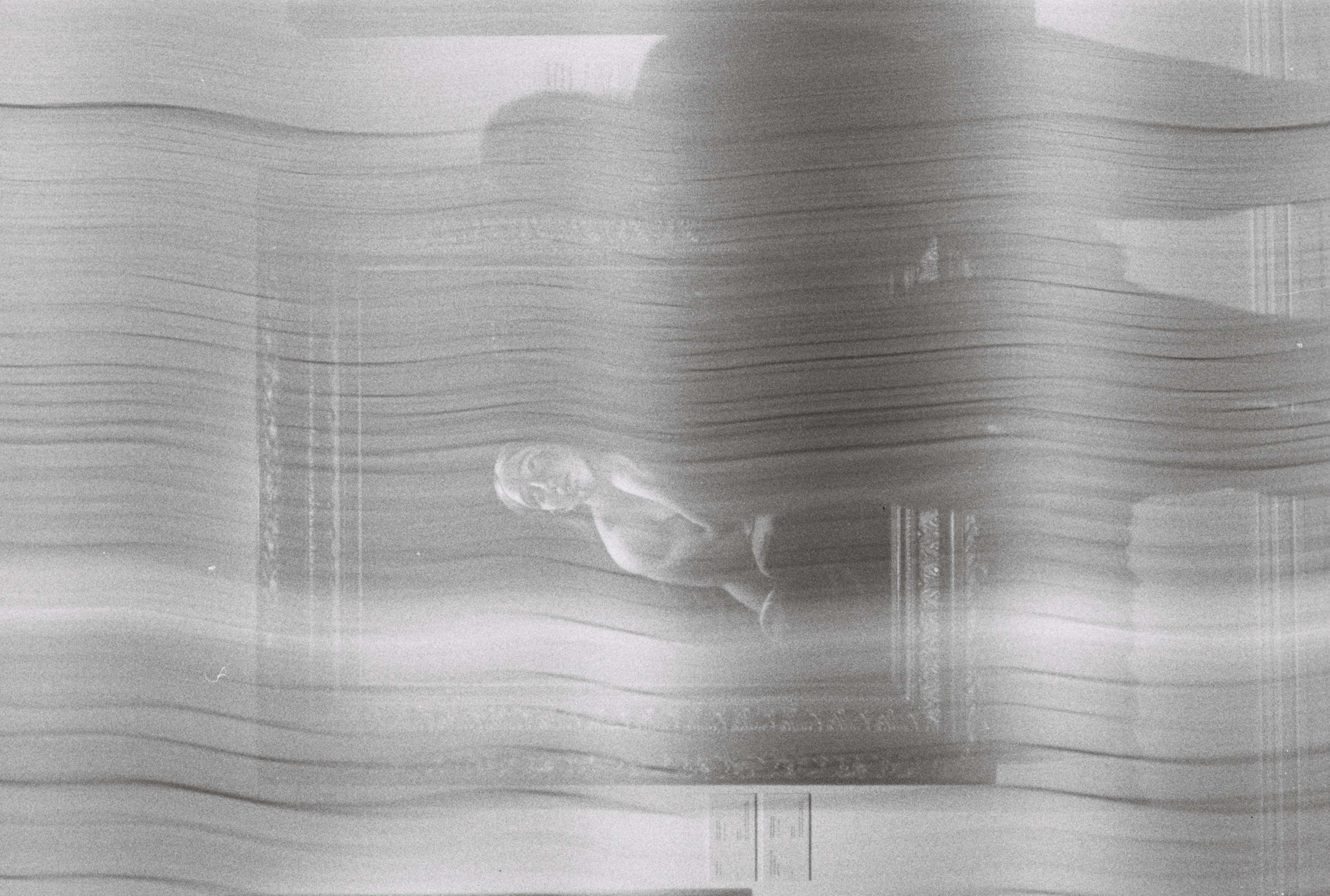

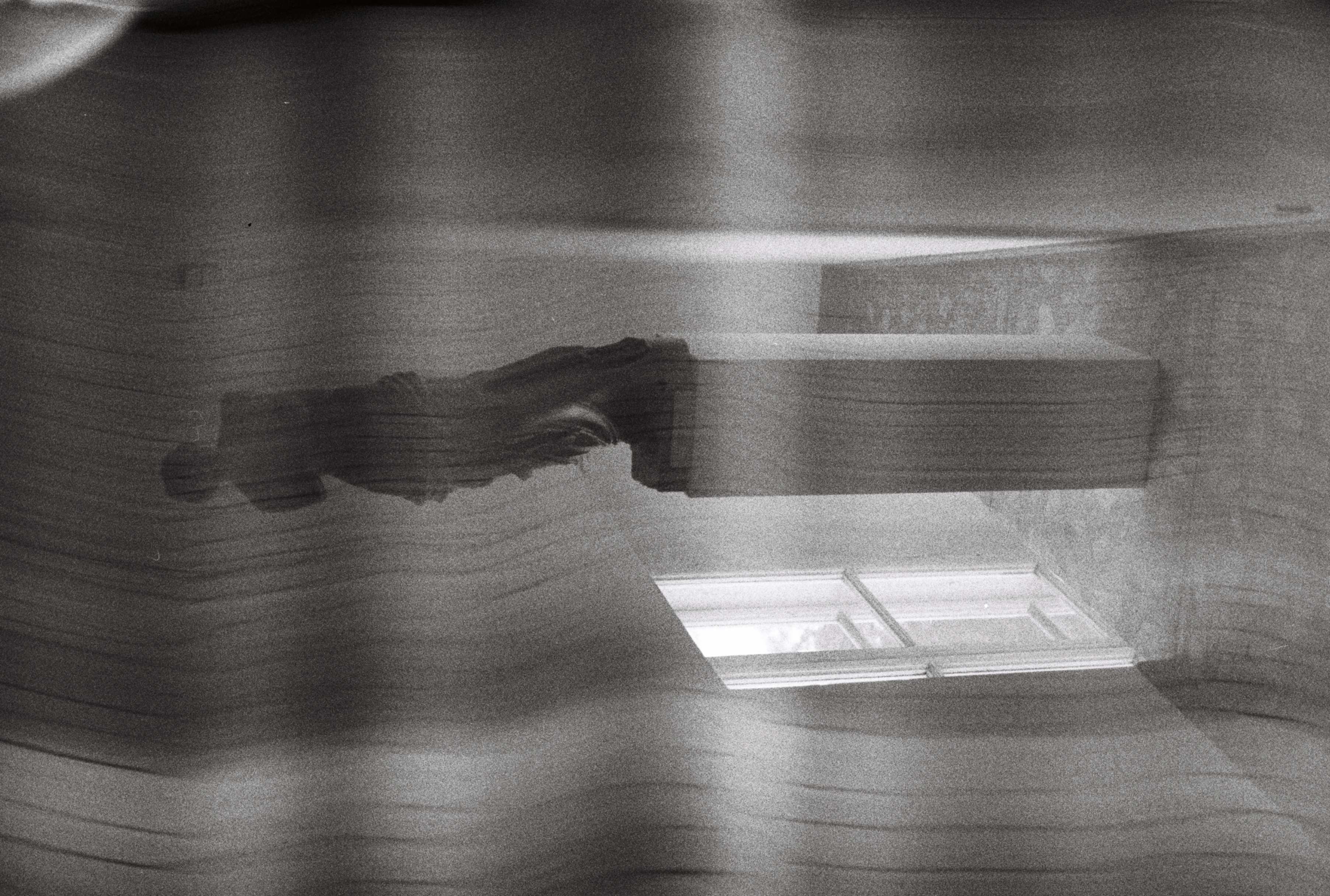

I am totally flabbergasted, never seen this before. What happened? Every image has these "waves".

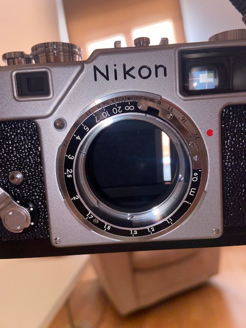

The background story is that this specific roll I shot with a new camera (Nikon S3). Advancing the film felt excessively though, and by the end of the roll, the shutter and the shutter button jammed.
The shutter is made of cloth, I think it's two pieces separated vertically, and by now you can see a slit between the pieces.

But how does variation in shutter slit width leave relatively sharply defined striations as shown here:
Especially at larger apertures as also evidently used. The shutter is quite some distance from the film. Hence, the variations in exposure you'd expect from a shutter anomaly will be rather fuzzy and more like the vertical lighter bands in these frames. I could explain those from a wrinkled shutter curtain, but I find the dark lines puzzling.
But how does variation in shutter slit width leave relatively sharply defined striations as shown here: View attachment 397805

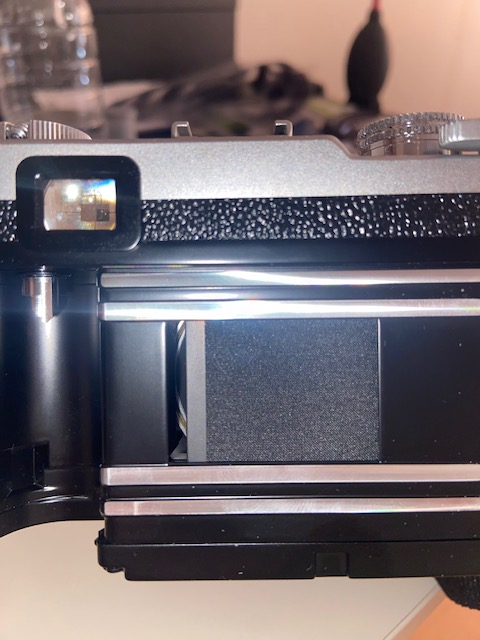

Well yeah, it's a puzzler, and probably the result of multiple things going wrong. I would like the OP to post photos of the focal plane shutter (from the front and back) even if it is stuck.
It looks like the cloth focal plane shutter had a wrinkle in it, or was a bit twisted, giving you the wavy exposures. You mentioned "Advancing the film felt excessively though, and by the end of the roll, the shutter and the shutter button jammed" so I would think that the shutter is completely hosed at this point.
Sounds very possible
The front photo was taken against full sunshine, so I doubt the pinholes. You can observe the stuck shutter.
Ah, so it's a horizontally traveling shutter. I hadn't realized this and it makes the shutter as the main cause of the problem more likely in my view. It seems like the shutter curtains are flapping about a bit as they travel, and they fail to track properly. Something along those lines, I'd expect. I'm no expert on shutters, but I understand this is the kind of thing that tends to trigger major repairs to these types of shutters.
...maybe because you expose another picture onto the neg when advancing the broken shutter. If the shutter curtains are not closed when advancing the film and cocking the shutter, whatever the lens sees will be exposed on the film. Usually when advancing the film you`re not trying to hold the camera as steady as possible, but sometimes even give her a "twist". When the thumb of the right hand moves the lever to the right, you sometimes twist the camera to the left. This would streak the subject on the film if the curtains were open during advance/cocking.
Depending on what distance the lens is set at and distance to the subject pretty sharp streaks could be exposed onto the film.
That is it entirely and accounts for the wavy lines. The film advances and the shutter resets at the same time. The shutter is likely almost completely closed while advancing (the first curtain pulls up against the second and then they both travel across the focal plane) but probably letting little pinpoints of light.
The shutter needs to be serviced but maybe not replaced. That kind of behaviour can be from dried lubricants or even just bits of film stuck in the track.
