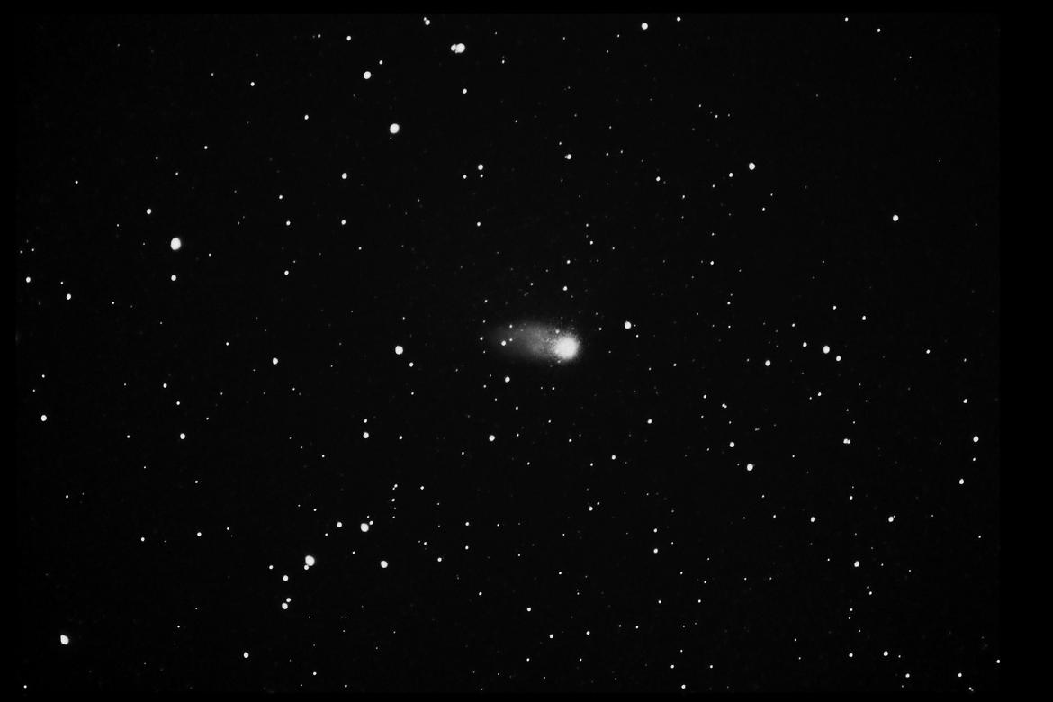

Not Nikon but many years ago I used an Olympus OM1n for Asto photos with an 'all matte' focus screen (type 1-8) or a 'micro-prism clear field screen (type 1-7) .
This was taken in 1997 with the OM1n and 135mm f2.8 lens piggybacked on 114mm reflector, hand guided, 25sec @ f2.8. Kodak Tri-X, about 50% crop of original 35mm neg.
Comet Hale-Bopp
