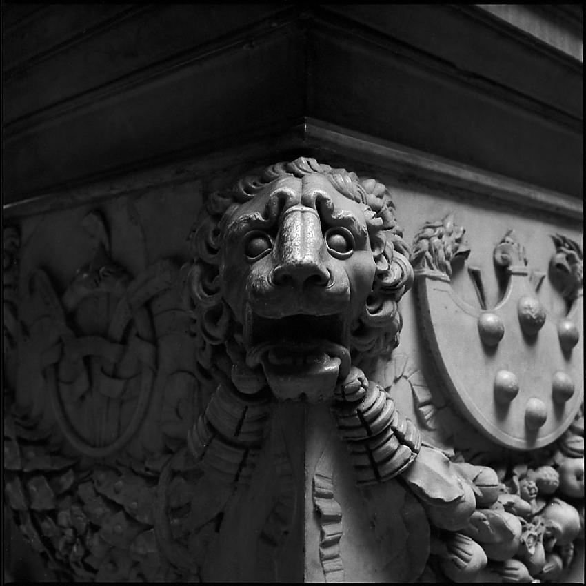

For what it's worth, here are a couple of photos taken with Bergger Pancro 400 shot at 400 (incident metering, shot with a Flexaret Va, developed in PMK 1:2:100, scanned with an EPSON V600):
It's really not bad, though it's grainier than I'd expect for a medium format film. But no highlights are blown (you can still see the fabric of the soft light in the 2nd shot, if you adjust the brightness of the scan accordingly), and no shadows are blocked up. Honestly, I'd use it at E.I. 400 again, and I'd give it a try in 35mm format if I could find it.
