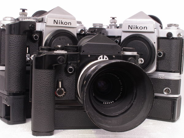

My list of desired features is probably different from your list; therefore, it is probably of no value to you. Plus, my list of desired features is way too long to post. Therefore, all I will say is that the Nikon F2 with non-metered viewfinder is the camera that has all the features I desire in a manual focus SLR except for an optional digital image back.

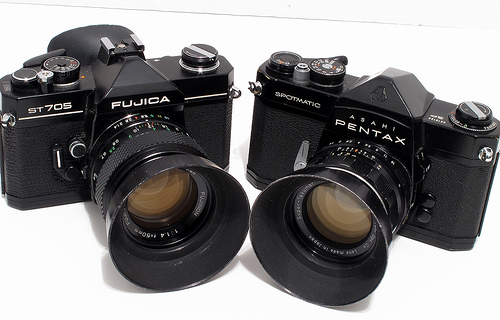

Two other cameras that that have most of the features that I consider essential are:
Pentax Spotmatic
Fuji ST705
Bayonet lens mount, interchangeable viewfinders, interchangeable view screens, motor drives, and interchangeable backs are essential features my Spotmatic and Fuji lack.
