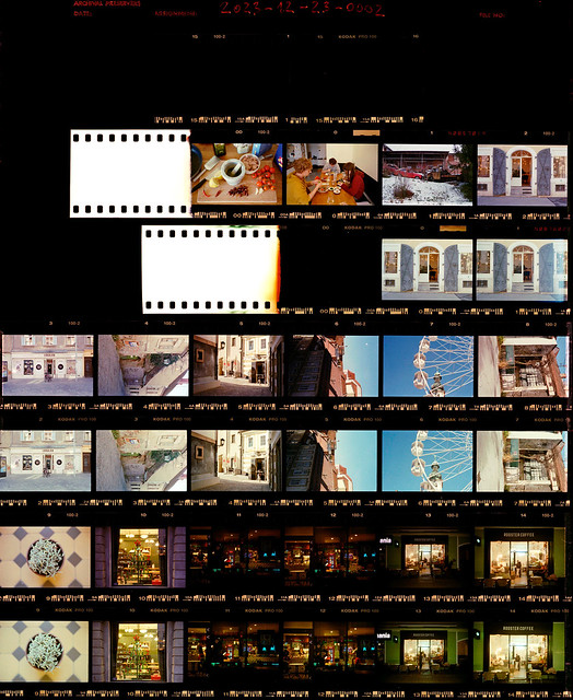

I've also shot Lomo CN 100 and Kodak Proimage 100 and never thought I was getting the same results. Some people running private testing labs claimed both films are the same, but you never see their results so I did a side-by-side. Twice. Latest test I did at the end of last year. I bought a roll of each film at the same time, but I obviously can't know whether they were produced at the same time. For me this was second proof they are not the same film. Close, but not the same. ProImage is also on the Estar base, my Lomo CN 100 was still not (again, I can't know if the very latest Lomo CN 100 is now coated on Estar).
Developed in the same tank and scanned in one go:
There seem to be at least 3 close variants of gen 7 Gold 100 - Gold 100, Farbwelt 100, and ProImage 100 - depending on the extent of the colour balancing difference in Farbwelt 100, it's quite plausible that testing of whole rolls without the simple (yet effective) comparative controls that you enacted would simply result in it being more-or-less balanced out or chalked up to subject/ batch variance (if it's the same testing person, the resolution tests they did, while not majorly flawed procedurally (you can forecast them if you have the MTF and know the test chart contrast), read out the results in a way that created significant errors between negative and transparency materials). It wouldn't be beyond the realms of possibility that Lomo 100/400 are effectively the Farbwelt variants of Gold/ UltraMax. I can confirm that the Lomo 800 120 is definitely on Estar base which is much less well behaved (and feels thinner) than the Estar base on Gold 200 120.
Having shot a fair amount of the Lomography branded films, as well as having been a big fan of Kodacolor VR and not of Gold.....I'd say that Lomography 100 and 400 are interchangeable with the 90s Kodacolor VR stocks. Maybe a full on laboratory test would show up some differences but they it seems highly likely that they are at least derived from those Kodacolor VR stocks rather than Gold or some other modern product....judging in particular by the way they handle reds and browns. I am prepared to say that I don't think Lomography 100 is Pro Image for the same reasons. The Lomography stocks are more "flat", less saturated, they don't "pop". They act more like the Kodacolor VR films did...or like Color Plus does.
Lomography 800 has a more modern look to it hence the idea that it's Max 800 or very similar.
Kodak have stated that if you pay, they'll coat pretty much anything they reasonably can for you. So it's possible these films aren't exactly what you'd have got buying Kodacolor VR in the past....but most people who have actually used them and who used VR back in the day feel that they must be at least closely related.
I agree with @brbo that Lomography CN100 is not the same as Pro Image 100. The latter has the over-blown reds that Gold has....but not the brown mud-like look.
It also depends on which generation of Gold 100 you are talking about - it seems to have gone through several iterations up to 2007-ish, including new couplers (to eliminate the formaldehyde stabiliser). It would also seem that around the late 90s/ 2000-ish, Gold 800 forked to evolve into Portra 800 and Ultramax 800.
And, the important factor about the results shown above is that it is easy to colour balance the Pro Image to match the Lomo 100. How much that is due to manufacturing batch tolerance & Lomo's warehousing or to different colour balance aims at manufacture is an open question. But it certainly answers the question about why some have tried to decisively claim ProImage and Lomo 100 as the same, when the material evidence would seem to much more strongly support the idea that they are both Gold 100 derivatives.
