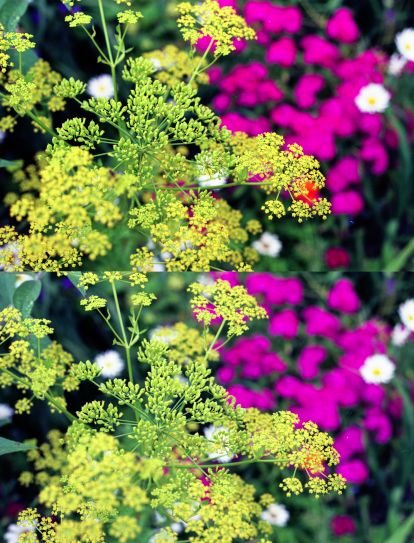

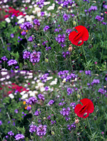

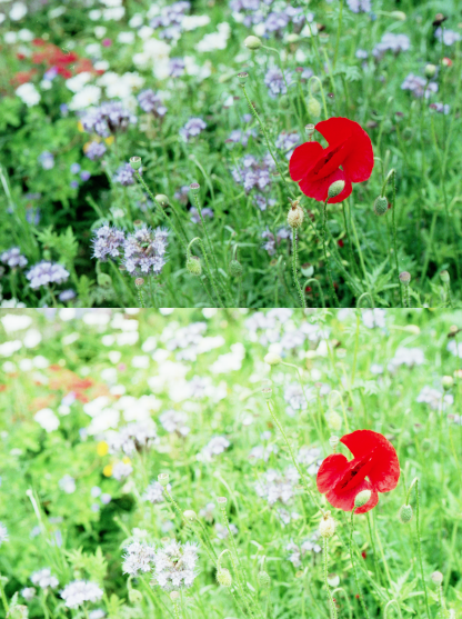

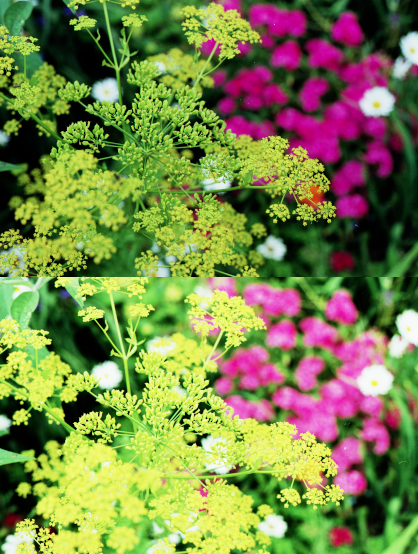

To illustrate the problems with frame-by-frame scanning, consider the following sets of frames:
These are four different negatives of two identical scenes shot under identical conditions. The scans were done frame-by-frame with Epson Scan, with the scanning software automatically balancing colors. Note that there are distinct differences in color between both sets of frames, but they're still fairly close, I'd say.
Here's how the same negatives look like, but scanned as a positive, inverted manually and then the same adjustment curves applied to the respective pairs:
Note how the differences in reality are far less subtle...
If the negatives were truly as similar as the initial examples above suggested, then the second set of examples would have come out the same. But they don't. Ergo: the negatives are quite dissimilar, but the scanning software has managed to hide most of the dissimilarities from us.

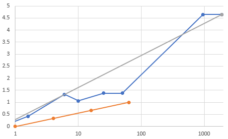

His exposure is variable, that's the only thing I can make out of his data.
Vertical axis: +stops exposure compensation
Horizontal: seconds of exposure (note: log scale)
Orange = Fuji Superia 100 datasheet suggested exposure compensation
Blue = stops of overexposure as calculated from the meter readings in the first image in this thread
grey = sort of average of the blue line to get a feeling for how it relates to the orange line...
Note how Fuji's recommendation is a neatly log/log progression. Les' exposure range does not show a clear logic to me.
If the lighting was kept constant and if the meter readings are consistent with the lighting conditions of those shots and if the exposures were timed as indicated in the overlayed text, the average density of the negatives would have varied. The fact that they remain fairly similar (with some differences in contrast) suggests to me that the scanner is polishing away the real variations in the negatives.

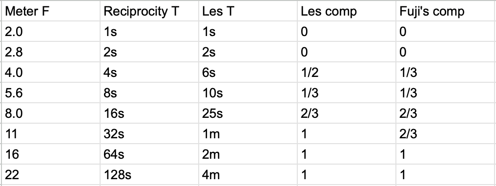

@koraks, Les explicitly stated that he kept lighting fixed when going through aperture f2.0 to f22. Only after that did he start playing with light intensity to get to longer exposure times.
Let us assume that at f2.0 his camera's predetermined exposure time and actual camera's exposure time and the time that Les recorded with his stopwatch are all 1s. He then progressively closed down the aperture with lighting of the scene remaining constant and timed camera's exposure times (Les T). This is what the data looks like.
I think it's the dominant factor in explaining the conclusion presented in the first post.
If the exposure data I gleaned from the first post are correct, and those or similar data are applicable to the actual night scenes posted, then sure. However, I also note that the night scenes presented are shot on at least partly different materials. IDK what kind of compensation may or may not be applied there.

First of all, I appreciate the interest in the topic regardless of whether or not you find my test clear or unclear.
For clarity, the test shots of the Fuji 100 long exposure sequence, I referenced the Sekonic and the Pentax LX meters and they do appear to match up to 50 seconds when the Sekonic started to timeout and the display no longer matches. I also timed those exposure themselves using my stopwatch to confirm the LX exposure expired at about those exact times plus my response time to stopping the watch. So to be clear, no additional exposure compensations were added.
