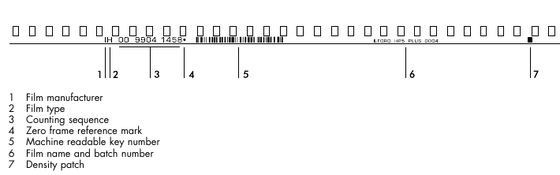

Well, one reason to be enthusiastic about decently controlled edge exposures would be because it gives a tiny bit of insight into whether the film was processed more or less correctly, although this would require a very small aperture densitometer. Maybe with some trickery a flatbed scanner can be 'calibrated' well enough (by scanning a known reference along with the film strip) to approximate some readings.
I am attaching descriptions and an example from my old film.

Is there a place on the web that shows how they ID mark their other films?
Well, there's not all that much on there, and what's there is pretty much self-explanatory, isn't it? Just film type + frame indicators for roll film and only the film type for sheets. The only 'mysterious' thing is why Kodak starts numbering their 120 rolls at 41, but I think a very reasonable guess is here: https://www.photrio.com/forum/threads/edge-markings-on-120-film.55901/post-815642
For the already discontinued fujifilm eterna/reala - description of markings. Unfortunately, there is no year of manufacture.

the Kodak site has a diagram of what every mark is suposed to mean. https://www.kodak.com/content/products-brochures/Film/post-production-35mm-keykode-diagram.pdf the diagram was also back when they were using codes for the year. (a couple of things in the diagram I have not seen on actual film, But I have only been using 5222 lately. (they have another diagram for both 16mm and 65mm)
start of the information is at https://www.kodak.com/en/motion/page/keykode-numbers
@cmacd123 thanks, that's excellent! I hadn't yet found that Kodak page you linked to. It explains it all, except for the hue/density of the edge print. So, to recap/summarize:

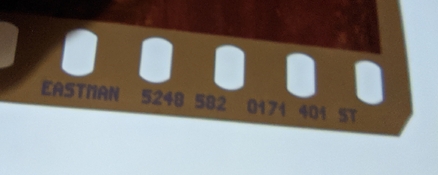

Yes, kodak has made so many different films when they were trying to outdo Fuji, that they have assigned every code starting with E (eastman) and K (kodak). Fuji with their Mr.Code used FN and a number for all their Movie Negatives.
Orwo N74 was marked ON and Orwo UN54 was marked OU
I think Ilford used I But I have never seen any Ilford Key Code compatible film. (found it in an old data sheet. IF ==FP4 Plus, IH== HP5 Plus and IS == SFX200 which I saved in 2003
as far as redundancy, for Old fashioned Scissors and cement film editing, the footage number has generaly always had some sort of code to identify the type of film. the footage Numbers are printed through to the "Rushes" which become a "work Print" and the conventional editor picks the edit points and splices the work print into a prototype of the finished film. Once that is approved, they can go back and find from there notes which rolls of Negative have the Camera Negative for the scenes and shots used, and a specialist "conforms" the negative to match the work print. (this is so specalized that One of the more famous folks who does this has their OWN Wikipedia Article https://en.wikipedia.org/wiki/Mo_Henry

I could use help in identifying this mysterious Kodak film. I believe it’s a motion picture film but I couldn’t find anything about it online using the edge-print code. It is “K•ODAK 26 12” as it shows in the attached image.
