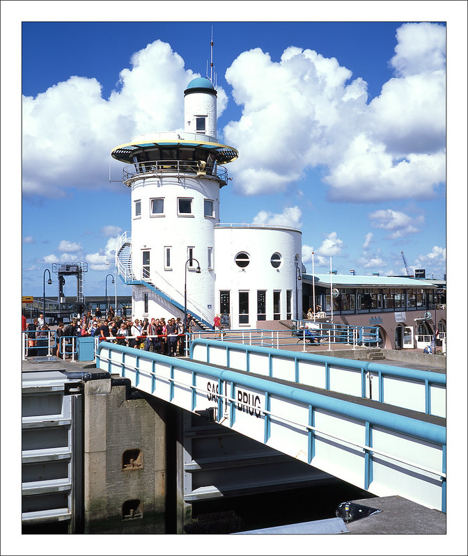

Here is another direct comparison between the two. I shot this scene with my Hasselblad 501CM on both films within seconds of each other:
Provia100F
Ektar
Slide film will always struggle with the dynamic range in these types of scene, therefore it's not an ideal comparison in that regard. Nonetheless I thought the Provia did quite well. The bluer tone of the greens with the Provia is quite obvious here. I like both versions for different reasons.

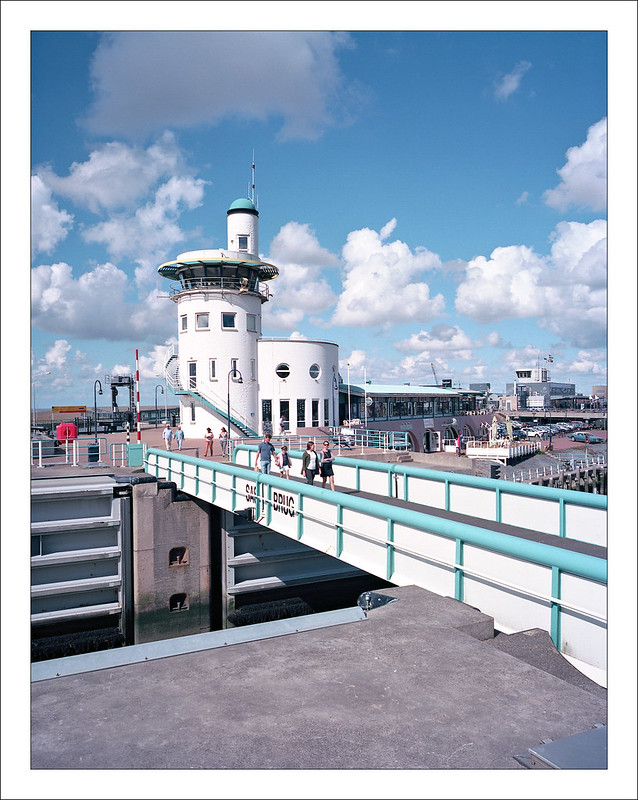

Another comparison Provia vs Ektar - photographs were taken within two minutes. First shot on Provia with FUJI GW670III and Fujinon 90mm, the second with FUJI GA645Wi and 45mm lens.
Here I prefer the Ektar version.
Provia
Ektar
The Ektar light house scene is a tad too magenta for me
