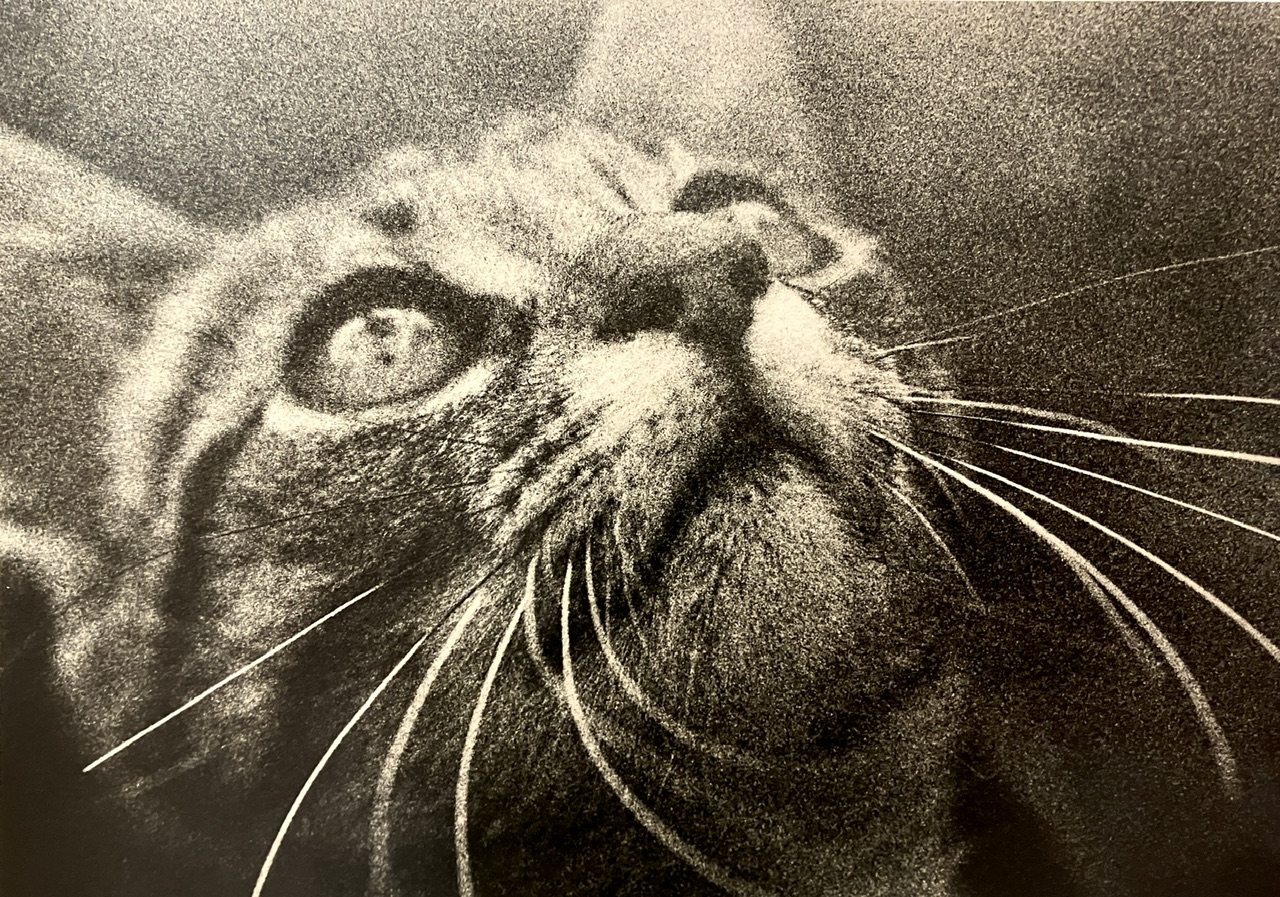

Did some more lith prints and used another old Kodak RC paper. Kodak Kodabrome II RC also seems to work for lith. Developer Moersch Easylith.

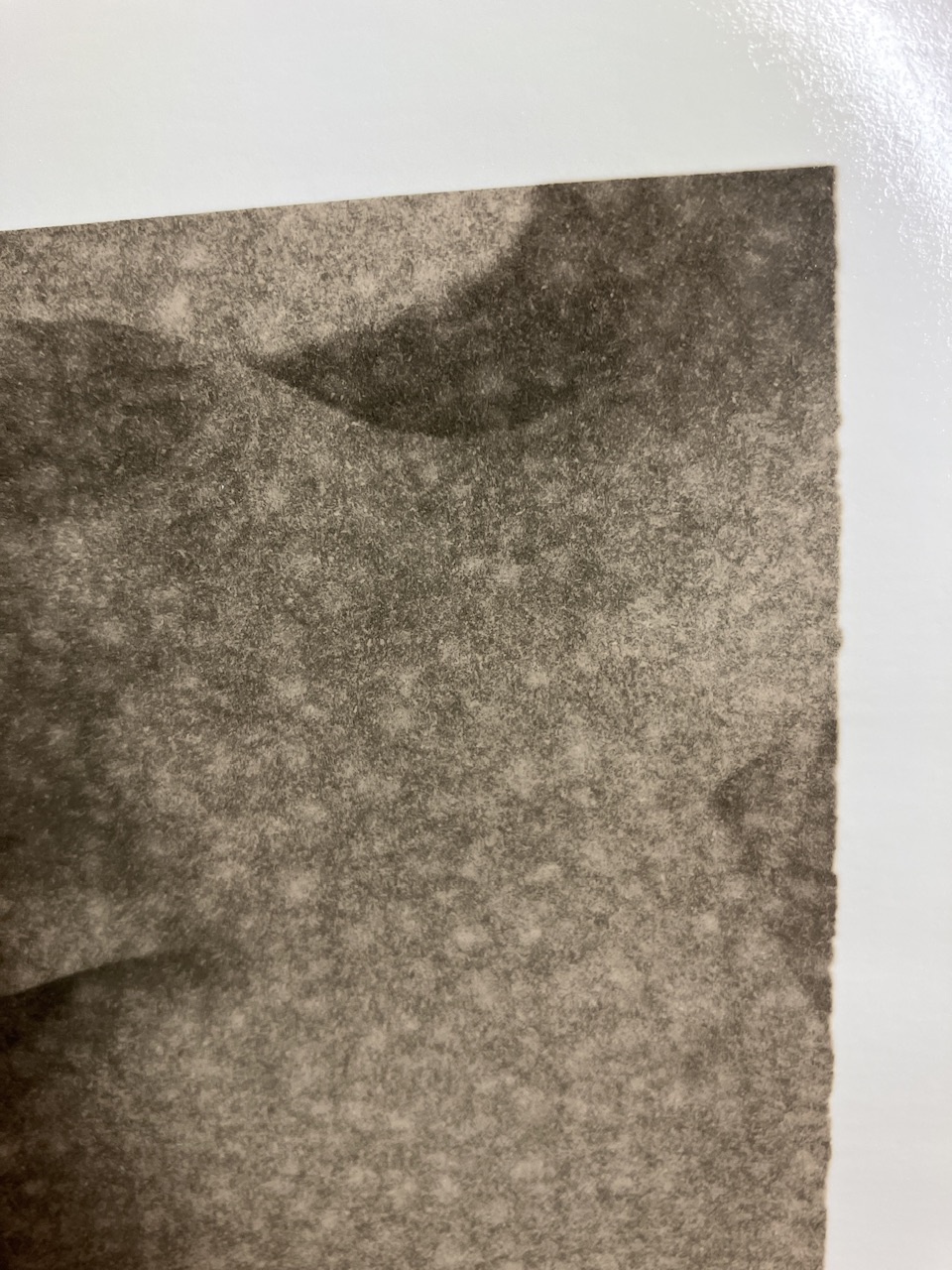

I tried some modern Ilford MG fiber based papers in Moersch Easylith dilution 1:25 just because I was curious but it turns out this paper is not lithable. Snowball effect on every paper I developed.

Have you tried second pass lith? Overexpose print, develop in normal paper developer, then bleach back with a rehalogenating bleach and then redevelop in your favorite lith developer. Many papers can be successfully lith-ed that way, even if they don't work in the normal fashion.
Possibly because the first developing cycle washes the incorporated developer out of the emulsion.

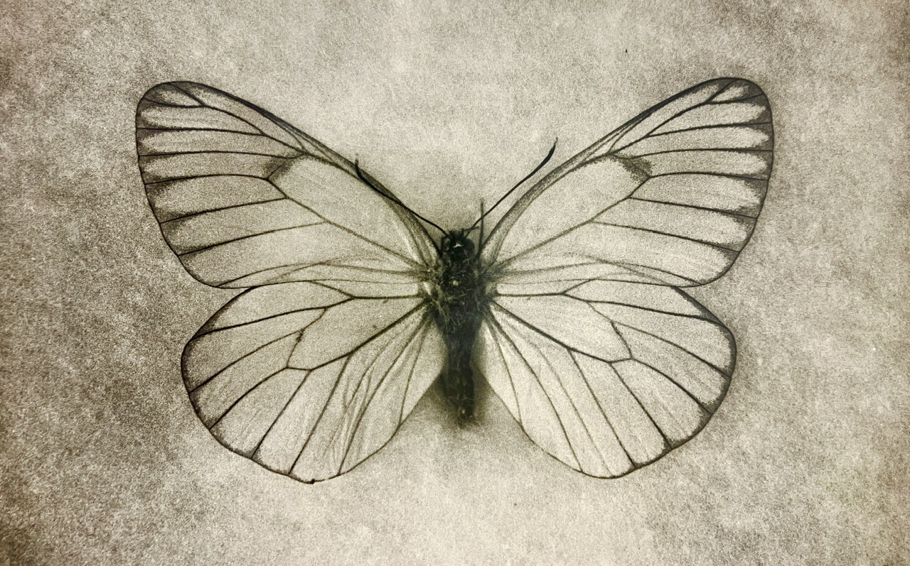

I have not tried that but i am planing to try with Ilford MG RC. I really would like to find a modern RC-paper suitable for lith prints.
My favorite old and discontinued paper so far is Kodak Polymax II RC. This paper give consistent results in Easylith and is easy to print for me as a lith noob and learning the lith process.
This is a print from yesterday on Kodak Polymax II RC. For the first time I tried some ”selective” development. Developed the whole paper and put it in stop bath. Then back in the lith developer again for selective developing of some details of the print. Just experimenting and having fun in the darkroom.

Nice looking print and image! Great candidate for the process. Another way you can "Season" your developer instead of OB is to place a sheet, or maybe half sheet of some paper you don't care about (assuming you have any) in your mixed dev with the lights on. Rock it in the tray till it turns jet black. This will take the place of the first less interesting lith print everyone talks about.

Thank you!
Yes, I got a box of Agfa Brovira 30x40cm without the paper safe light tight bag and the papers are already grey. Will try next lith session👍
