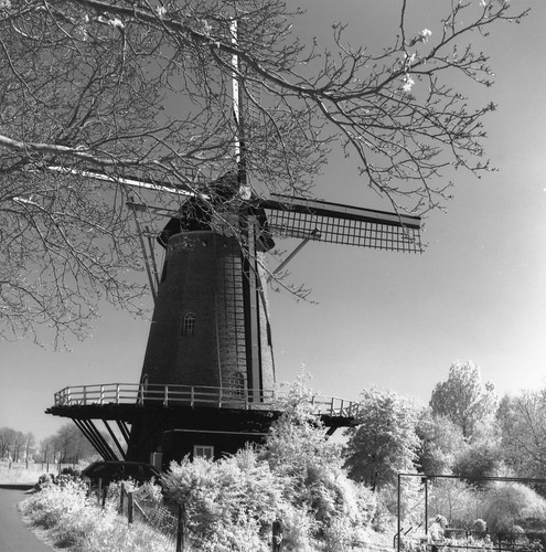

Another IR newb question. What is 'wood' affect?
The reaction of the IR light on the follikel and chlorofyl of the (green) trees and plants.
Above example looks a bit on snow but it's the 'wood' effect of the green plants on the IR light which is only monitored by the IR film.
The filter is completly blocking the visual light so the IR light is only on the film emulsion.
Because the breaking index of IR light is slightly different then visual light you have to correct for the focus.

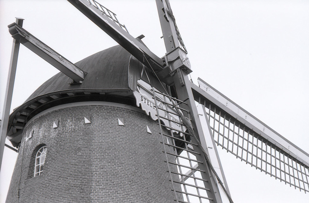

Well, it's the Stella Polaris windmill in Demen, the Netherlands and it's used to live in. A pretty remarkable "house".
This photo has been made about 3 weeks ago.
Here a detail of the top with the name. Made on Efke 25 in Beutler.

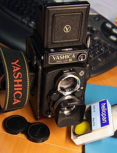

In this way a TLR or rangefinder is the best camera when using the opague IR filters together with the actual IR films available.
My TLR: Yashica Mat 124-G with the bay I Yellow and IR RG715nm filters:
