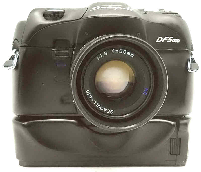

Yes but not by or for Konica Minolta. They are Seagull in SR mount.
A rose by any other name.........
The Konica label was never added to any of Minolta's film SLRs because they merged in 2003 which was after Minolta stopped the production of their X-370 cameras -- in Seagull factories.
But Seagull continued producing the "Minolta" cameras -- that were now labeled "Seagull", and other labels as well, such as Phoenix, Centon, Argus, Kiron and many others. In fact, Seagull added features to these Minolta-based SLRs that Minolta cameras lacked, such as manual shutter speeds to 1/2,000s, multi-exposure capability, auto-winders with additional features, new body styles, etc.

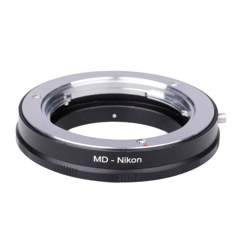

There are adaptors for M 42 to Nikon, it uses a balance lens to correct. I had one, for me too much distortion and vininted when 28 or shorter lens was used.
What I don't is, will a D40 work with a manual focus lens in stop down metering and will the shutter work. With lower end Pentax digtial bodies, they do work with MF lens.
Found this on Ebay.

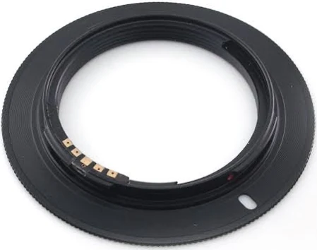

Pentax upper level, pro consumer and pro level DSLR will shutter release and stop down meter with M 42 adaptor. My Sony DSLR will not, but I have a M42 adtport with a set of pins to fool the camera into thinking a lens is attached. I use with a M42 bellows for micro work.
I don't have that problem with my Sony DSLRs, but tell us more about this adapter. I have not heard of this.
Keep in mind that although these lenses are technically SR-mount, they are often referred to as "MD-Mount" among adaptor makers.

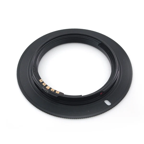

I have an M42-to-a-mount adapter -- which looks just like that except for the electric contacts. I'm not sure how that lets the camera know that a lens is attached -- but I don't look a gift horse in the mouth, either.
I'll have to find one of those.
And it leads me to believe that a t-mount could also be similarly altered to get the camera to respond in the same way. It sure would be nice to have focus confirmation on my long lenses.
And while I'm at it, why not adapt a Minolta/Rokkor-to-a-mount adapter?????
ADDED -- Where did you get that? I can't find it anywhere!

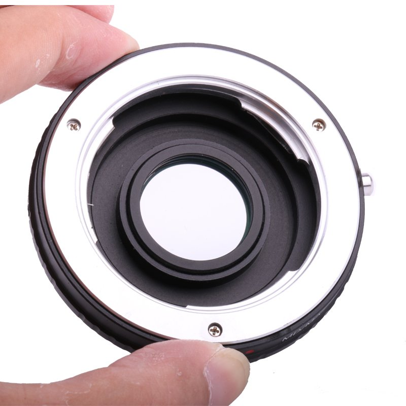

XKAES, does your adaptor have glass balance lens?
So i can use my minolta mc and md lenses on a sony a-700 with no issues?
Nope! The A700 has A mount with the flange distance of 44.5mm and your Minolta MC lens has flange distance of 43.5mm so not only you need an adapter but one has to have an element to correct for infinity focusing. So it's just as bad as using it on the Nikon. You need to use it on a mirrorless like the Sony E mount bodies, Canon R series with RF mount or Nikon Z series with Z mount.
I have both types. Sometimes I need glass, sometimes not. Here's a shot with a Sony a850 -- no glass needed (Minolta Rokkor-X Bellows lens)
And I still want to know where you got your adapter with the electric contacts.
Here is link, I bought mine years ago, I think you can still find one on ebay. It is a M42 to A mount not MC/MD. Nice colors, with a macro or bellows glassess would work find. I had a M42 to Nikon with a balance lens, was more like a teleconverter and did not with wides lens.
First, thanks for the link. I can use an M42 to a-mount adapter, but more importantly, I'm hoping to use it as a template for turning other a-mount adapters into DIY "electrically-compatible" a-mount adapters. Hopefully it will be as simple as I imagine -- famous last words!

I just checked and they have exactly what I need:
M42 to a-mount (with AF confirm) adapter -- no glass
T2-mount to a-mount (with AF confirm) adapter -- no glass
Minolta to a-mount (with AF confirm) adapter -- no glass
Minolta to a-mount (with AF confirm) adapter -- with glass
