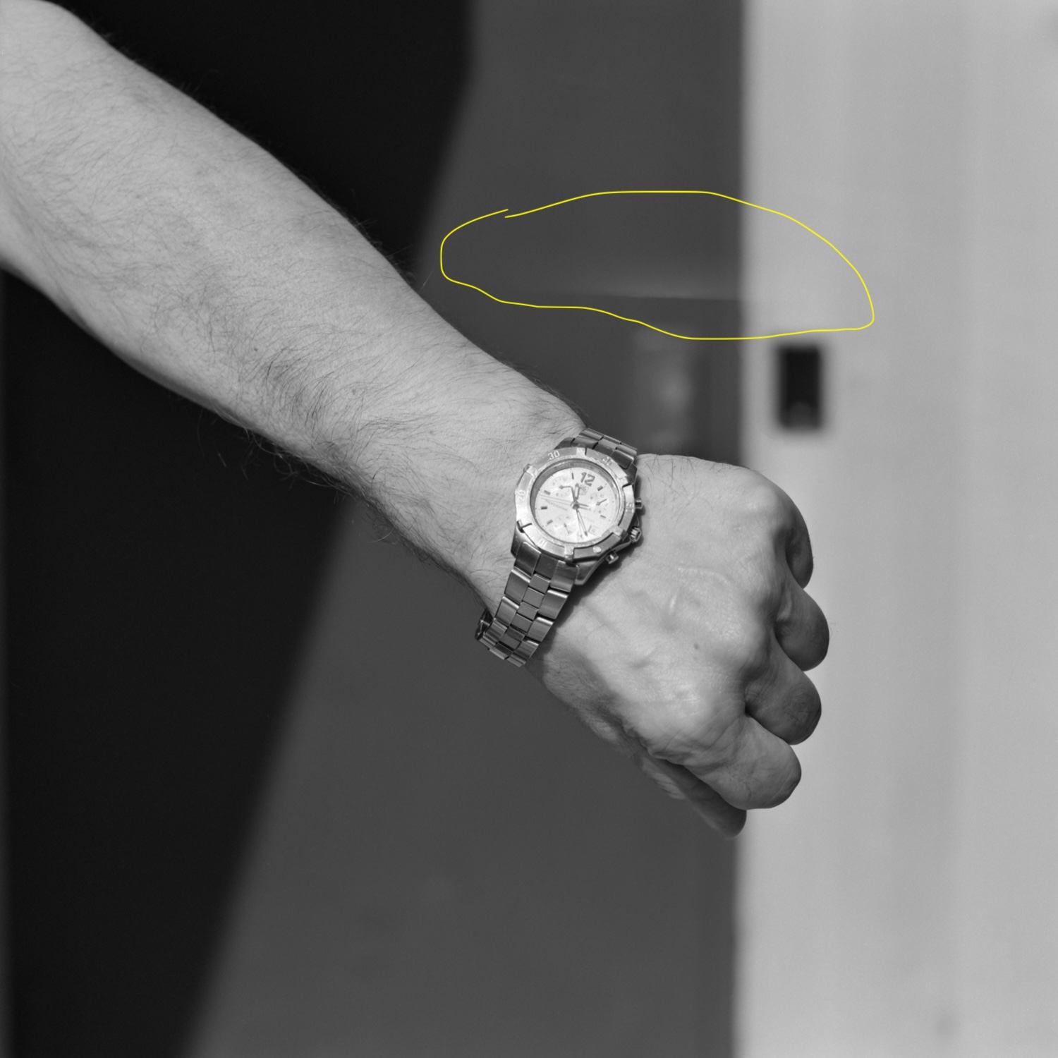

Hi folks. I could use some of your advice. What did I get wrong about the Hasselblad A12 light seal installation for my 500C? I added a fresh set of dark slide seals. However, there's still a light leak. It's not in every frame. I followed the instructions in these videos: 1, 2.

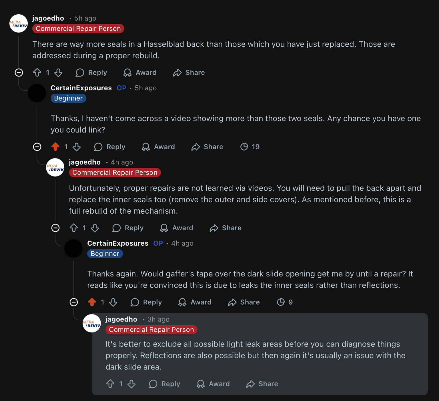

Someone on Reddit claims there are additional light seals that could require replacement. I have not run into information about these additional light seals yet. Do any of you have information about them?

Test frame with a light leak circled in yellow:

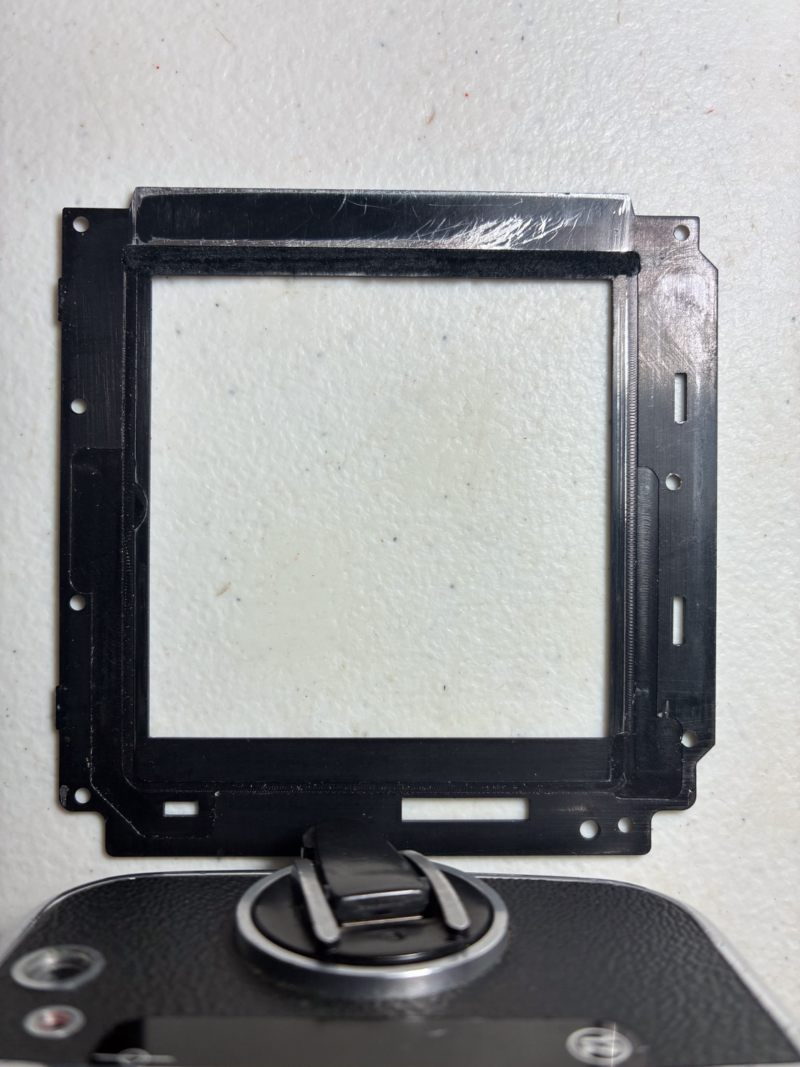

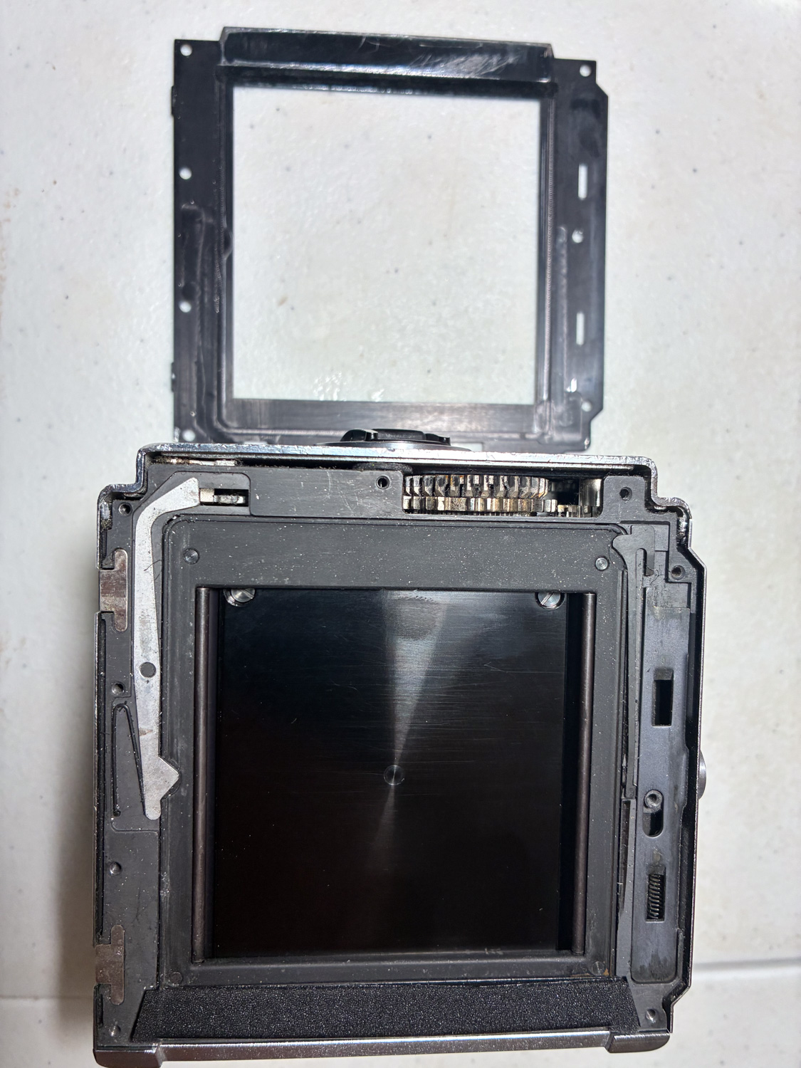

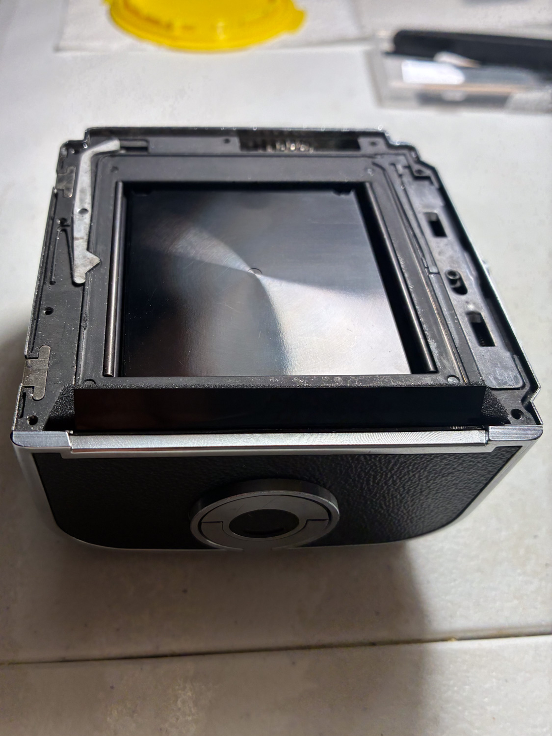

Pictures of my light seal replacement job:
Suggestion that there are inner seals that could require replacement:

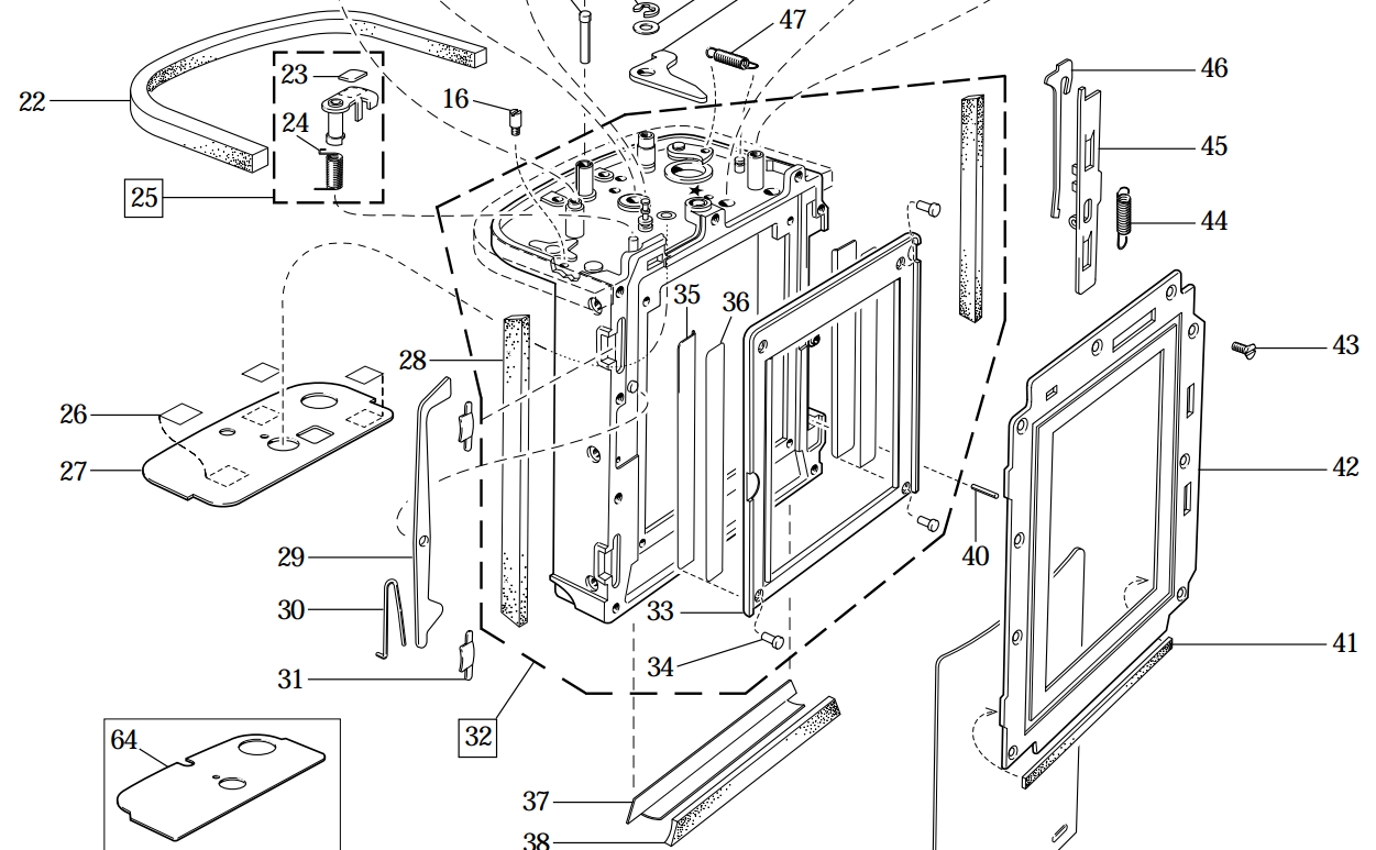

22, 25, 28, 35 are also light seals. Did you replace 41? You have the foam sitting in 37? The light seal at the dark slide is the one that suffers the most, since the slide gets put in and removed. The other seals likely have probably fossilized, but they're also possibly still doing their job if the back has never been taken apart. The light leak you have looks like it's coming from the dark slide. The slot 41 fits into needs to be cleaned out completely before replacing it, or it can get caught by the dark slide and pushed out. And you fit the foam into 37, right?

I had a similar light leak on my back. It's not caused by the dark slide seals but most likely by the seals no. 28 outlined by @Don_ih. I think I changed 22 as well. No tutorials online but it wasn't very difficult.

Yes, I replaced 41. The foam is sitting in 37. I included pictures of both underneath the test frame. The thumbnails might be a bit hard to see unless you click on them. Once you click they should expand. 41 is no more than a millimeter shorter than the cavity (click the middle picture). Could that be the cause?
I took those images above of the replaced seals after I tested them and still noticed a leak.

If I'm not mistaken, the leak tends to appear on the opposite side of the problem seal. If that's true then the orientation would suggest that 28 is the culprit.
