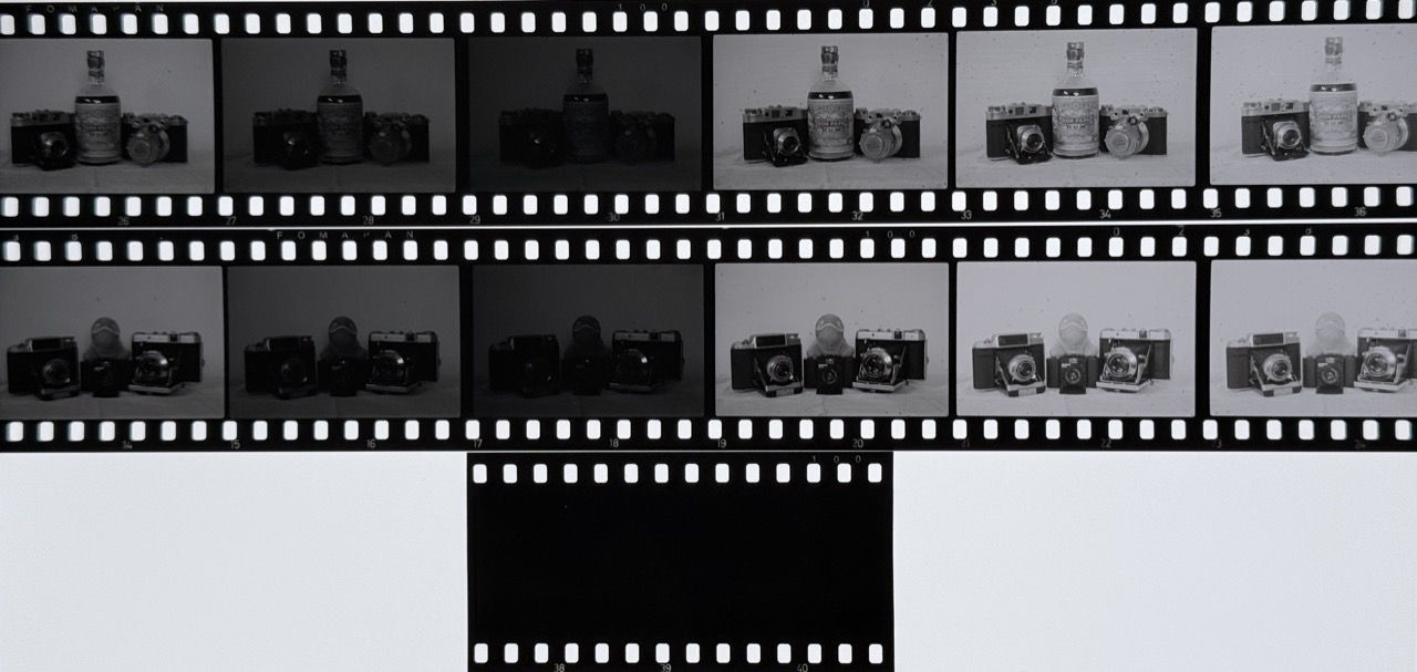

What did I do wrong with this B&W reversal?

Film was Rollei Retro 400
Process:
1. D76 1+1 for 35 mins
2. 250mL 3% hydrogen peroxide + 15mL White vinegar bleach for 7 minutes
3. Reexposure using a strong LED flashlight. Probably 3 passes over the length of film that took 30-45 seconds each. Holding the flashlight an inch or so away from the film.
4. D76 1+1 for 18 minutes (new chemistry).
Ignoring the minor uneven developing issues why did the positives come out so god damn dark? I feel like I over exposed the image on the reexposure after the bleaching. Maybe I should’ve held the flashlight further away and exposed it for less time. I got worried since so many people I’ve seen do this had problems with UNDER exposing during this step.
I developed for so long to ensure any exposed silver got developed, and then during the second development I followed the standard time for Rollei retro 400s.
Next time around I want to shoot the film at 75-100 ISO, develop like it was shot at 200ISO, and give it less light exposure but I want to make sure that is what I did wrong
looks to me that the main issues is incomplete bleach (very dark image despite long fist development plus solarisation).
I never used a hydrogen peroxide/vinegar bleach, I suspect it's not a vry reliable way of bleaching for reversal.
the other things hat look possibly problematic to me is using D-76 1+1 will give low contrast slides on normal film, the first developer time looks very long to me, and a flashlight on short distance seems more prone to unevenness than a larger light from further distance.
Bingo.
Try a regular B&W bleach using permanganage or dichromate.
I thought LEDs were not a good light source (something to do with the spectral output?)
The peroxide bleach has worked fine when I've used it.
not sure where this claim started, but I used LED film lights for re-exposure many times and never had problems.
thinking of it this way:
If LEDs wouldn't work properly for re-exposure, they wouldn't work proprly for the first camera exposure to start with, yet we all took plenty of photographs under LED lighting.
As said I have no experience with that bleach, but in the case above if it worked fine, then it would have bleached away the silver from the first exposure, thus there is no way the negative could be as dense (unless it was massively underexposed). bleach failure is pretty much the only explanation for the strange greenish color cast and and strange solarisation though.
getting good reversal results is challenging enough with a good bleach, so why use something experimental? Dichromate is pretty fool proof but has serious health and environment risks. So permanganate is the next best thing.
As others have advised, use a proven bleach like Dichromate/Permanganate and a stronger first developer. Reversal processing is unfortunately a long and laborious process and there is no need to make it more painful by using suboptimal choices for bleach and first developer. If D-76 is all you have currently with you, you can make it more active by adding some Sodium Carbonate to it. If you search this forum for Hans F. Dietrich you will find an adaptation of D-76 for reversal.
If you're averse to using dichromate/permanganate, there's an alternate bleach
Copper Sulphate bleach works well on a variety of films and merits consideration though it adds additional steps to the process.
Makes perfect sense!

What temperature was the bleach? One of those hydrogen peroxide bleaches need to be used at a higher temperature, 40c I think.
Yes - I think that's absolutely right.
Just to demonstrate the effect dokko mentioned:
I agree.
As for the developer: When I started reversal process I got the advice to use a strong first developer, back then it was Tetenal Dokumol which has always worked fine for me.
Today Ilford PQ Universal should work well. As soon as my remaining Dokumol stock is consumed, I think I'll switch over to PQ.
Moreover it's easy to check the bleaching even during the process itself: I use to use permanganate with sulfuric acid.
  • Standard bleaching time: 5 min.
  • After those 5 min. I open the tank and look at the film while keeping the bleaching bath inside the tank. Sure, it differs from one emulsion to another how a bleached film looks like: Fomapan R100 should be bright yellow. Same, as far as I remember, with Rollei Infrared 400 and old (! 2007) Agfapan APX 100. Fomapan 400 is light grey. Similar with Kodak Tri-X Pan.
  • There should not be any dark brown areas left on the film. These indicate that bleaching has not yet been finished.
  • If I see those dark brown areas I continue bleaching for 3 or 4 minutes and check again.
  • If there are still dark brown areas I set up a new bleaching bath and bleach for another 3-5 minutes.

D76 gives too low contrast, although 35 minutes should (?) pump the contrast.
Still i have never seen D76 used as first developer for reversal. Get Dektol or paper developer to pump up the contrast.
3% (10 volume) H2O2 is very weak. 7 minutes will not be enough at all to bleach. I think here is the biggest mistake and sadly i haven't found a reliable guideline on this part, but when I tried 30 volume H2O2 to bleach an unexposed silver strip, it seemed to require more than 20 minutes.
Dark is usually not enough bleach and/or not enough first development.

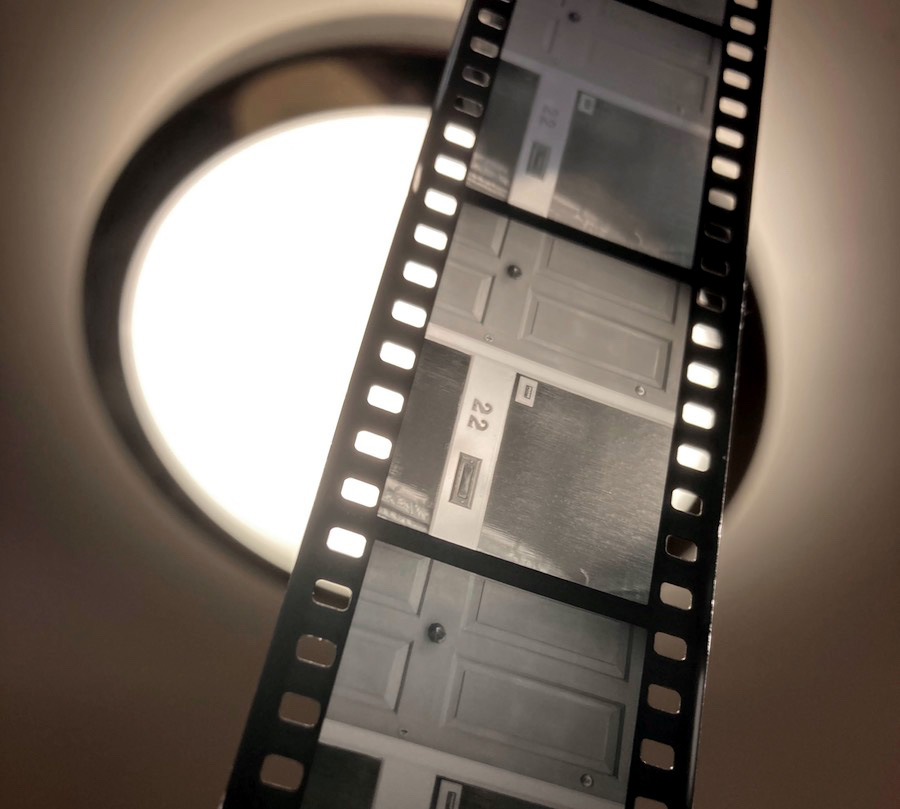

Because we had such a spring-like weekend (gale force winds, rain, low cloud....) I thought I may as well do another reversal experiment. Inside!
Since we were in the clouds, there wasn't much natural light. Wanting to keep the shutter speeds repeatable meant the aperture was a bit wider than ideal for focus, but exposure wise it worked OK (slowest shutter was 1 second). Film was Fomapan 100 shot at 100.
I shot metered (camera + light meter in agreement), 0, -1, -2, +1, +2, +3
1. 1st developer: PC-TEA 1+25 @ 25C (saved for use as 2nd developer) for 15 minutes
2. Rinse a couple of times (bringing temperature up to 30C)
3. Bleach 30 minutes at 30C (350ml hydrogen peroxide plus 21ml white vinegar)
4. Reexposure (on reel)
5. 2nd developer: PC-TEA 1+25 @ 25C (re-used from 1st developer) for 15 minutes
6. Fix (probably not necessary?)
7. Wash
Here's an iPhone shot with the postives on a light box. For scanning, +1 looks best, box speed looked like it should project OK though.
When the weather next co-operates I'll shoot some outside test scenes and try the same process again.

Looks good but man, half an hour in the bleach? This article says that if you run it at 40 it would only Take 10 minutes.
He also says that you can watch after 5 minutes to get a better idea of exact timing.
Yeah, could probably half that (previously I'd done 15 minutes), but since (AIUI) you can't over do it, why not. Not like I was in a rush to get outside.
