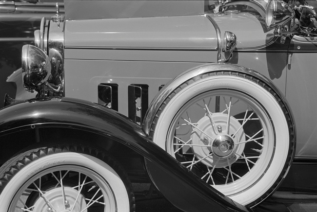

Lee L
Nov 17, 2004
3,281
I've recently tried Efke 25 with Rodinal 1:100 and less agitation. I agitated for the first 45 seconds, then one inversion every 3 minutes for the rest of the development time. (Mine was adjusted from titrisol's suggestion time and temp to about 12 minutes at 74F.)
I posted a shot in this thread:
(there was a url link here which no longer exists) Another car shot, as that was going on in town the day I wanted to shoot real photos to test, and a good test subject with black wheels in shade and bright sun reflections and lots of chrome. EI used was 20, but 25 would have done fine.
You can count the threads in the stitching and in the mesh vent on the lower right, and grain is minimal.
Will post another shot in this thread.
Lee
Lee
Lee:
This is stunning. Is this an enlargement or a contact. What format negative was used?
Thanks.

Lee L
Nov 17, 2004
3,281
mikewhi said:
Lee:
Thanks.
-Mike
MIke,
Thanks. This is 35mm, a negative scan at 2720 dpi on a Canoscan 2710 from a negative that has a gamma of about 0.6. I just did a gamma correction and placed the high and low tones where they should fall, nothing heroic that couldn't be done easily in the darkroom. Also reduced it from 3808 x 2556 to 650 x n. Haven't had time to print it yet, as I've been too busy in the intervening week. It was too crowded to shoot entire cars, so I just decided to shoot details with a 75 Color Skopar on an R3A that day, and got a huge percentage of shots I liked.
This film/developer combo reminds me of Panatomic-X and Rodinal 1:100. I had a shot with that combo done at 11x14 (from 35mm) and the professor reviewing my portfolio for entry into an art dept photo class kept going back to it. After he asked me what I used for film, developer, and camera, he just kept staring at it hard and scanning it for detail for 5 minutes. Didn't end up taking the class, as I quit grad school and got into studio work a week or two later. That was 1981.
Lee
