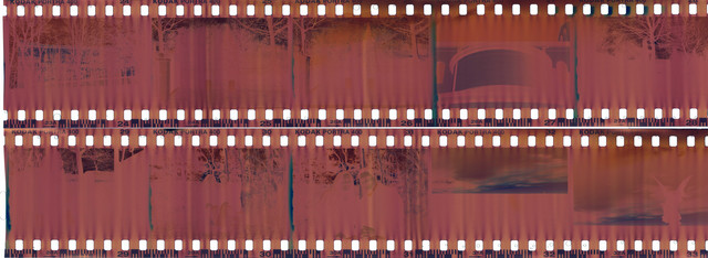

Did some color negative developing this past weekend and had one roll come out with some problems I've never seen before. Don't think it is the chemicals, because I did a couple of rolls after this that seem fine.
This is from a 36-exposure roll of Portra 400. And this is essentially the tail end of the roll... interestingly, the first dozen or so frames, while exhibiting some issues, are at least salvageable whereas these are not. I can't determine if this is because of: Light leaks? X-rays? Problem with film in canister? Problem with film in camera? Overdeveloped?
I should also mention that I personally did not shoot these shots; they were shot by a friend of mine to whom I lent a camera (Minolta XG-7) and said I'd develop/scan the film for him.
First shot is a photo of two strips of the negatives:

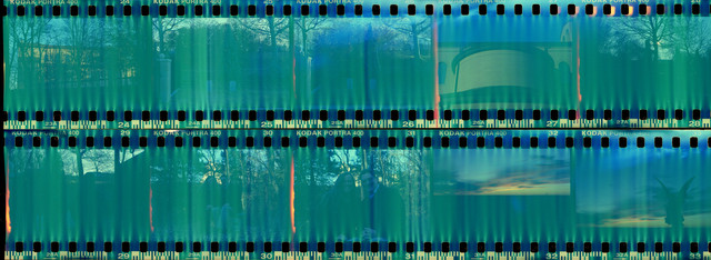

Second shot is the above photo after being inverted and adjusting levels... notice the vertical flares extending about the sprocket holes... to me this is a clue, but I can't figure out what could have caused it.
This looks like a light leak to me. Perhaps degraded seals? The mostly monochromatic nature is a bit odd, but could be explained by the conditions the camera was kept in, filtering specific wavelengths (e.g. a red carrying bag).
I was thinking that if the first shots were less affected, it could be because they were being wound (and protected) on the winding spool, and that whatever did this had to have occurred later in the shooting (as I didn't shoot these, I don't know how long it was between shots or how long from the first frames to the last frames). But the sprocket flare is what has me scratching my head; if it were light leaks, wouldn't it be more uniform across the film plane? Also, I'll have to check my records, but I think the seals were replaced in this camera within the last year or two, so not that old.
Nice puzzle! The end of the film would have been towards the inner part of the cassette, but the outer part of the spiral in the tank. I suppose it would also have been outwards on the take-up spool in the camera, so would have had the worst of it if the back was opened inadvertently - but I’ve done that a few times, and this doesn’t really look like that kind of accident to me. If it is an auto-rewind camera (?) that would be irrelevant anyway. And the sprocket holes would not be aligned when the film was tightly wound in the cassette or on the take-up spool, so it seems unlikely you’d get such an even effect. Weird too how those red streaks appear to be evenly spaced but not consistently present.
In a color negative film, orange streaks of the color of the vertical lines in the positive image suggest a light leak through the back of the film.
Many cameras wind the film inside out on the takeup spool, so a light leak somewhere in the back may expose through the back while in the film gate, and through the front while on the spool.
Perhaps the film was exposed to light (insufficiently closed back?) while wound on the spool and that's why there is streaking around the sprocket holes. Kind of reaching here as I'm not sure it's one single leak causing all the phenomena.
I've seen this when the film was wound 'backwards' into the cassette, turning the rewind knob counterclockwise instead of clockwise. If you search 'film stress marks' it looks exactly like your sample.
I second the "rewound backwards" hypothesis.
Ex-photolab guy here, I've seen that a lot.
The "rewound backwards" hypothesis may be it. I did notice that the film appeared to be "bent" a few inches behind the leader (approximately on the second or third frame), but wouldn't that mean that first few frames would have been the worst, as opposed to the end ones?
sharper bend when the size of the roll os Smaller near the core of the spool. Yes, I would go also with the wound backwards theory. Does the film have any wrinkles or does it lay flat.
I was thinking of light piping.
But if the 'rewound backwards' pattern is a better match, I'd look into that. I've never seen it myself, but I can sort of imagine how it might work.
I agree with @Dirb9 and @AnselMortensen . (I am also ex photo lab)
The stress marks have caused the marks to come from the sprocket holes.
There also appears to be a light leak at regular intervals, which would suggest a light leak in the film cassette or camera.
To my eyes, the film looks underexposed and slightly underdeveloped.
Well... looks like mystery has been solved. Thanks for all the help!
Interesting - I haven't ever done or seen this myself. I suppose that the stress marks come from pulling the film over a corner, causing it to buckle at the sprocket holes. Guessing that it happens as the film is pulled over the inside of the cassette lip?
All you have to do is to rewind the film the other way. On most cameras, you would rewind the film clockwise. Instead, rewind it anti clockwise. Develop the film and admire your results. 😎
